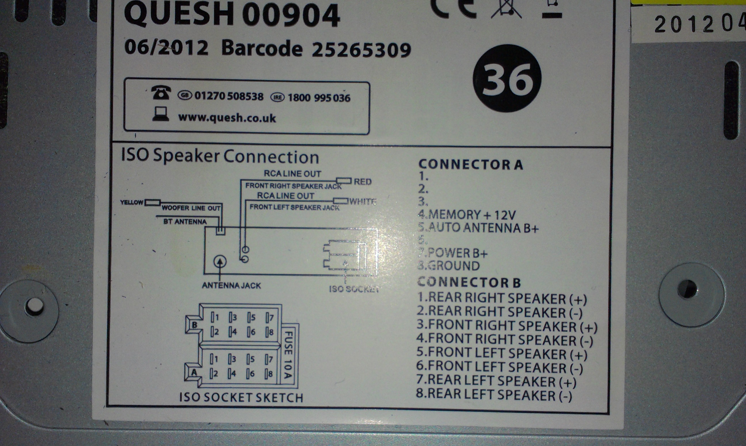

Thanks for reply.I also have nice car radio mp3 unit with a lot of functions from aldi,but the problem was the unit making my battery completly flat.Is there any solutions like special wiring iso kit for aftermarket radio units for fiat puntos?

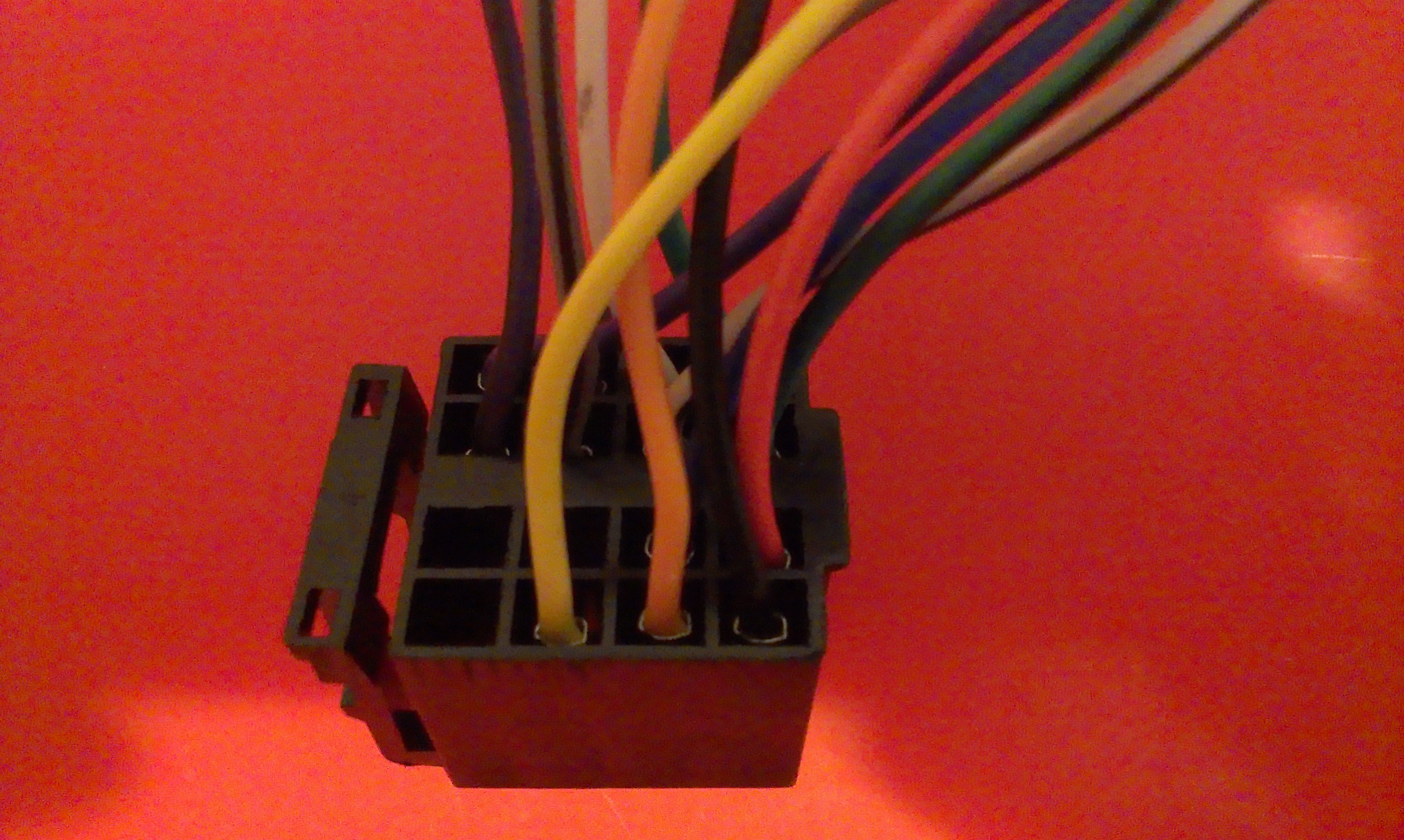

Don't connect both the red and the yellow wires to the live ;) (one needs to be switched)
So I can just cut yellow,or red wire from live?Which one is the best to cut and is this will keep memory in unit as well?
One is permanant live and the other is switched live (stereo manual will tell you which is which) the switched live powers the unit and the permanant live powers the memory.
You are really helpfull guys:)I make a photo of my unit and iso.
Can You now tell which wire just cut off?What I want,I need to make this unit to not flatting my battery when car is not in use and also I need to keep memory on unit like radio stations and sound settings etc.Thanks again very much.

Good morning all.So how I should solve the problem now?Mayby I can cut the red wire and connect it to yellow all together?
I know I need to keep yellow where it is for keep memory but where to connect red wire?
