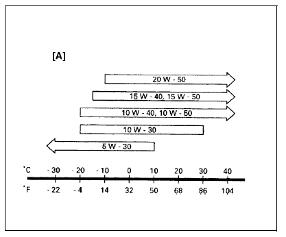

edit: I know everything I you generally see regarding fiat FIREs says 10W40 but not all manufacturers are like that, my Suzuki has this chart instead in the workshop manual
Now among Suzuki people they all are adamant you have to use 10w30 in uk climate or you'll damage it, but looking at the chart you can clearly see 10w40 or even 10w50 would be fine. I use fully synth 10w40 in my Suzuki and have done for about 20k miles, totally fine.
Now coming back to the original question of this thread, much like the Suzuki, Fiat says you should use 10w40 (if you wanna get really specific they say tutela zc 75 synth, which is a fully synthetic 10w40). And everyone always states categorically you should use 10w40. But if you refer to the actual Fiat Technical Manual it also states, "For temperatures below -20°C it is advisable to use Selenia Performer 5w30" (this is also a fully synthetic oil).
So, like jimbob, I am also a change oil twice a year person, so my advice for the best protection would be around when it starts getting cold do an oil and filter change and cinsider using 5w30 (assuming your given temperature figures are in °C) and then when it start warming up again in spring do another oil and filter change using 10w40.
