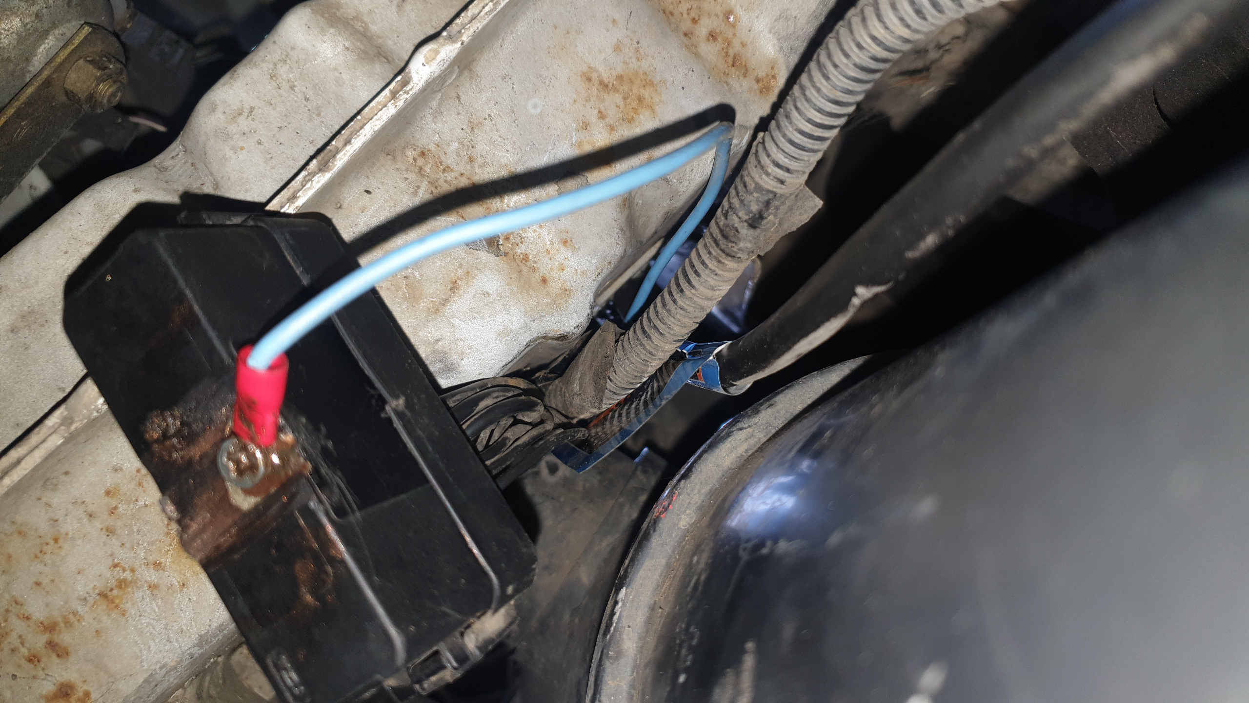

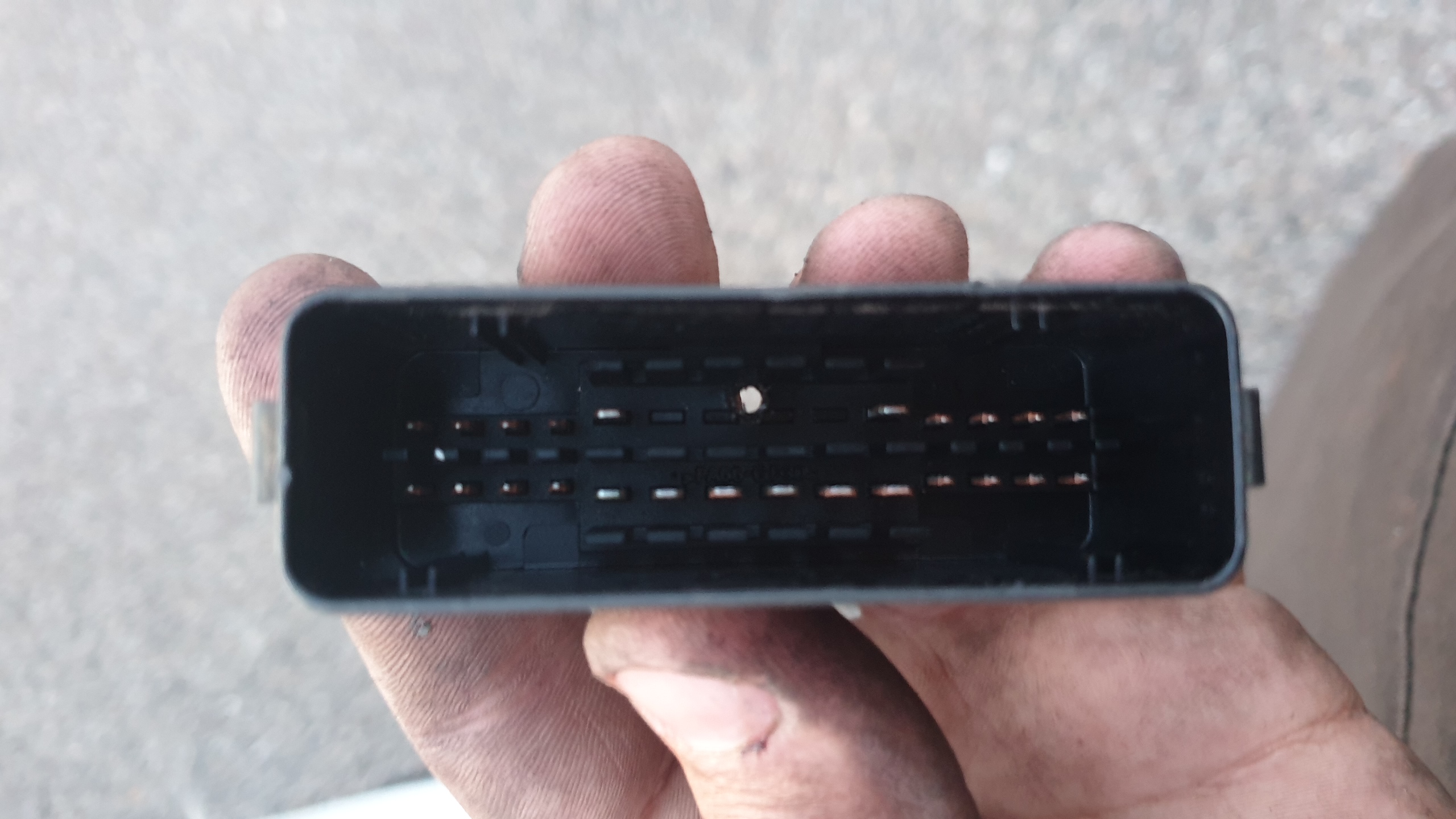

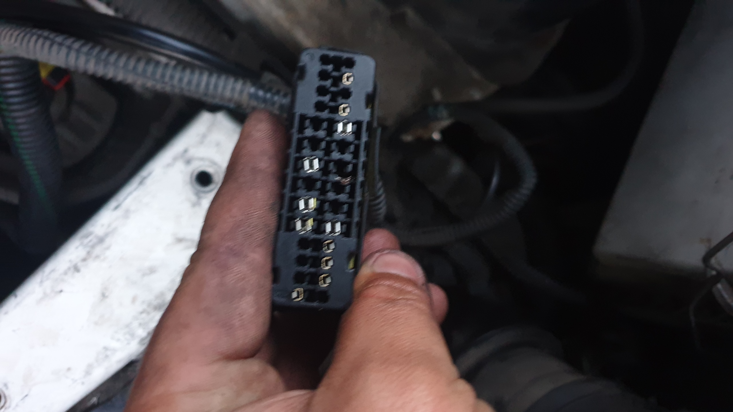

Just as a side note. I found this little earth box last night that has snapped off its original mount, and someone had previously put a wire in it to the negative terminal, so I replaced the wire and mounted to the battery and then tried on frame but it made no difference, unless the wire it needs has to be bigger etc so any advice on that would be great
