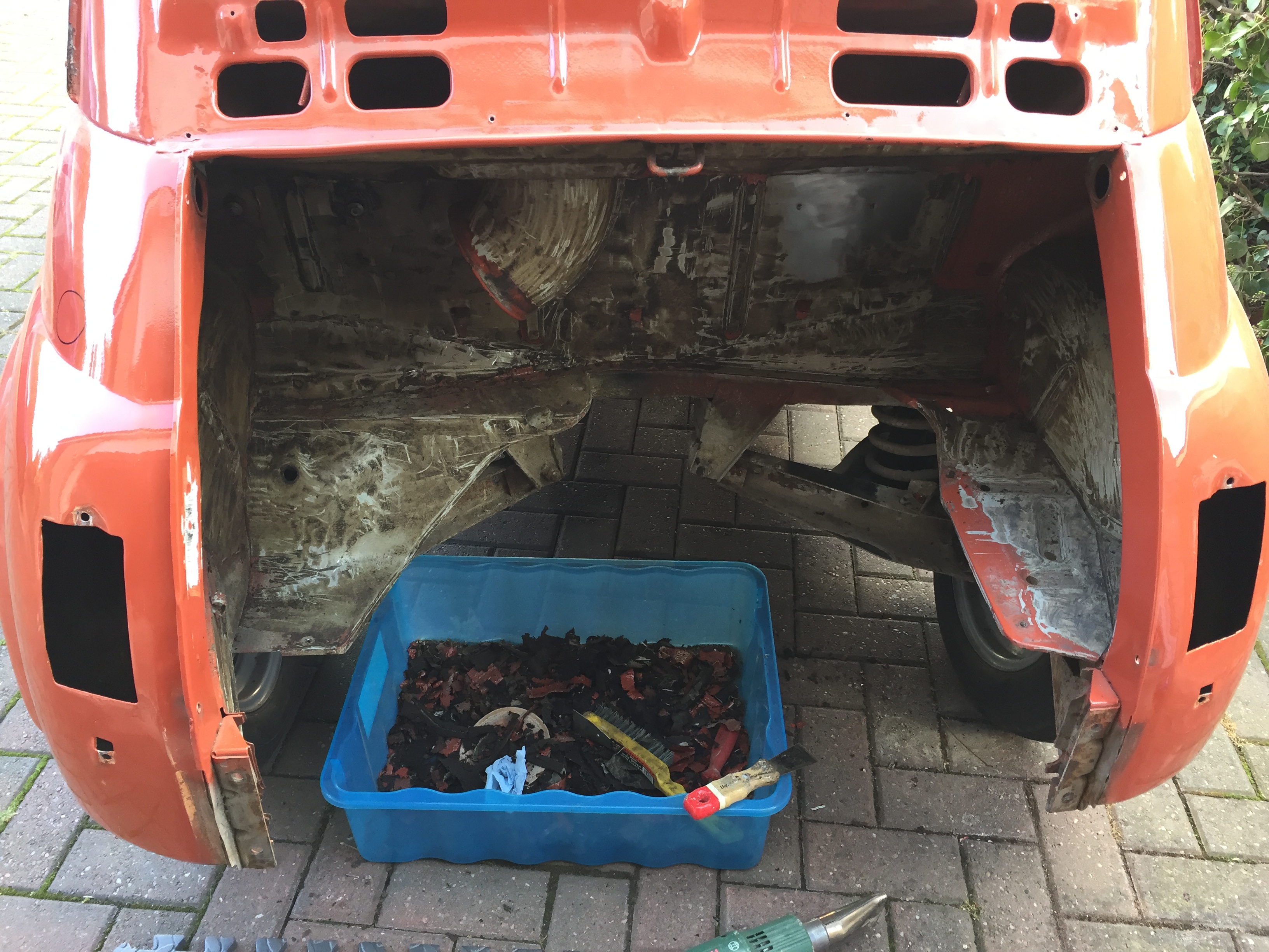

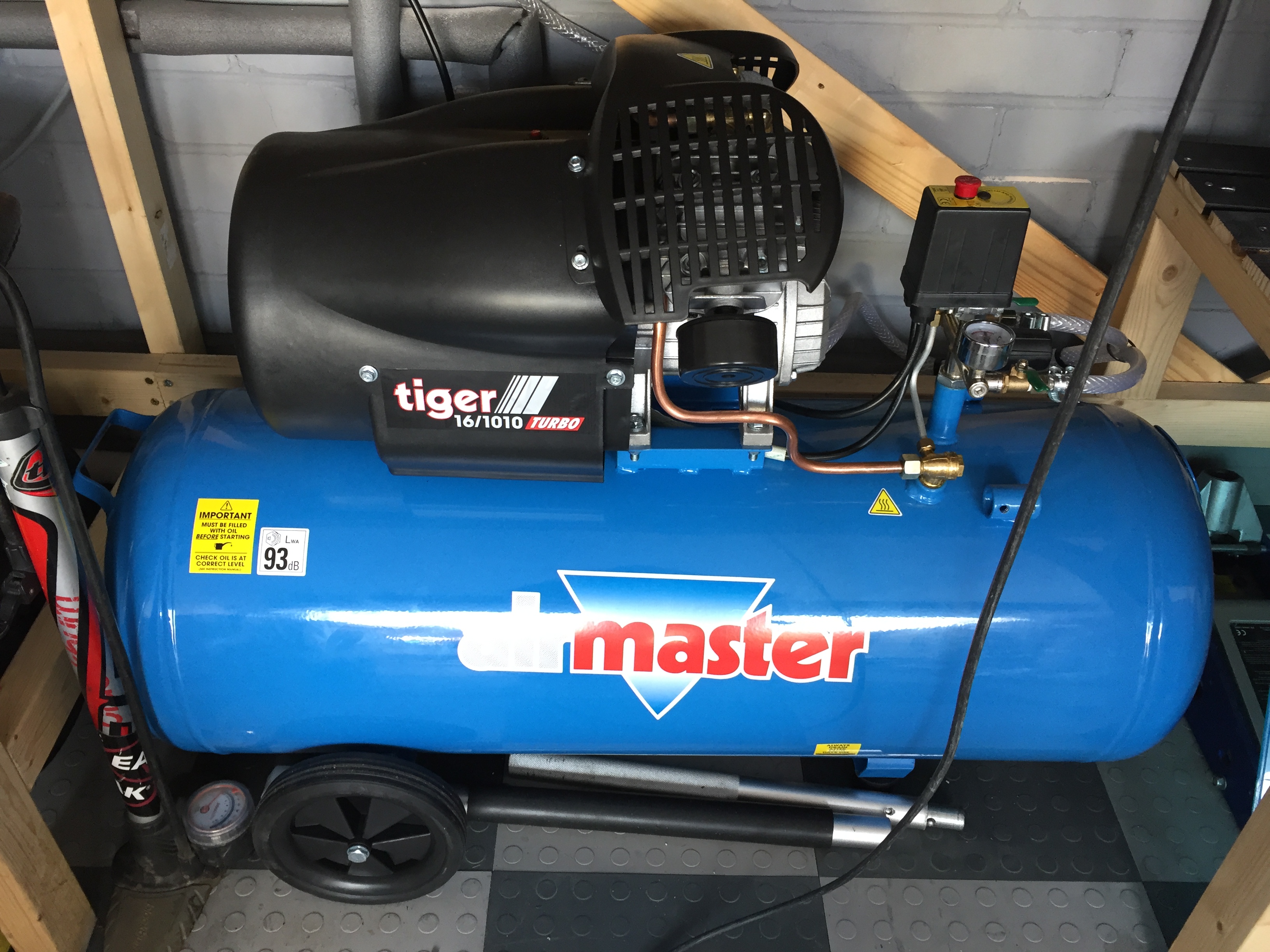

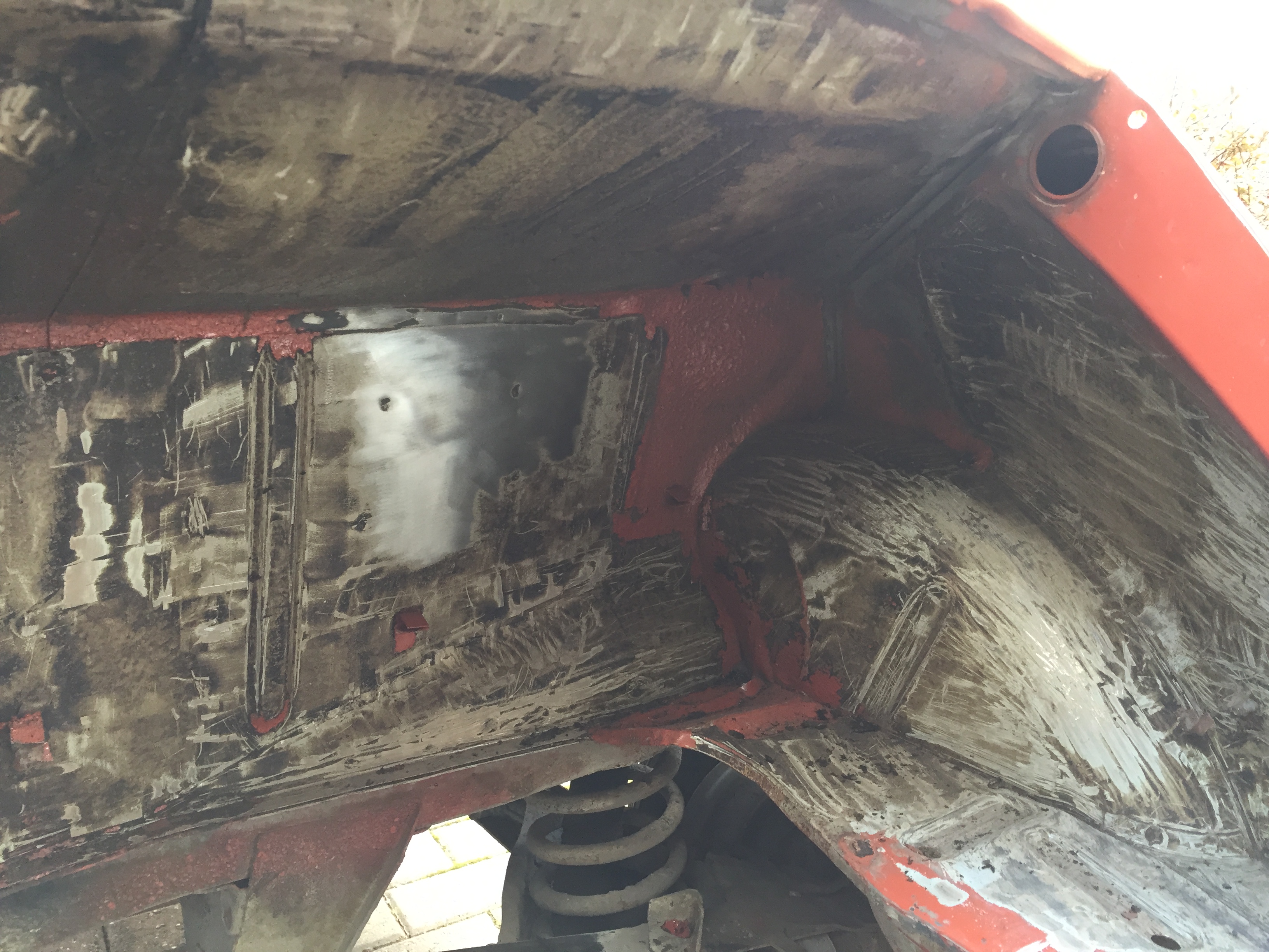

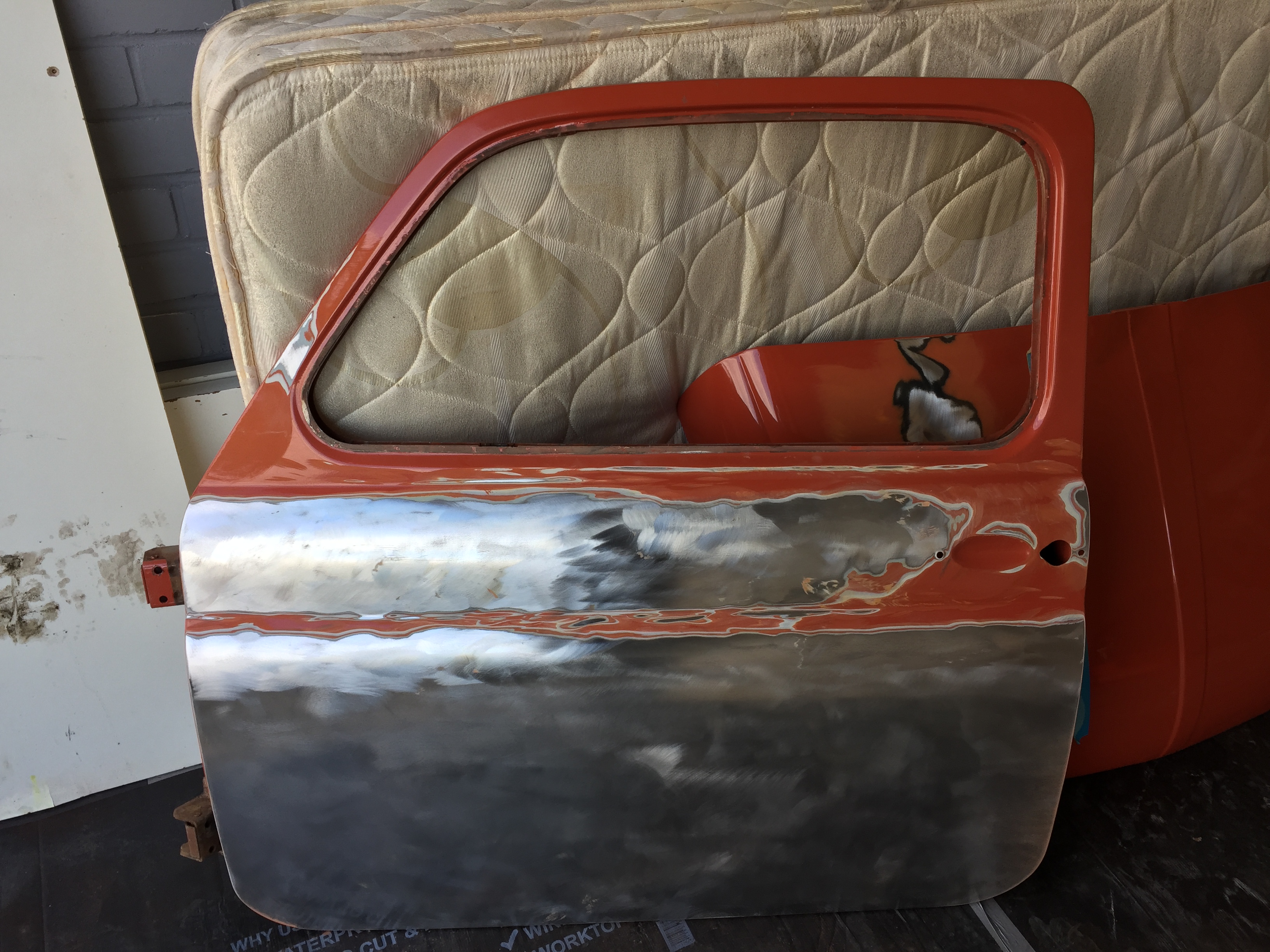

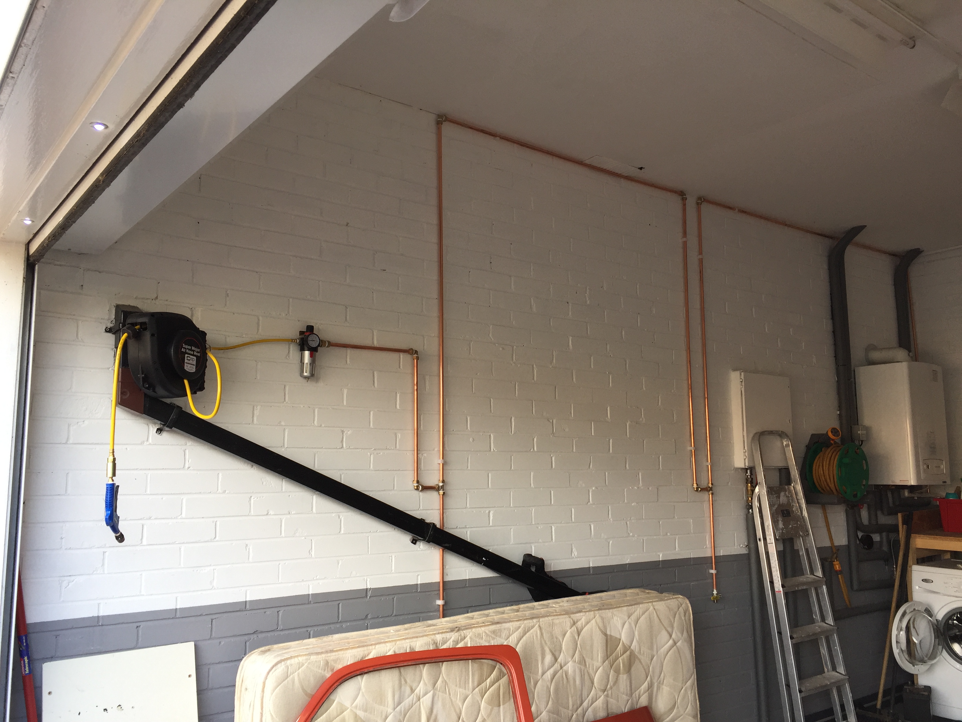

A little update...I haven't done much since November. Mainly concentrating on stripping paint and underseal at the moment and installing a new airline set up for tools and spraying (when I eventually get to that stage!) Here are a few pics. I will find a better way of doing this soon as I have so many! Maybe an instagram account or something.
Katie
Heat gun works a treat :)
Many layers, looks like a gobstopper!
I find these bits quite satisfying. Looking good underneath all the sealant so far...

I've taken a high res copy of this in the hope of getting it printed and put back on

Air line including moisture traps
