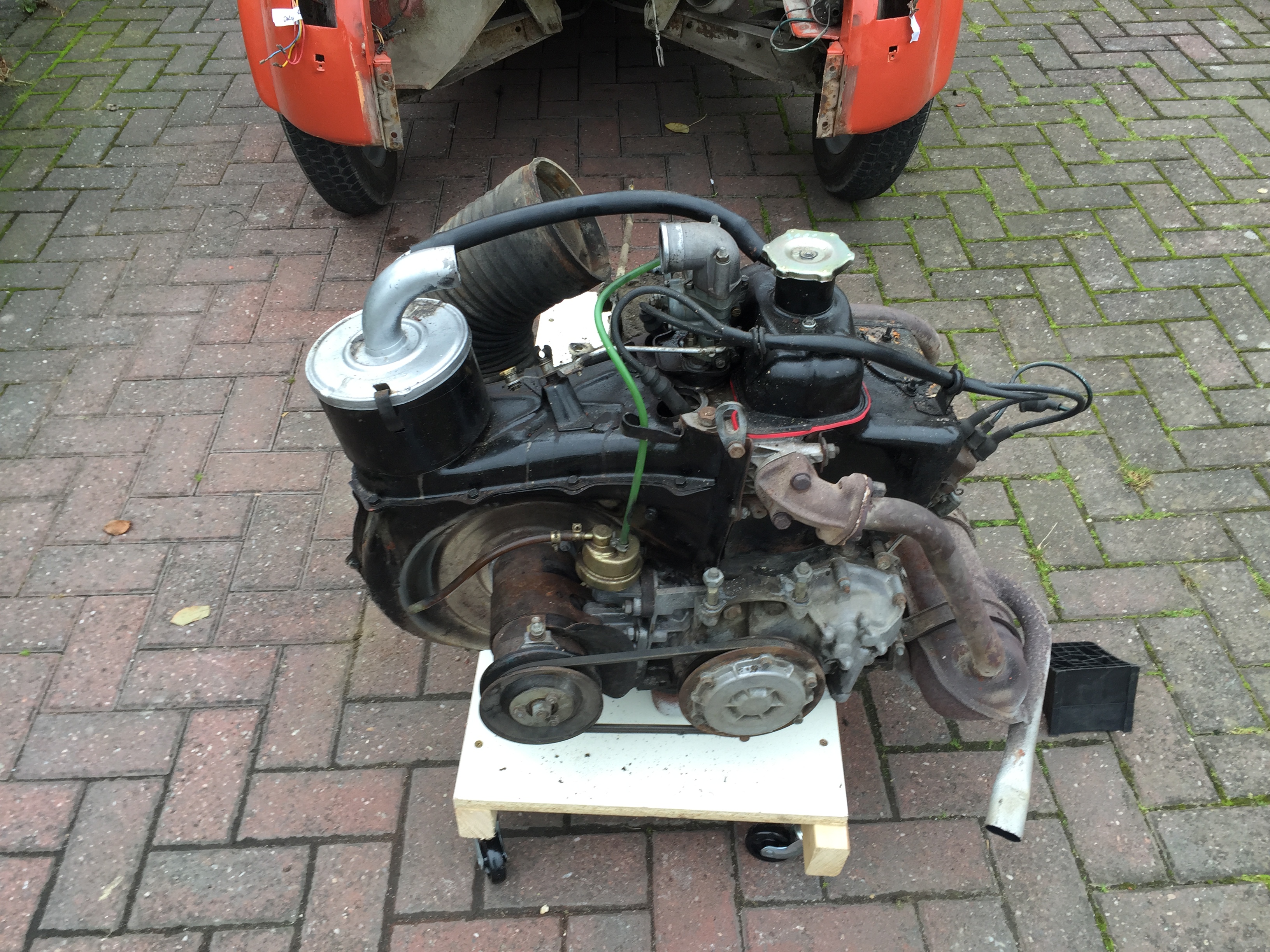

I want to put a 126 engine and box in and will need the space in the garage so need it gone as soon poss.
Hi ya - remember that the driveshafts are too long from a 126 and that your replacement engine may have some ancillaries missing... if possible buy one before selling the old....there's not a strong demand for 500 power trains
Thanks Andrew. The new engine comes with driveshafts to fit but it's a good point. Maybe I should hang on to it before the new one arrives.

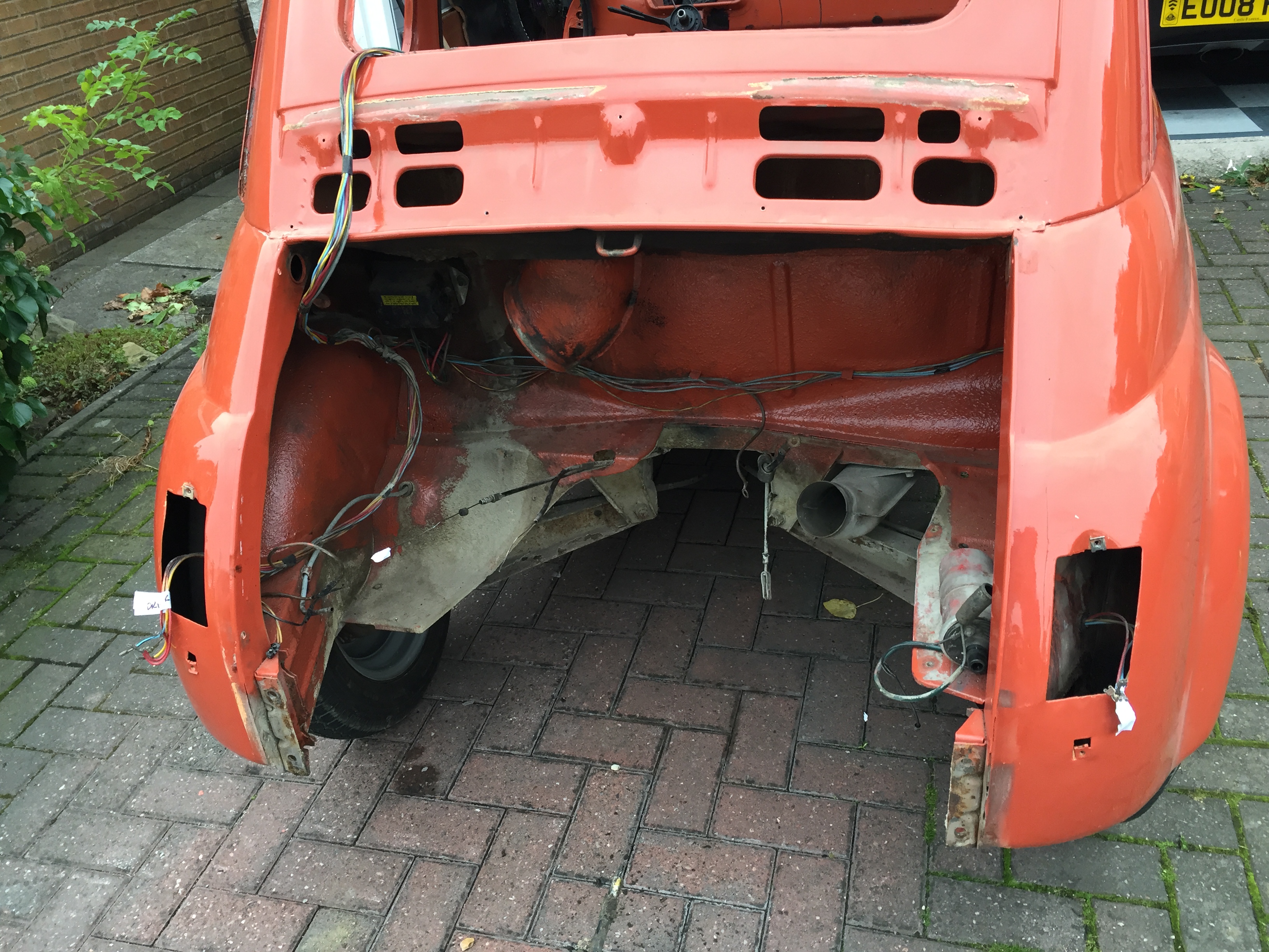

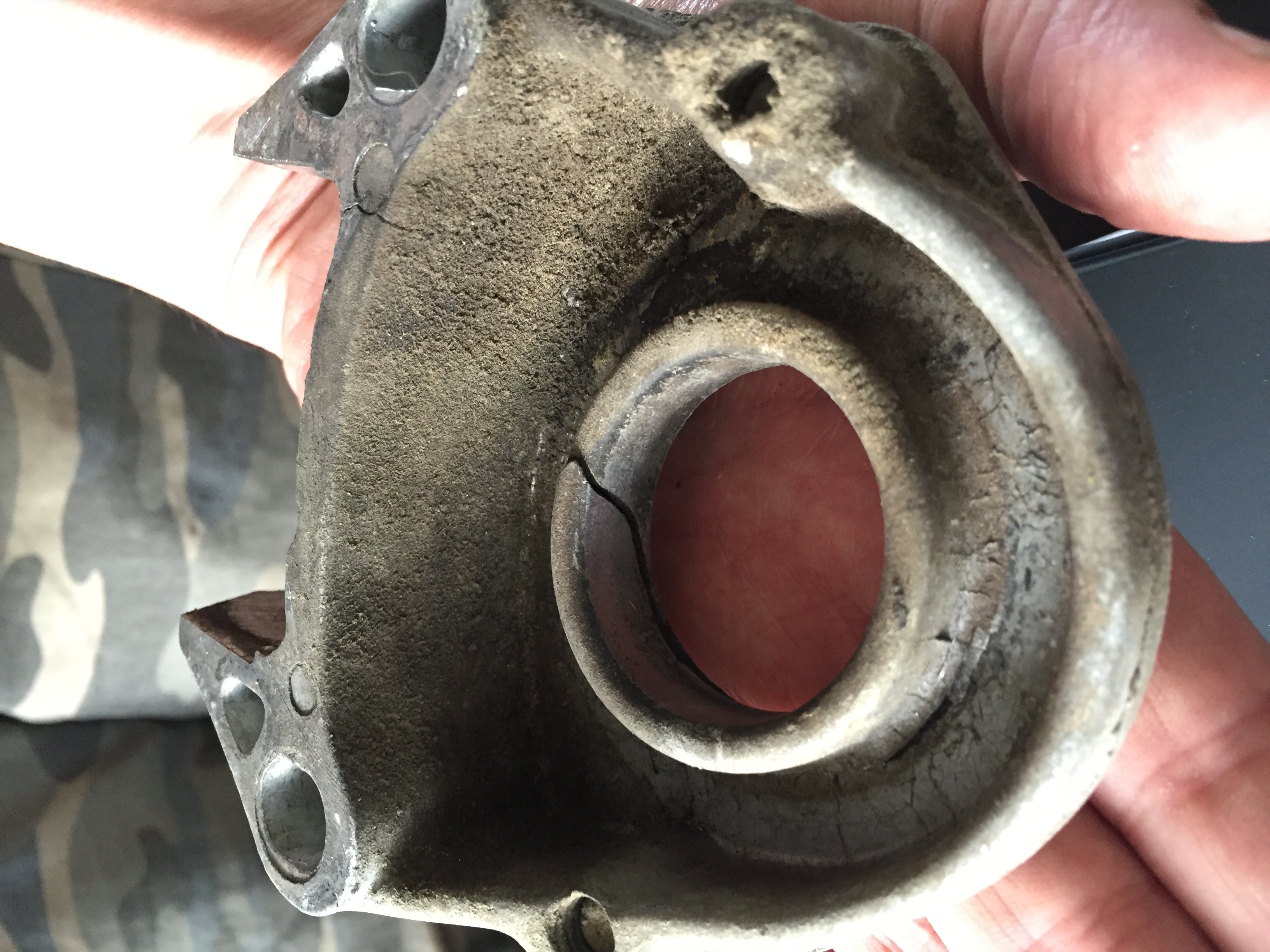

Engine removal went pretty well. I think the hardest part was freeing the throttle cable from the bracket with the split pin. It required 3 hands and a mirror! Also found that the rear engine mount was cracked where the spring attaches. Lots of bolts and cables need replacing but that was to be expected

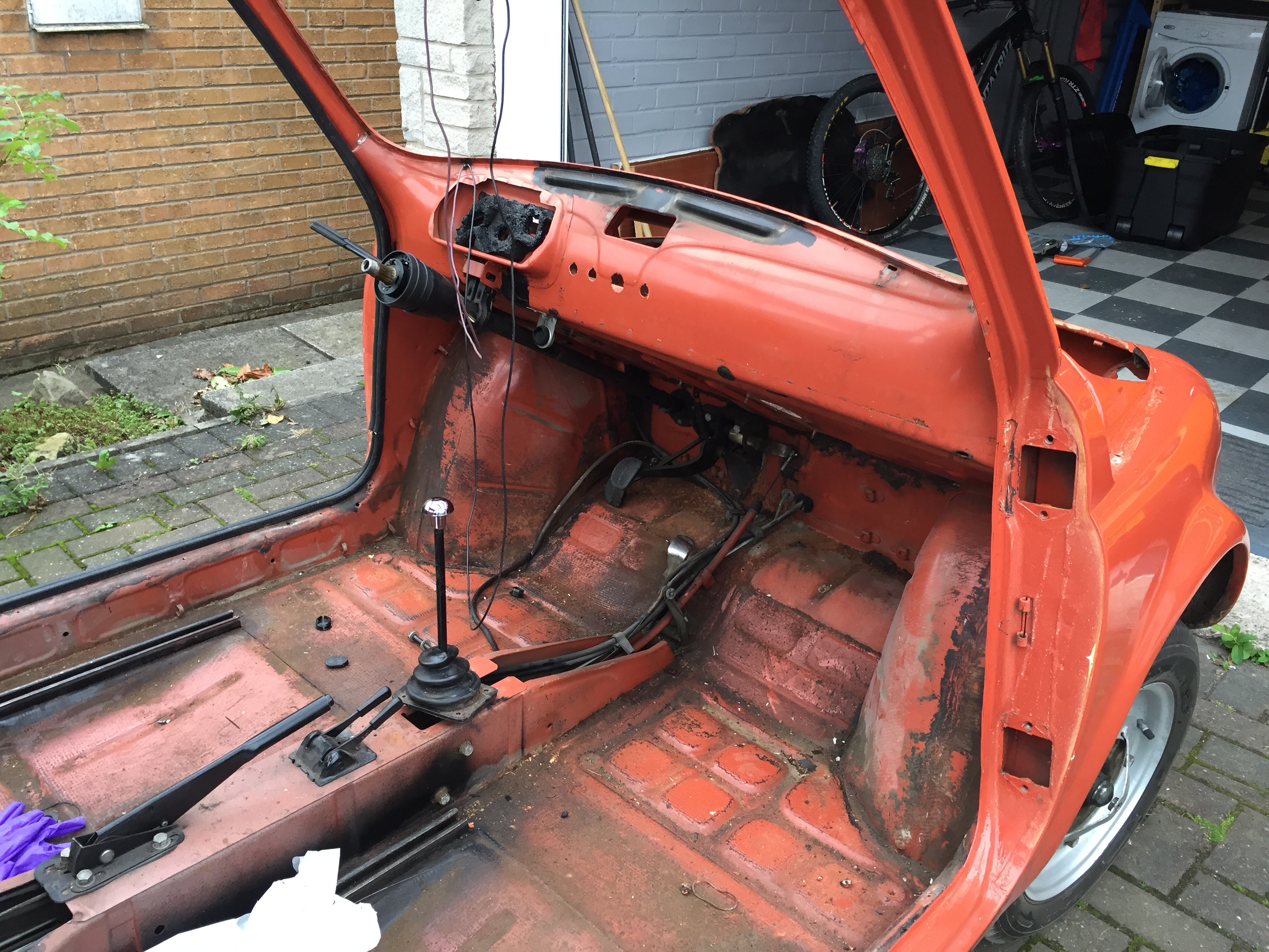

So what's your plan? Same colour ? Standard looking car ?
The plan is to make it look like it just came out of the factory. It will be standard besides a 125 engine and gearbox and maybe a few subtle little tweaks.
I'm changing the colour but haven't decided which to go for but I'd like to stick with an original fiat 500 colour.
I'm hoping that my other half and I can do all the work ourselves but neither of us have restored a car before so that will probably depend on what we find under the paint.

Started to clean up the boot and remove the seam sealant to check the condition of the panels. Looks good so far. Also started to remove the sealant and sound matting on the flooring.
