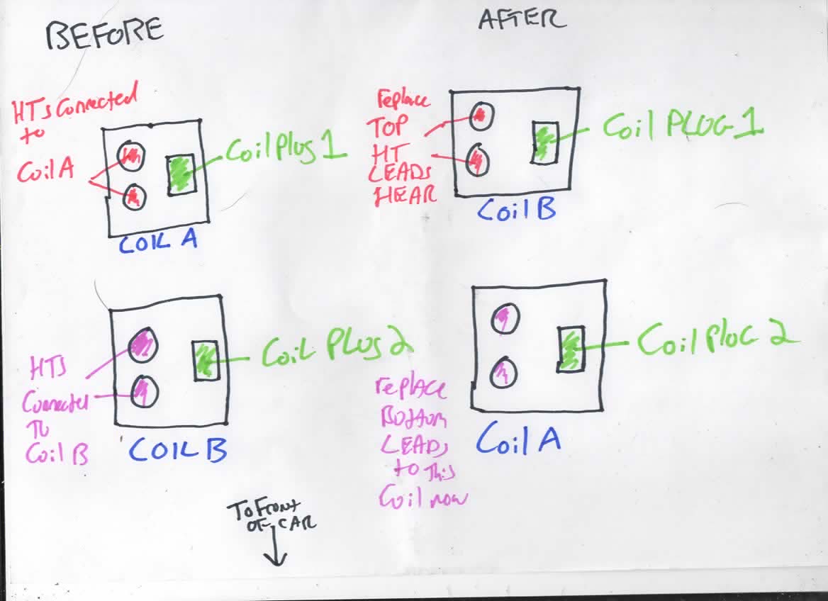

Swap coils over and see if fault moves
yes move coils over
If the fault code re-occours the same - coil B when infact it was Coil A in coil B's spot
it could be a failing ECU, or a wiring fault
If the fault code moves to Coil A - Then its a dying coil

Ok will try that, but swap the connectors over or physically move them over?
Physically swap them or the ignition timing will be out,
you will need to remove the ht leads from the each coil and the connector off each, then swap the coils over so A is B and B is A then reconnect the wires but on the
I'll quickly draw a diagram and upload for you
Im not sure how long the ht leads are just to swap the ht leads and connectors over, some of the leads can be very short

Ok so i swapped the packs over and sure enough im now getting code p0351. Going replace both coils and all leads while im at it.
So the fault moved with the coil pack - its a clear diagnosis of a failed pack

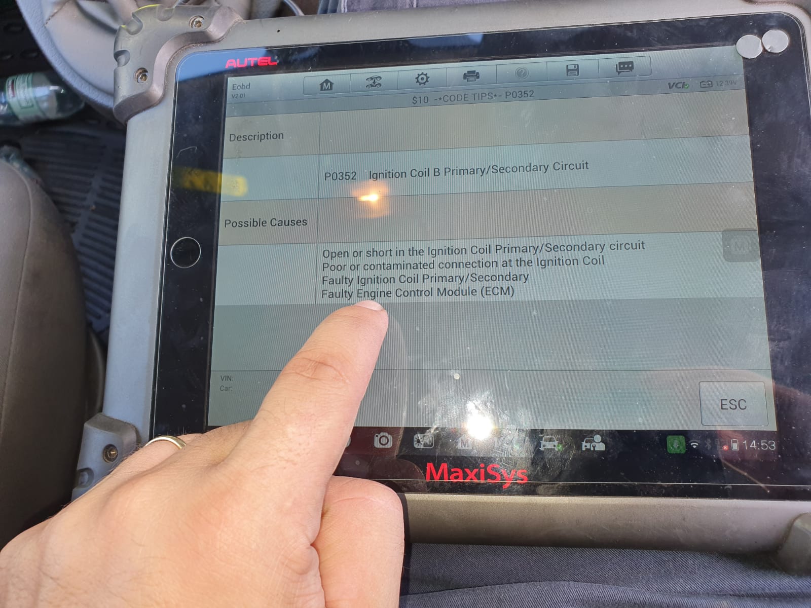

Hello. I have a Fiat Panda since 2008, 1.1 engine, in the UK if for a while the LED was on, check the engine and I haven't given importance but for some time it is only lit, and the car does not accelerate normally and when it is on the spot trembling from all joints plus increased gasoline consumption. I was at the service I changed everything on it, injectors, electric coils, cables but the problem persists. I tried to reset the ECU but nothing, it works ok for 30-40 minutes then it goes crazy. What do you think it could be? I do not mind them at all and as if I would not throw away to change ECU only as the last option. I also attach the picture from the tester as it can help and thanks in advance for the help.
