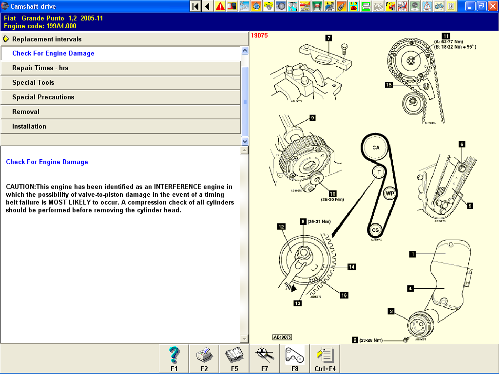

F flisko ` Parked in the garage Written 5 guides Joined Jan 20, 2013 Messages 6,122 Points 1,228 Nov 22, 2014 #1 was hopping around autodata and it shows grande punto 1.2 8v as interference engine on the other hand mk2 1.2 8v engine is non interference so i started to wonder, same valves engine but interference, why fiat? Attachments grandepunto.PNG 102.2 KB · Views: 628
V varesecrazy Patron member Parked in the garage Written 10+ guides Written a review Joined Apr 27, 2011 Messages 36,789 Points 8,377 Location Near the M4 Nov 22, 2014 #2 8V - VVT..?? most modern stuff runs tighter tolerances for better burn / emissions, tight = collision damage ( diesel)
maggers Up to no good somewhere.. Joined May 8, 2013 Messages 831 Points 175 Location Cannock, Staffs. Nov 22, 2014 #3 Bump, the VVT catches the valves.
fingers99 Patron member Parked in the garage Written a guide Joined Mar 20, 2006 Messages 27,743 Points 4,561 Location Liverpool Nov 22, 2014 #4 Pull the head and you'll see why. The very late (Euro4?) engines have different piston and combustion chamber shapes. I'd guess that that -- and maybe the faux VVT -- creates the issue. Mind you, I'd never rely on Autodata!
