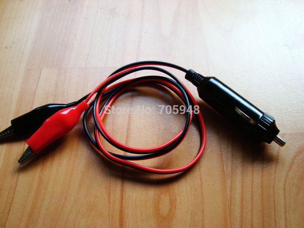

Since you got into the ECU, I assume you use the 3-pin adaptor, and have the crocodile plugs attached to + and - of the car or straight to the battery? (I use a cigarette plug with crocodile plugs to make working inside the cabin easier).

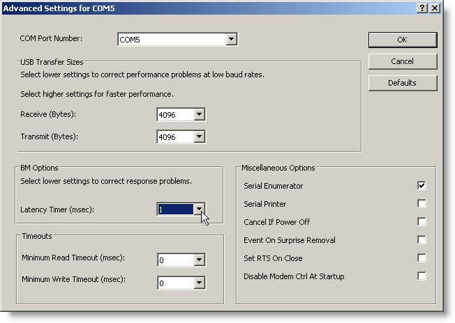

One more thing - if you use this kind of USB cable, it is essential to set the COM port latency to minimum to ensure connection.
Connect the cable to your laptop, go to device manager -> select ports and right click for properties. Select advanced properties, set latency to 1ms, save and close. Remember the number of port COM1...COM4 or change it to your preference. When you use your OBD software, make sure you choose the same port when you select your OBD interface.
I use FiatECUscan and with it I've been able to connect to all of my units with the blue VAGKKL cable, but only with the minimum latency setting.
