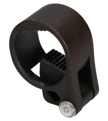

Hello, I'm thinking of changing the inner and outer tie rod ends on my Panda 169 2007, as they are likely to still be the original. Reading other threads I have two questions:
1. I have bought a tie rod remover tools (please see photo). With it, is it possible to remove the inner tie rod from the rack without having to remove the outer tie rod? I'm expecting the lock nut to be completely seized.
2. Other threads have many warnings about being careful undoing the inner track rod end: "you're relying on the 'flat' side of the rack, where the teeth are cut into it, bearing against the pinion to stop the rack rotating in the housing. If you get a really tight one I'd be most reluctant to really lean on it for fear of doing damage to the teeth or even the rack housing"; "the inner rack must not be twisted as you undo these ends", "it’s really easy to twist the gear rack in the housing if it’s on full extension (i.e. on full lock)", etc.
Is there a way to minimise that danger?

Looking at the tool I suspect it will not fit over the track rod end to get to the inner joint.
Can you actually feel wear in the inner joint or is it because you cannot undo the outer?

Tool looks right for the 500 I guess the panda is the same
Take the outer end off, counting the turns
Slide off the bellow
Slide the tool down
Put a couple of extensions on
Ratchet it off
It's protected under the bellows so shouldn't be to tight, there only hand tight plus a bit

Thank you everybody. I haven't checked whether the inner joints are worn, I just thought it may be worth changing them on both sides to avoid problems if the tie rod ends are seized. But you're right bugsymike the tool won't slide over the tie rod ends, I hadn't thought of that! I had already bought the inner tie rods (and new bellows) a few months back but I was only thinking of fitting them now. However, I'm going to follow the advice to leave them alone unless I see they're worn, thank you Pugglt Auld Jock for the explanation on how to check that.
