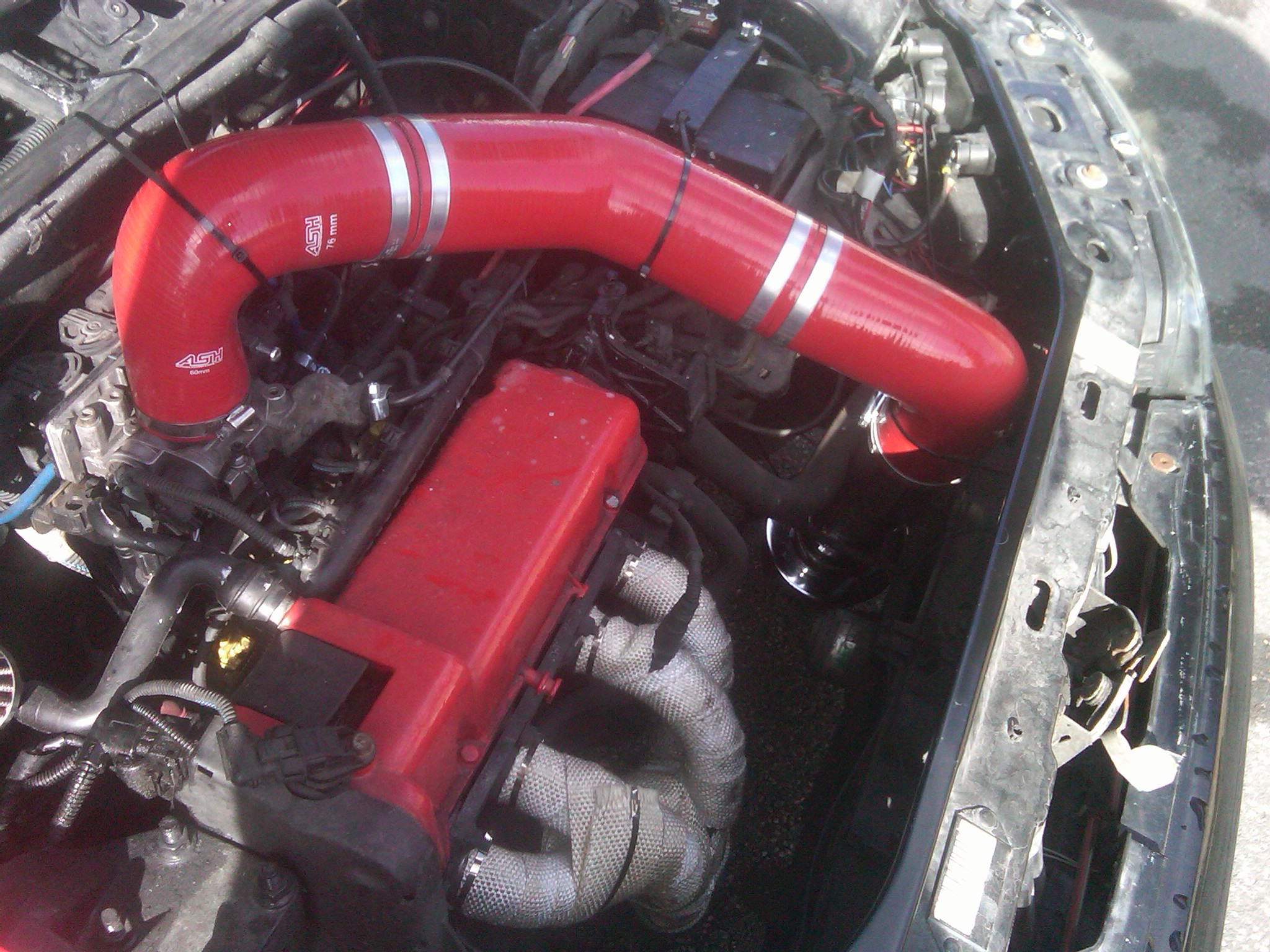

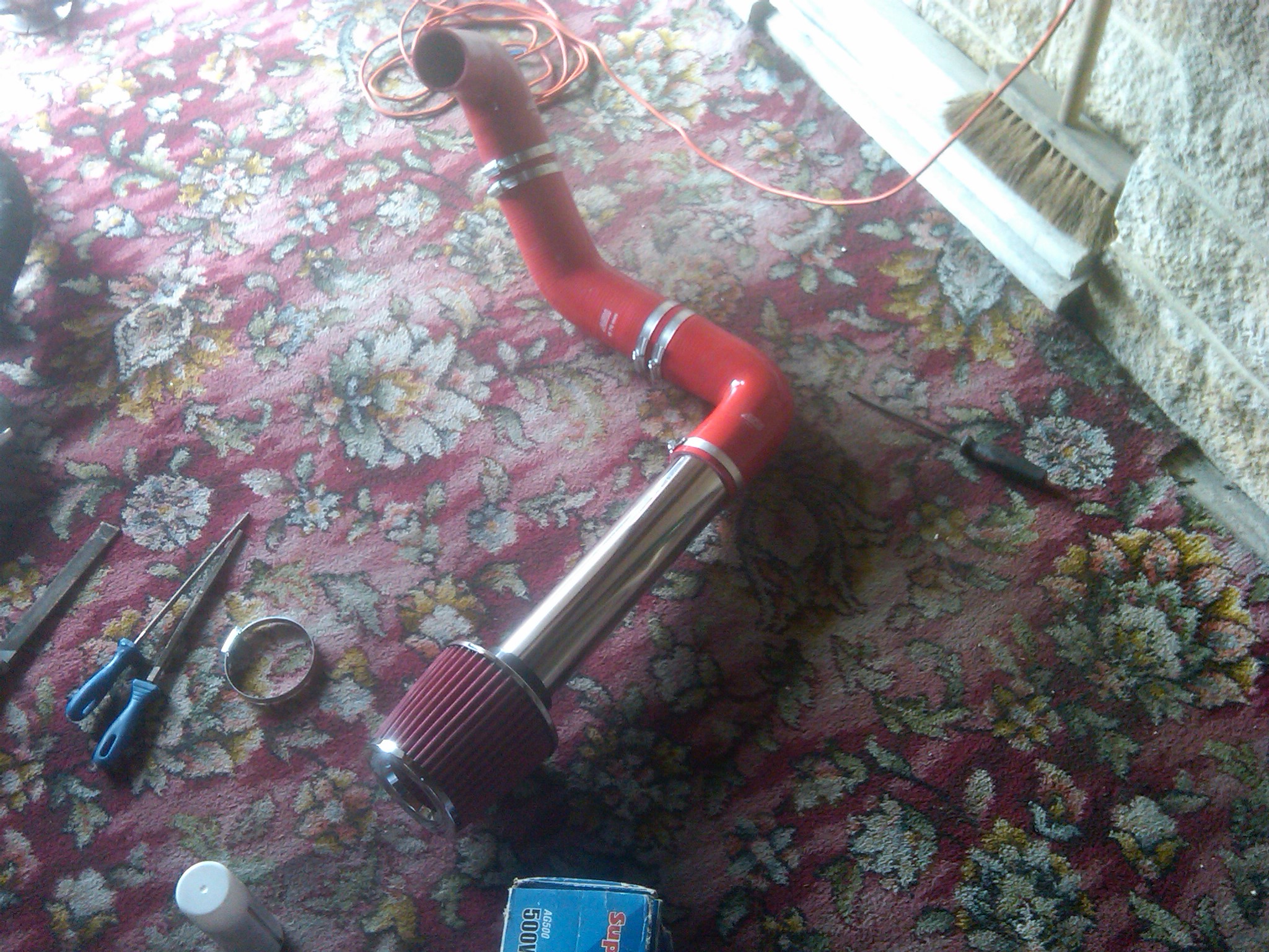

mate just make your own i did only cost around £60 to make...double the price of focus induction but about half of the GSR
just nee silicone bends and stailess steel piping...then bigest air filter you can find :p

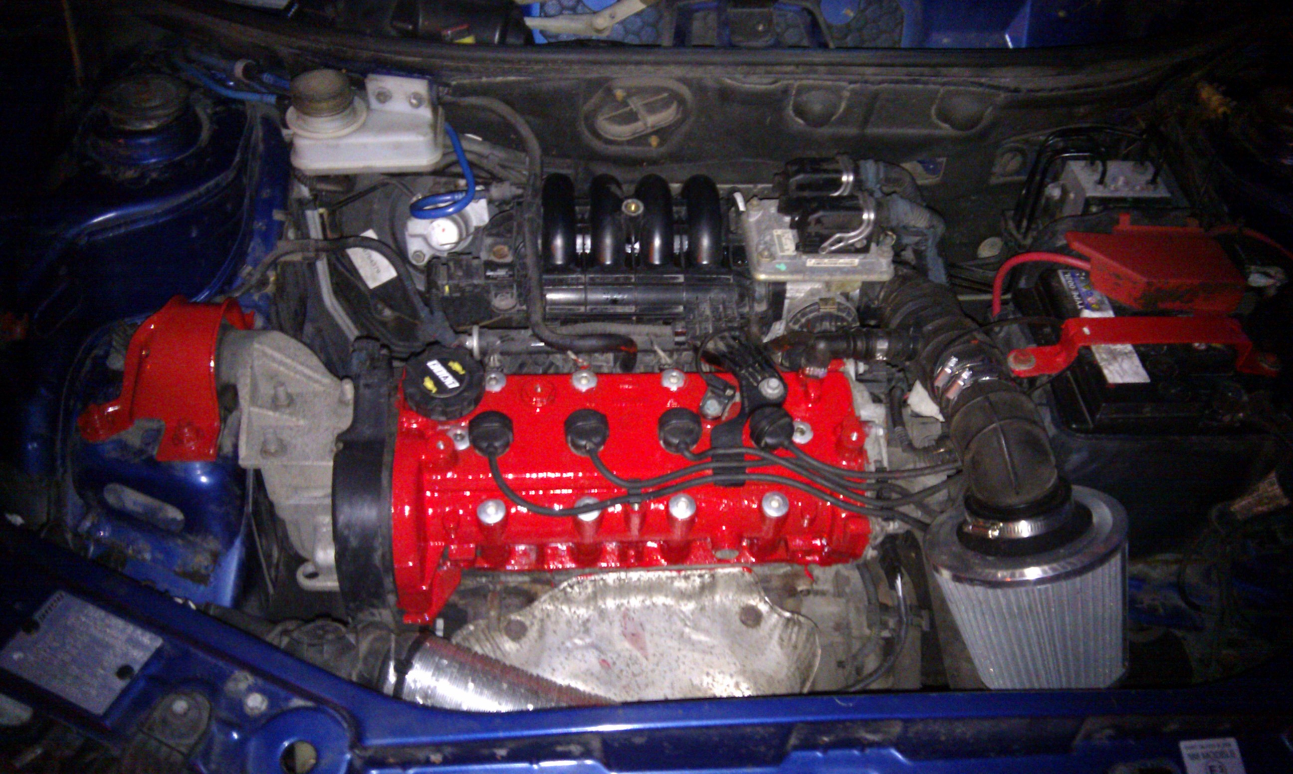

it is true, but it isnt. toyosports make a "focus style" induction kit for the 16v and costs about £30. u can also save cash by making ur own using the original inlet pipe like i have for the moment.
i just cut the pipe b4 the bend and use a bit of pipe to re-attach it to move the filter away from over the manifold. filters can be picked up for like £15. other options are thinks like pipercross and gsr which cost more, the latter, although the best, will set u back ~£180 new.
or, if ur feeling adventurous, u can do what brin said and make ur own using silicone bends and piping.
65mm silicone bends are about £15 apiece on ebay.
Straight steel pipe can often be found in a scrappies or even bought new from a metal factors. Then all you need is some hose clips and some time to fiddle about.
