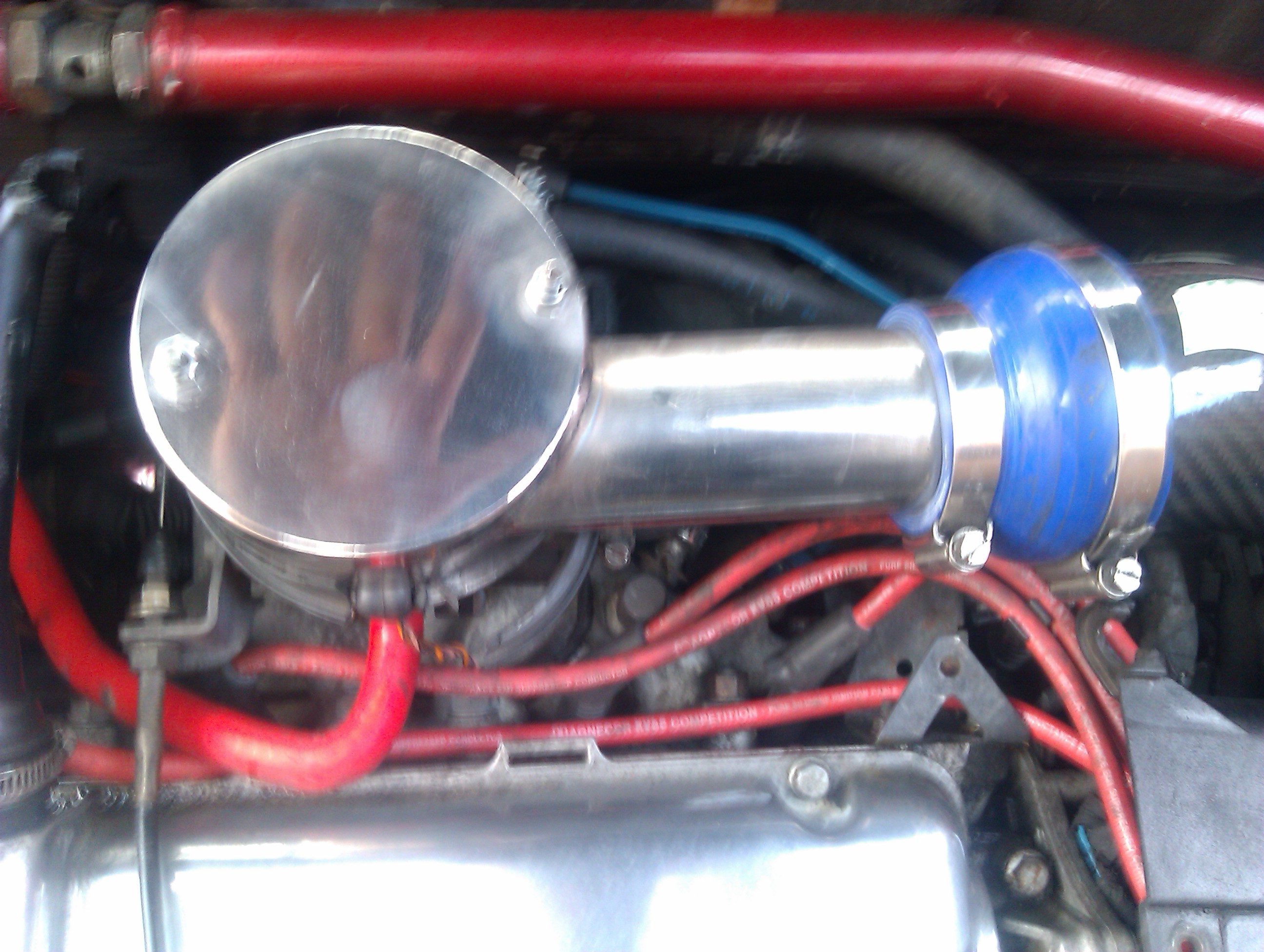

I have gsr I just need the measurements to make a larger bob I have seen stainless ones made up that look the mutts nuts but have no idea on measurements or how to make em up, although I have the means to :)
you mean like this *makes chldish ner ner ner ner noisies*
sooo today i got the tricker and mckritch'd ecu cheers ming ur a star :D
unfortunately the throttle cable holder is broken so one of those needs to be sourced, not 100% sure what the part came from but its not the same part as the standard tb,
so after a quick test up the road she officially goes like stink :D, throttle response is soo much better, it pulls so hard all the way from 3k up to the limiter, only a couple of small issues, it hunts very slightly and ticks over around 1.3k rpm im gonna swap out the icv from the old tb and see if that settles it if not ill look into making a thicker pair of gaskets for the spacer,
if any ones wanting one of these then seriously look as hard as you can and sxpect to pay top money as its gotta be one of the best mods going... but well worth it
