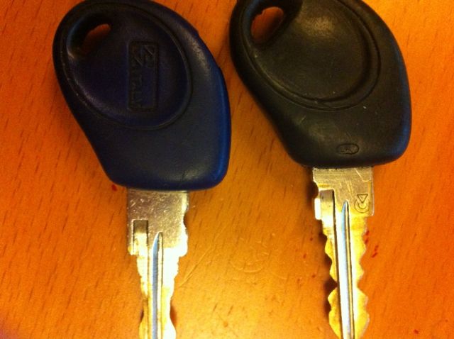

I've just spoke to a chap at Fiat who says my reg number comes up with a mechanical pump and the red key system which means, if I don't have the red key then it's an entire new injection system which is obviously garbage! I've got an electric pump, a yellow box near the steering column, one blue and one black key.
They're both this shape:

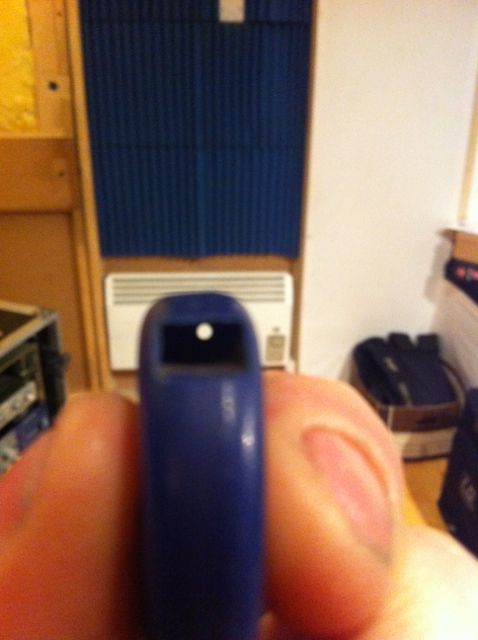

Funnily the blue one has a hole where the transponder is depicted on this picture so I'm stumped and am now not sure whether I have a transponder in my key even!! The black one I have acts the same so..? I can't find an owners manual online and information regarding the keys (What I should have for the rest of the system) is becoming more and more confusing. Maybe I have a hybrid system, something which happened during the changeover between engines and body shapes. Crossingkeeper, do you have the procedure for reprogramming the black keys off the blue?
Thanks again :)

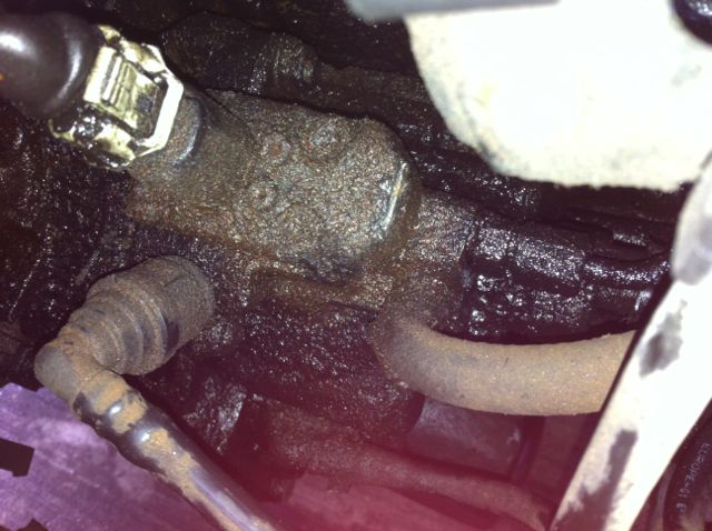

Are you sure you have a jtd does your injection pump look like this:
http://www.xzsy-cn.com/images/upload/090424171942DSC00726.JPG
You can forget about cutting wires and diying the JTD its not simply a case of disabling the fuel solenoid, the immobiliser function is programmatically implemented in the ecu.

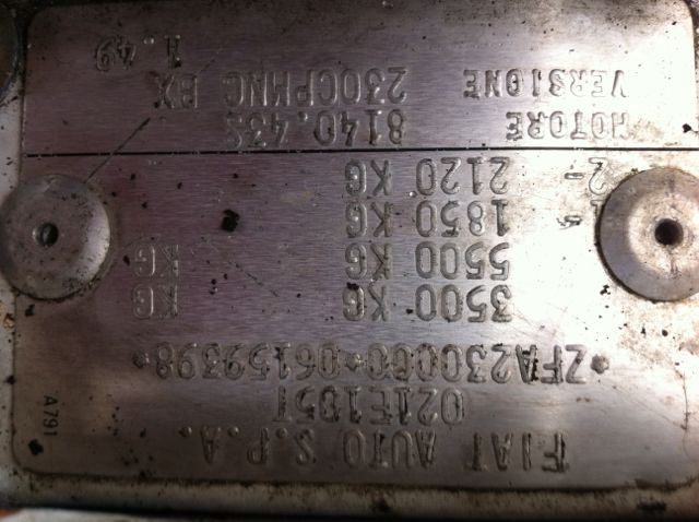

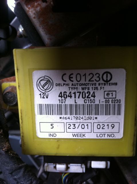

Hello again and thank you for your replies thus far. I've attached a few images to help identify the van and to help me explain a few things.
The pump is indeed an electronic one, I've managed to photograph the top of it for examination, plus I can see the 'Common rail' in line with the injectors, there's a pressure sensor in the middle of the bar, it's definitely there so it's a JTD alright! The blue/Purple key is indeed missing it's transponder and there's dirt in the hole so it's been missing one for some time (It's a generic one from a key cutters, googling the code on the side has brought up blank keys). The black key has a triangle with 2 circles but NOT a 2 on it so it's code 1 however, and this is interesting, the guy I bought it from said the black one opens the doors, the blue/purple one started the engine and unlocks the fuel filler and I never questioned his advice. The blue/purple one does not lock the doors, the black one though will turn the engine over.
The circumstances surrounding the immobiliser failure co-insided with me taking the steering cowl off and giving the innards a really good clean, I also replaced a light in the dash that had gone out and gave that a good clean up too. I also fixed the heater direction control switch and the blower resistor pack which had rusted. I had the interior light on the whole time and was turning the electrics on and off with the key to ascertain progress on the heater blower repair. It wasn't until 2 hours later that when someone pointed out I'd left the interior light on that I tried to start it to no avail. The CODE light came on and stayed on and the injector symbol comes on too, blinks off and back on again and stays on. Jump starting from another vehicle didn't help, charging the battery overnight from a charger hasn't either.
So, I've either reprogrammed the immobiliser with a key without a transponder in it buy clicking the electrics on and off in an special sequence... Or the transponder was hidden in the cowl and I've washed it away.. Neither seems likely though to me, I'm not blind and I don't think the system is so fallible. I also unplugged the connectors from the barrel when cleaning and I also unclipped the antenna around the barrel and unplugged the antenna from the yellow box which seems a more likely cause, It may have thought it was being stolen, thing is if you plug it back in, what's the difference to changing the battery? I may have done something else I'm not aware of, a sequence of all those things that has buggered it up but it seems a bit crazy to me.
I put a pic of the ID plate up don't know if that's the chassis number though..?

My blue key is tucked away somewhere and I'm not at home so can't check, but my black keys cover all functions i.e. I never use the blue key
As it is unlikely that both your doors would have been changed it seems likely that a previous owner had problems with the immobiliser on your van and has put a complete system off a scrapped van complete with it's own blue key (the original black keys to this S/H system would be of no use unless he changed all the locks on the van as well so were binned) Your ignition barrel is probably the original one so your black key will fit but is not coded to the 'new' immobiliser antenna. The fuel filler cap is an easy changeover so also came from the scrapped van thus fitting the blue key.
Therefore if your blue key did have a transponder and if the system was working you probably could get your black key(s) coded to the ignition antenna.
I realise that I given you more questions than answers :) but hope the explanation regarding the keys may help in understanding the history.
Lot's of scenarios could well have played out on this van. I don't have a key that works on the passenger door either! Thankfully the barrels are easy to swap over and only £40 ish quid on ebay. I will be speaking to an auto locksmith and will hopefully be able to get a key coded off the yellow unit. No idea what has happened to the immobiliser to break it but I think it's not irreparable and I doubt it's prohibitively expensive.

The dealer is wrong anyway or you gave him the wrong vin that vin number comes up correctly as a JTD.
The data in the ecu, immobiliser unit and key must match it may have go out of sync, theose immobiliser boxes are common for corruption - same box is in bravo, brava, cinq etc. etc.
Your options are get the stealer to try to resync the keys, if not they'll charge you for a new immobiliser unit, then maybe throw an ecu at the problem.
Call an auto locksmith they'll be able to recode the immobiliser unit, check your keys, check your key antenna etc.
Or get a complete ecu, immobiliser, key set and swap the lot - make sure you don't power them up separately.
