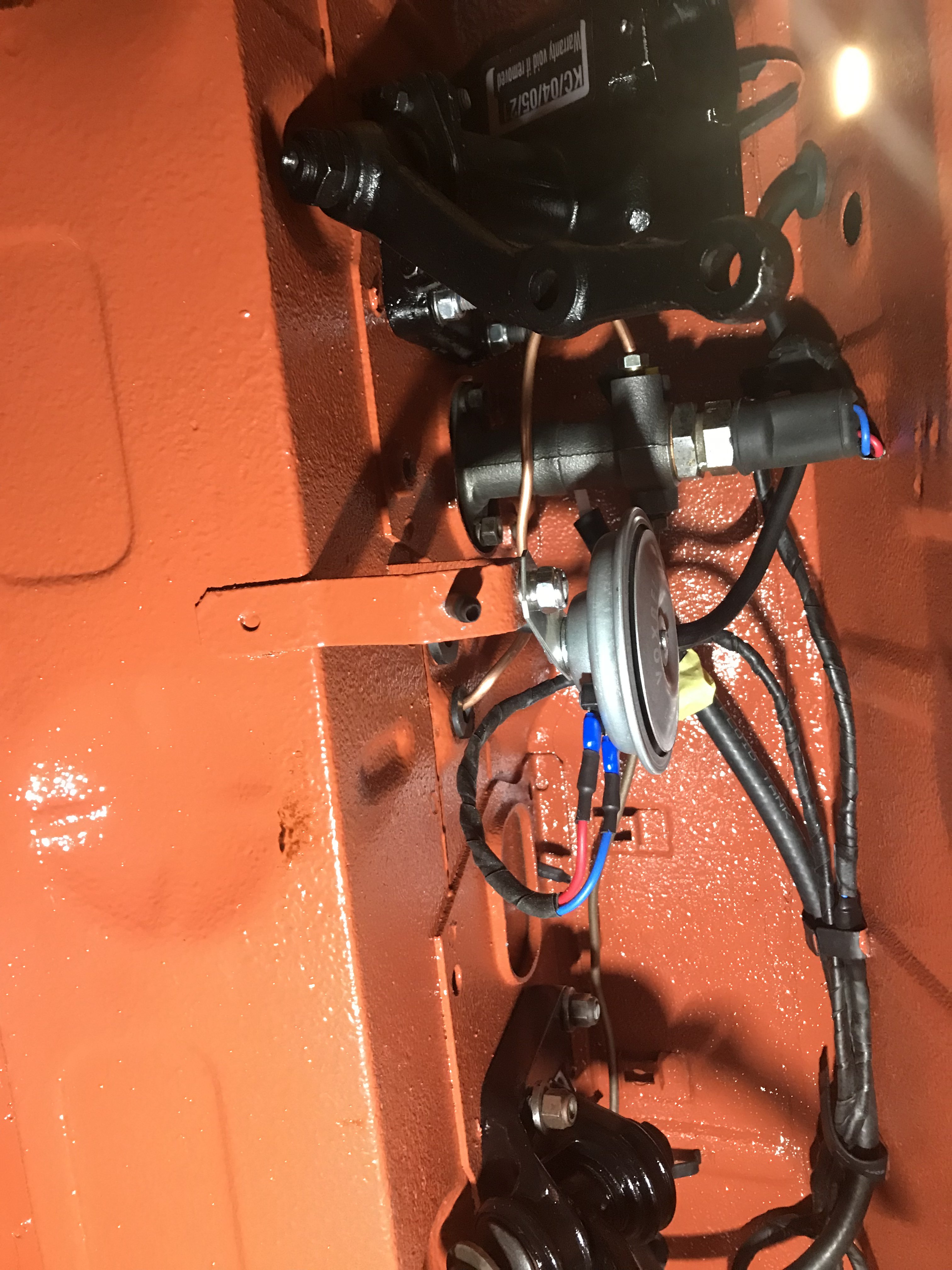

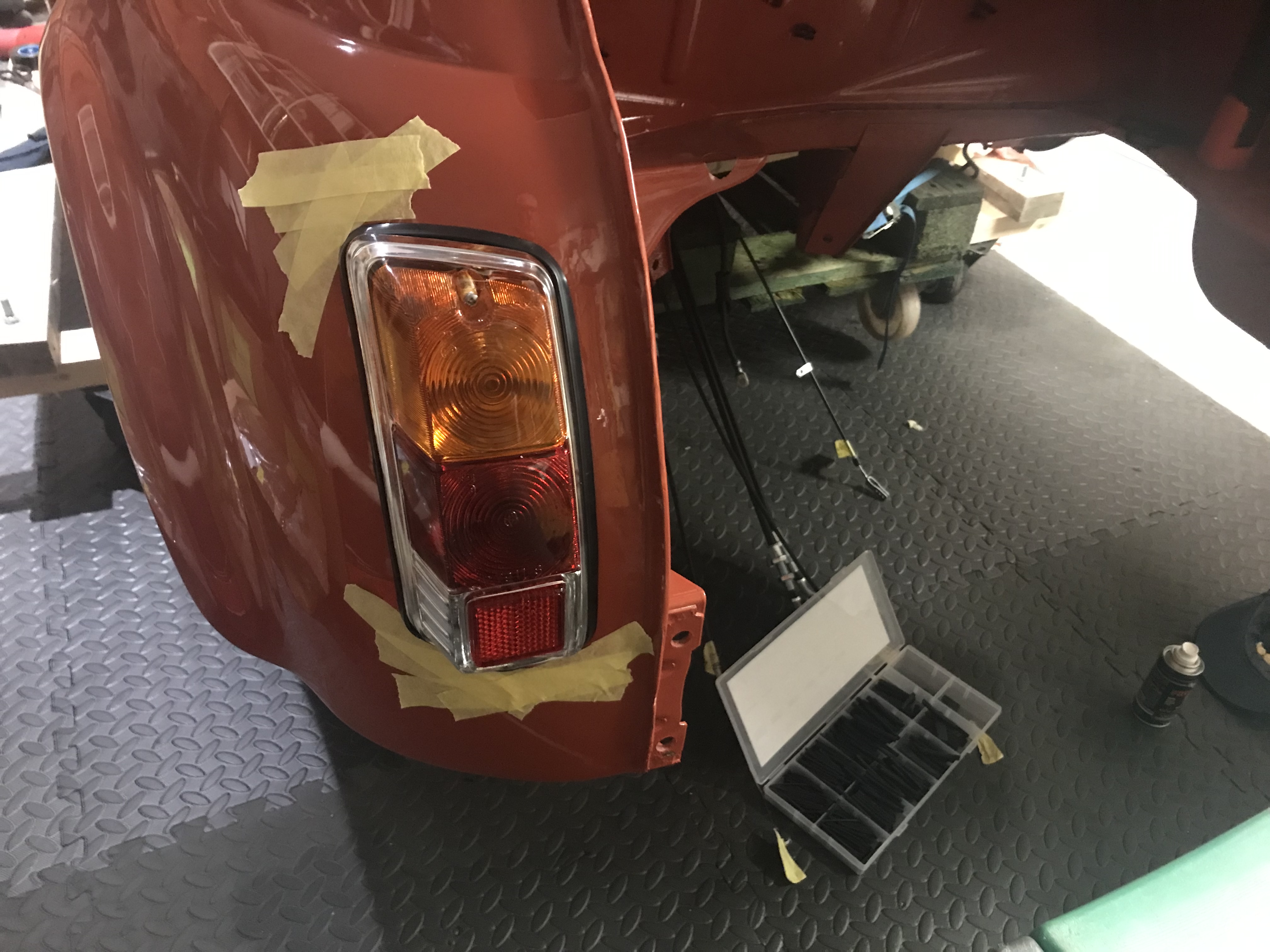

in the meantime a few photos’s of Arancia’s progress. And yes - I know the cables in question are poking through the wrong hole into the cabin!
