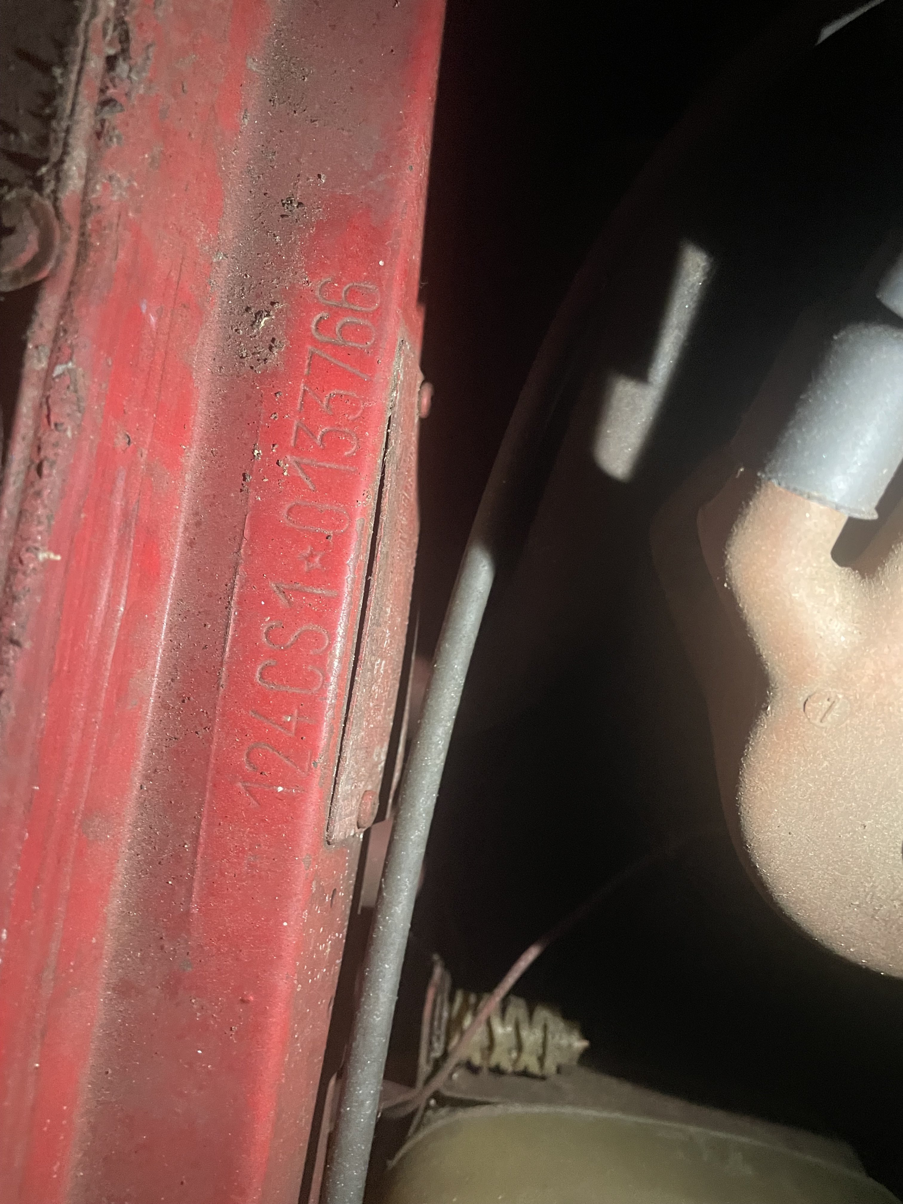

I found two VINs in the engine compartment: one engraved on the chassis, the other one on a plate positioned just below the engraved one.
The engraved vin reads: 124CS10133766
The one in the plate reads: 124BS10050496
Any clue about which one is the correct one?
I assume it’s the first but I have no basis to confirm. Please help,

I also reckon your car is a CS model, I would tend to rely on the vin stamped into the body rather than a removeable plate (which afaik are available from aftermarket suppliers?).

I agree. I will consider the VIN engraved in the body. Nevertheless I still have a couple of doubts.

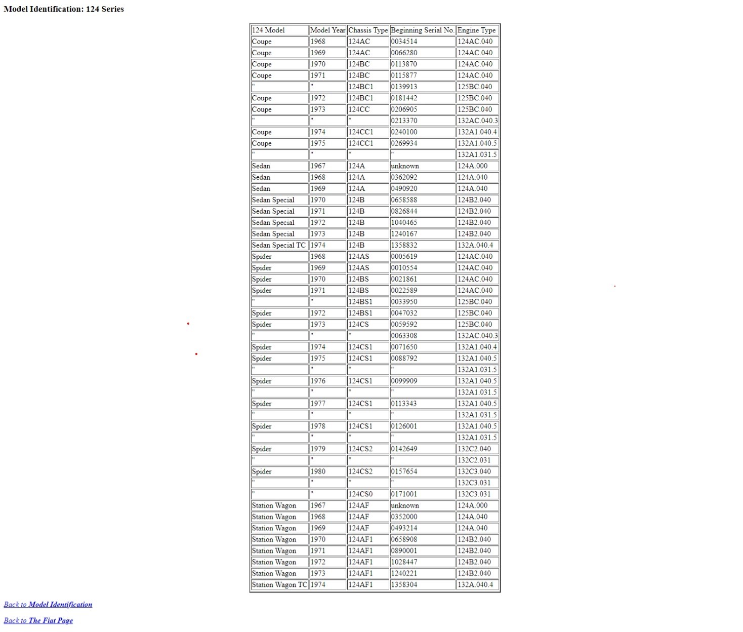

In accordance to the 124 VIN chart attached there is a discrepancy between the chassis type and the serial number.
My VIN is 124CS10133766. The last year of the chassis CS1 was 1976 but the serial number is 133766 which indicates 1978. Also I checked the number engraved on all original glasses of the car: 7 (1977). Thoughts? Thank you
I checked a couple of other sources that listed model, year, chassis no. and beginning serial number for the 124 Spider, both of these show the 124CS1 model was produced from beginning 1974 to end of 1978 so I reckon that your car is a 1978 124CS1 model (this would tie in with your original glass codes being 1977). Here's one of the sources (the other is identical) :-

The VIN stamped into the chassis VIN is the same in two places so for me the body shell dates from 1977/1978.

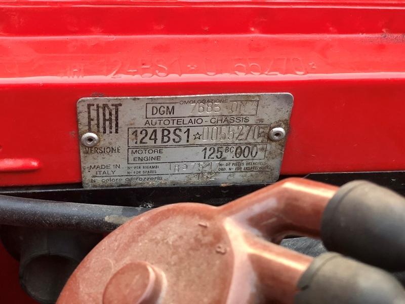

funny thing! The stamped in VIN must be the correct one. The plate is mounted with screws, the original ones are fastened with rivets! (see attached)
The worldwide Spider Register would be a good source for the history, but these two VINs are new (will be included)!

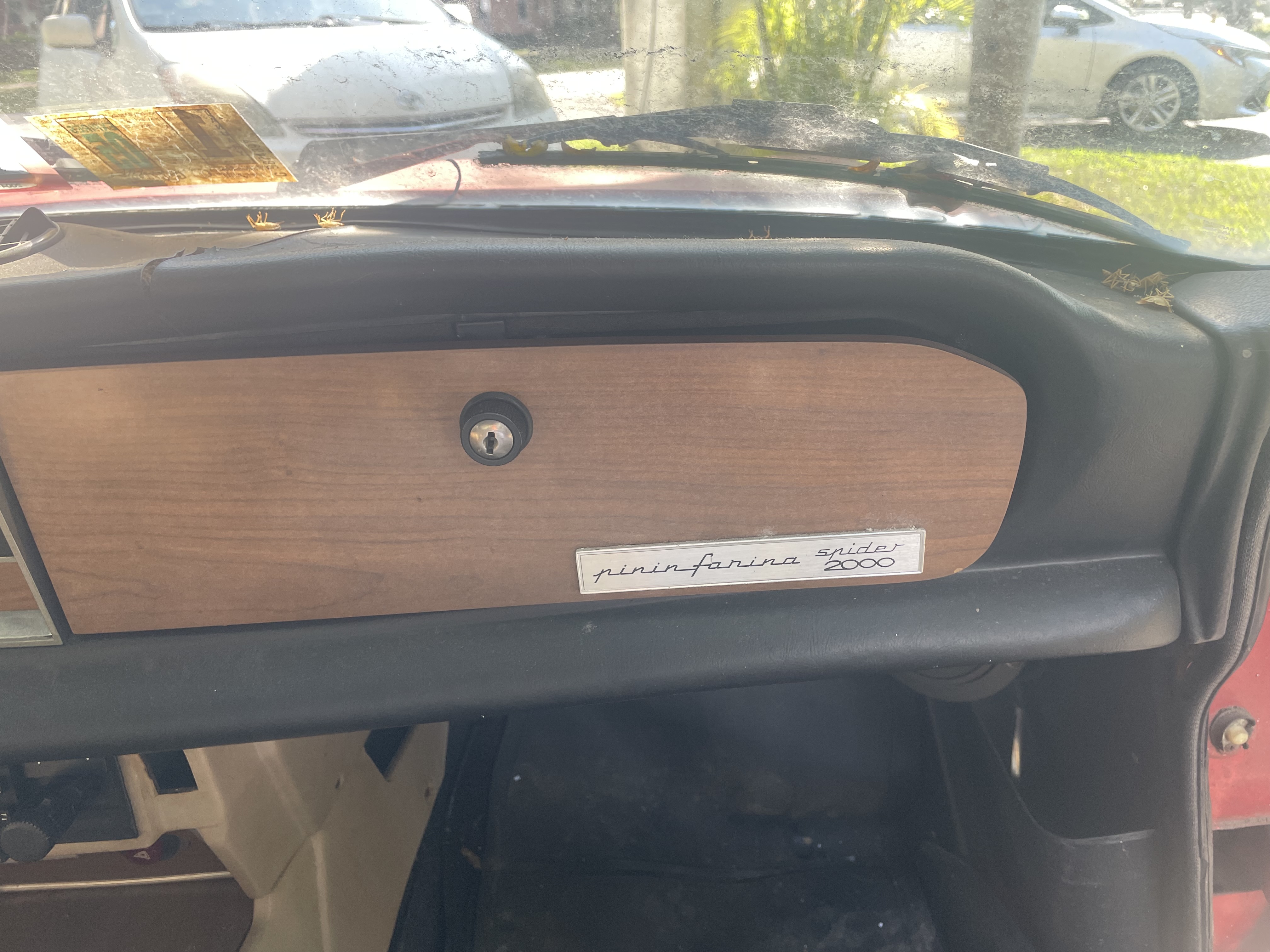

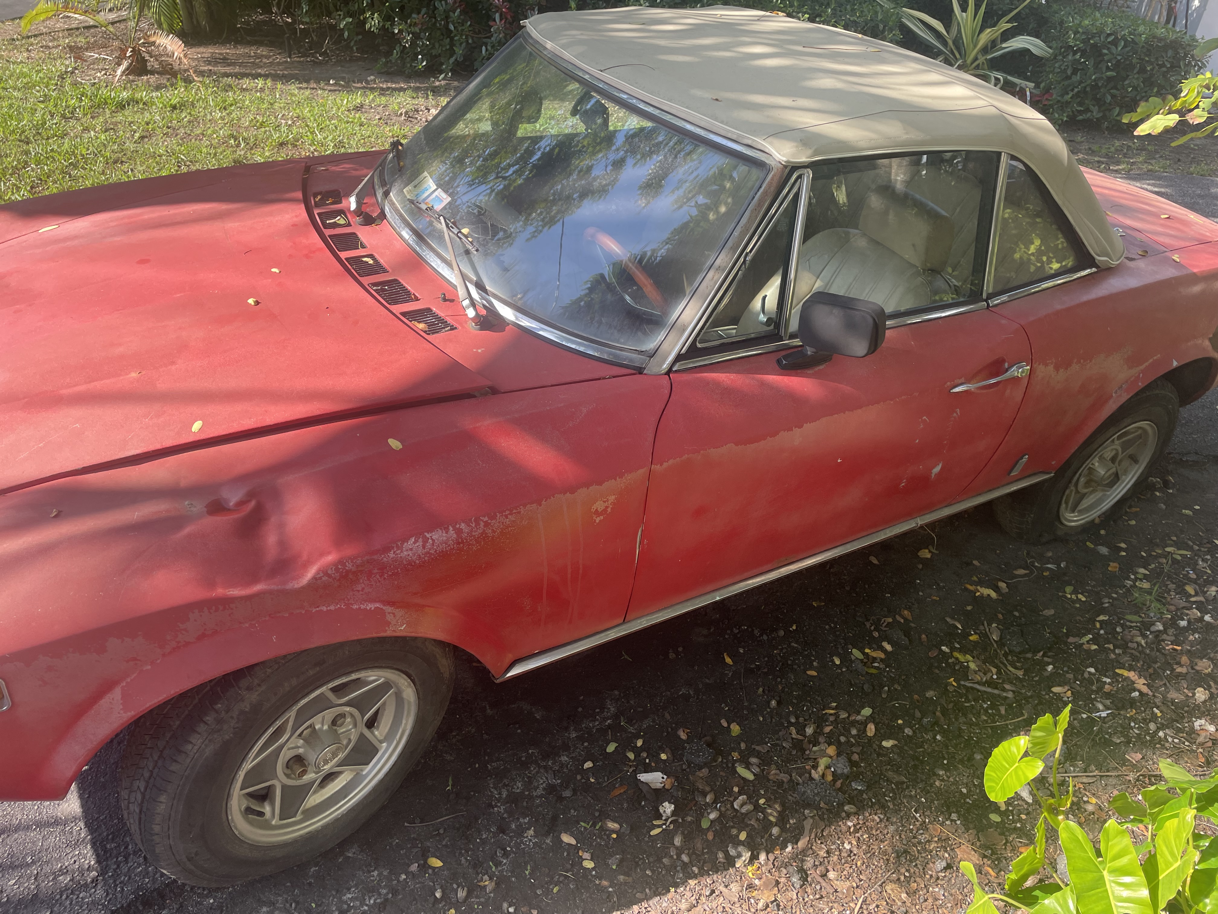

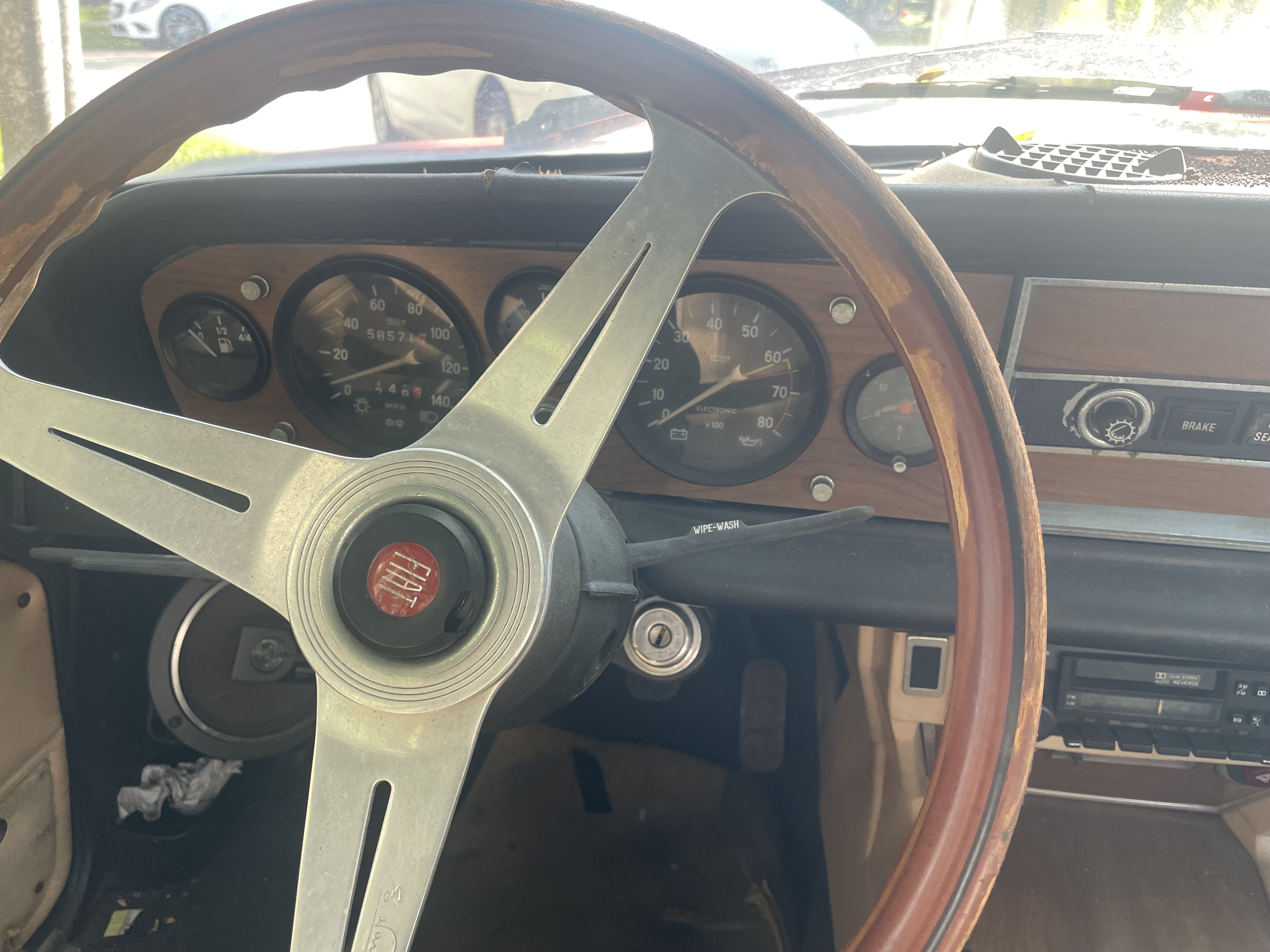

Thanks a lot! Very useful information. I will check the engine block number (where is it located)? In the meantime I am sharping some pics of the spider. Another interesting piece of info is the internal plate indicating this being a spider 2000 (in the back of the car it says 1800). I know it’s a 1800cc build in 1978. Any recommendations? Thank you

from the pics your car must be the later 78 model with VIN 124CS10133766. Bumpers, side mirrors say: later model!
The badge on the dash board with "Pininfarina Spider 2000" could be from a parted out later Spider from 79-8x.
