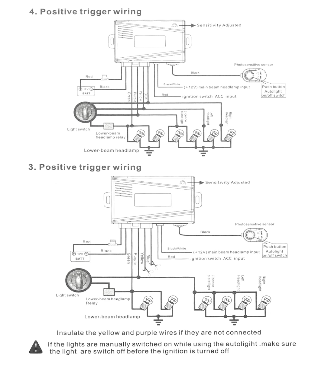

I would like to install a universal kit for turning on the low beam headlights via a light sensor.
In addition, I would like to point out that this kit works in all logics, both positive and negative.
The problem is that now I can't find any signal coming from the light switch.

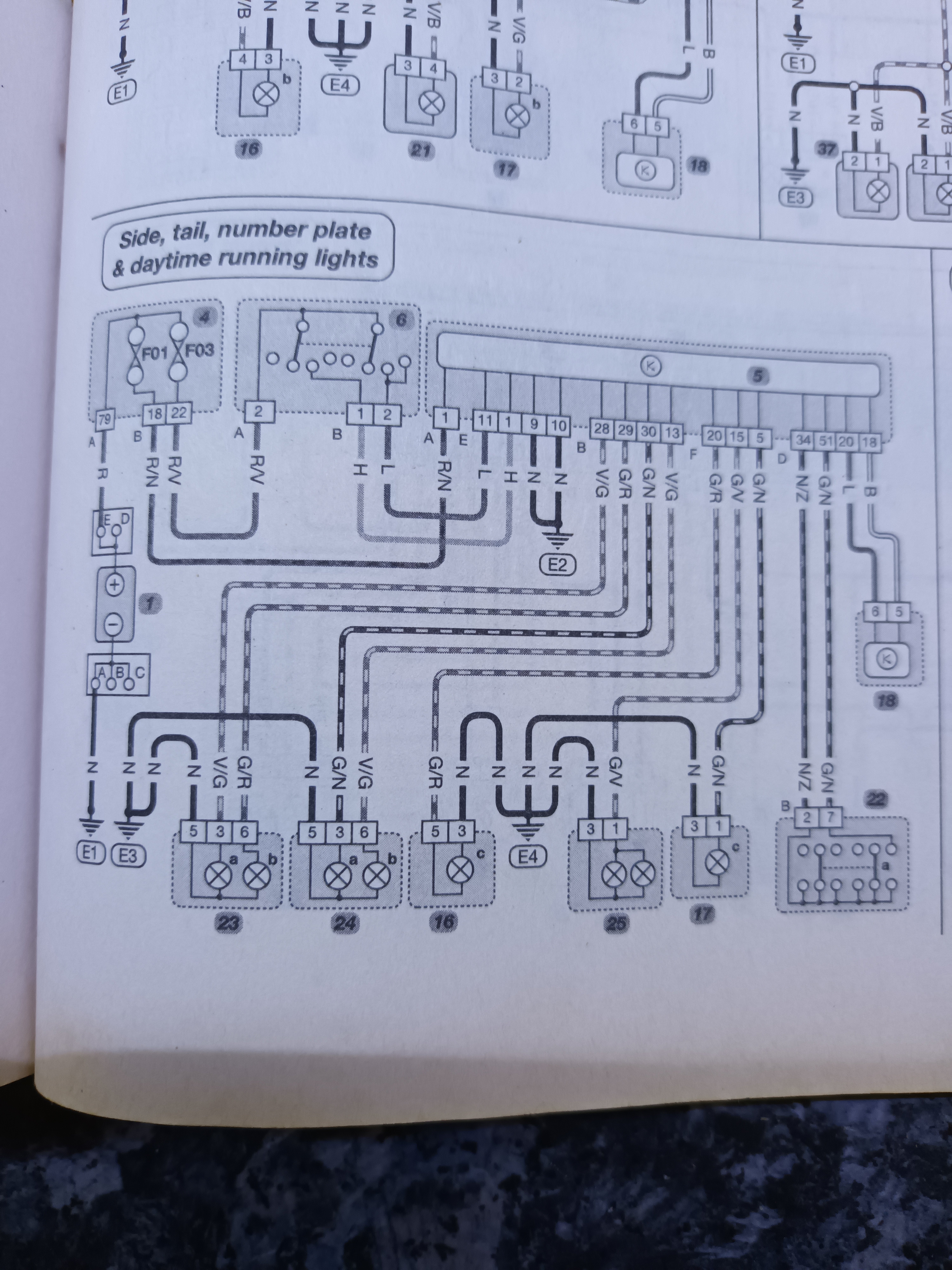

John, Thank you first of all for your reply.
i saw that you have the wiring diagram. unfortunately i couldn't find it anywhere.
Could you be so kind as to post the diagram so i can look up the colour of the wires that go to the headlights and are at the body computer output?
I understand that there are no relays in between, right ?

It looks like at the stalk switch it's either 6+2 or 5+2 for switching options, pull the plug on the stalk and see which pins( on the stalk) go closed when you turn to headlights on? It's these two that your auto switch would parallel switch via a small relay?
Note if you do try this, you could have a problem when flashing someone or switching to main beam as the auto switch would hold the standard on signal whereas the stalk would have changeover?

Dear John.....I found a way to solve the problem .... of course then I will post it!
Before I start testing the circuit, however, I need to understand how the tail lights and number plate lights are connected.
Would you be so kind as to post the diagram if you have it?

Good morning everyone, I am writing to let you all know that I have installed the universal lighting kit.
Below I will explain how I connected it in consideration of all your attention to the body computer signal issue.
- I used the kit configuration to provide a ground signal (negative concept);
- I provided the ground signal to pin 6 of the headlight ignition lever assembly;
- I powered the kit with the positive under the key.
Everything is fully functional and no malfunctions have occurred. I want to thank everyone especially John who provided me with the wiring diagrams.

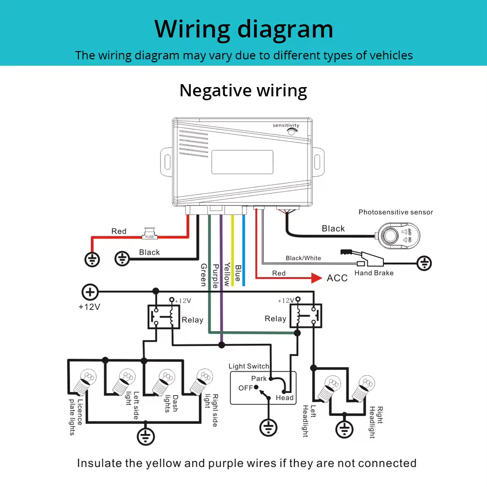

Can you tell exactly which plug you connected to? I also bought such a kit and would like to install it in my car. Which plug should I unplug and which cable should I connect the kit to?
Here's the kit I bought:
I finally found some time and got down to it. The installation was very simple, if anyone wants, I can describe exactly what to do. The only thing I changed though, is that I didn't use a Chinese module, but bought a solid Polish-made module - Proxima KAWA Pro. It is very well made, has CE, UL and FCC certificates and can be configured according to your needs.
