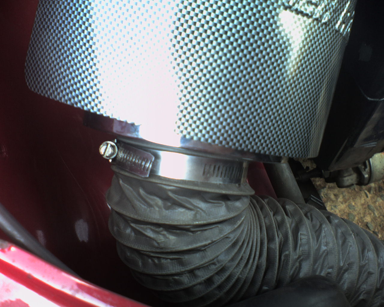

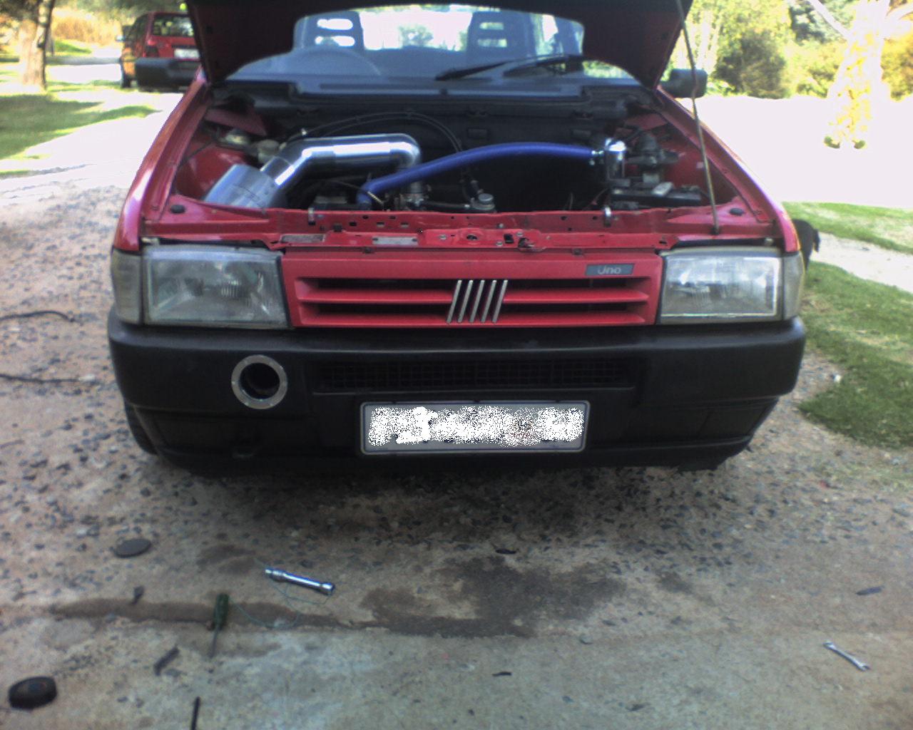

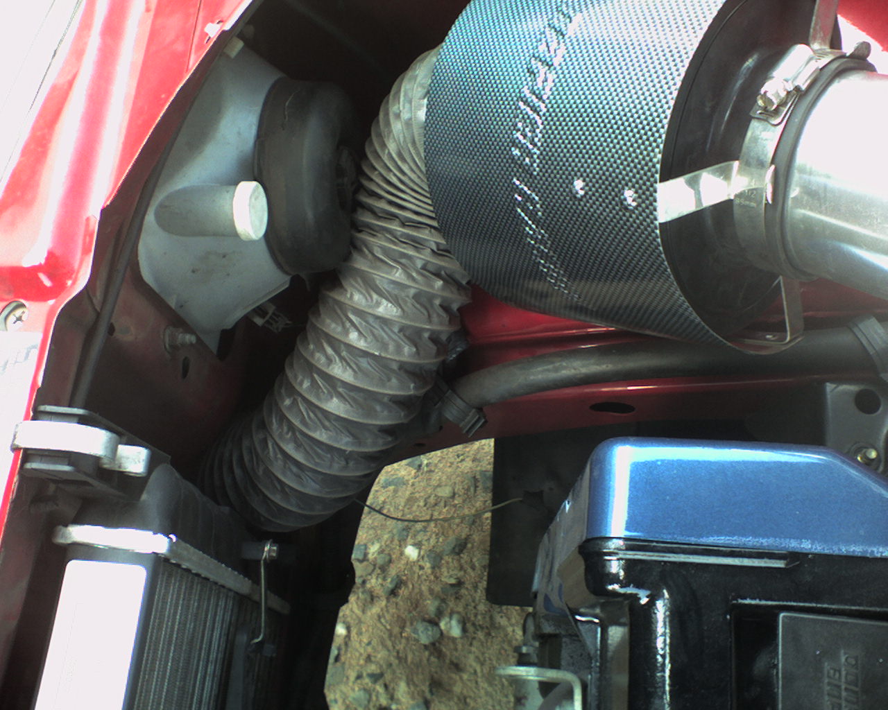

yes, it's possible to put it on the air box, but tested to only be effective from 160 km/h, I installed one on my uno, 76mm piping here is some pics
