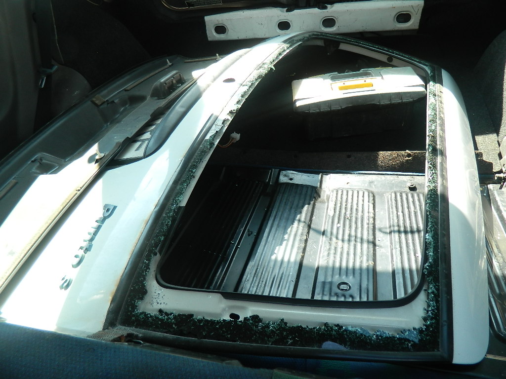

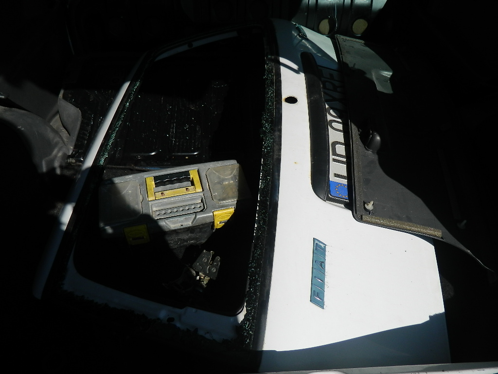

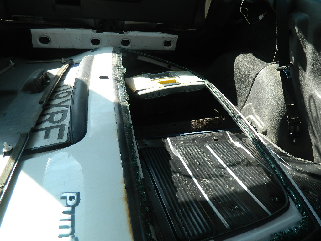

Hello everyone. I ran into a lot of trouble. Owning a Fiat Punto in 2 doors manufactured in 97 'motor 1108. The problem would be: Yesterday morning when I got to the car I gasit'o with broken rear window, I called the police because I thought someone did that on purpose. To my amazement, when they arrived at the auto thefts, studied and they told me that the rear window was broken only because on the broken shards were indretate to the outside of the car, and the car had just broken in trunk. Mi'au explained that if someone breaks it outside then the whole car was full of splinters and shards on the fracture were directed toward the vehicle. Finally .. I've been to the station to free repair authorization. Yesterday afternoon I spoke with someone at 50 km away and said mi'a has a perfect tailgate. Mi'a said that if I just give him sniper with 200 lei and if you get completely all at the same price. Naturally I luat'o altogether. Then I went home I started to dismantle the old tailgate and put it on another, but I noticed that it does not close as it should. From halfway down taillights, tailgate body remains distant about 1.5 cm. If you press it into the bottom left or bottom right corner of the tailgate or tailgate corner, managed to put him in position to be, but if I let go back again. I took the car tailgate is also a 2-door Punto, but the 95 'and 1.2 engine. Is there any difference between haioane? Or has any control something. I have not seen anything on hinges. I hope you can help me as I can already throw me in front of the train of nerves. Thank you kindly read through. How can i adjust it? I am from Romania and i'am sory about my english.

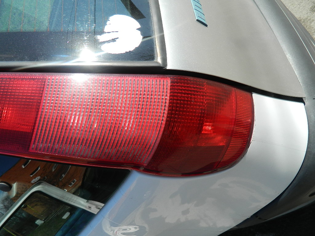

Yes it doesn't fit on the car. I bought another trunk with glass mounted from another car (the same model). The new trunk it doesn't fit. It doesn't close properly. Remain a distance between trunk and the body of the car. Do you understand? The distance is about 1,5 centimetres. It close, it opens, but dosen't fit properly.

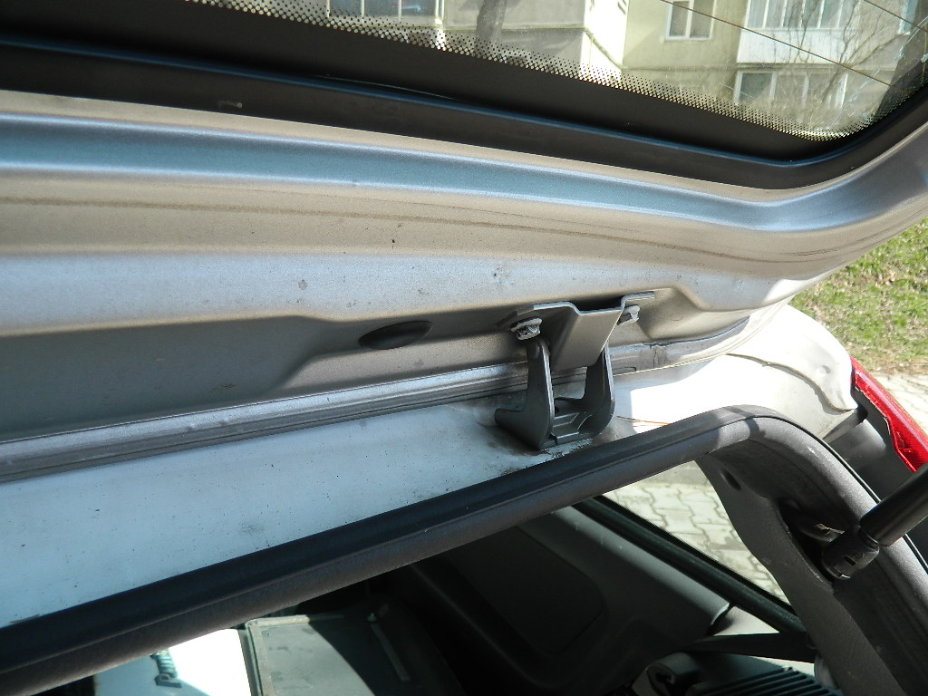

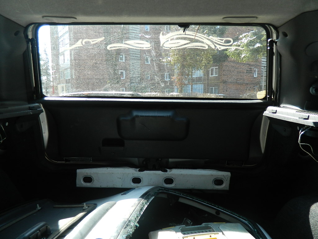

My Punto doesn't have adjustable bumps stops. And yes does it shut but not sit straight. You are right. It's a difference between down side of the trunk and the body of the car. I could get my fingers between the trunk and the body of the car. Do you understand? I could give you some pictures just tomorrow.
This is the trunk

I tried to put hinges and catch the old ones and is a small difference(better with the old ones). I don't know what to do.
The curvature of the new one looks different to the body of the car? Very strange.
