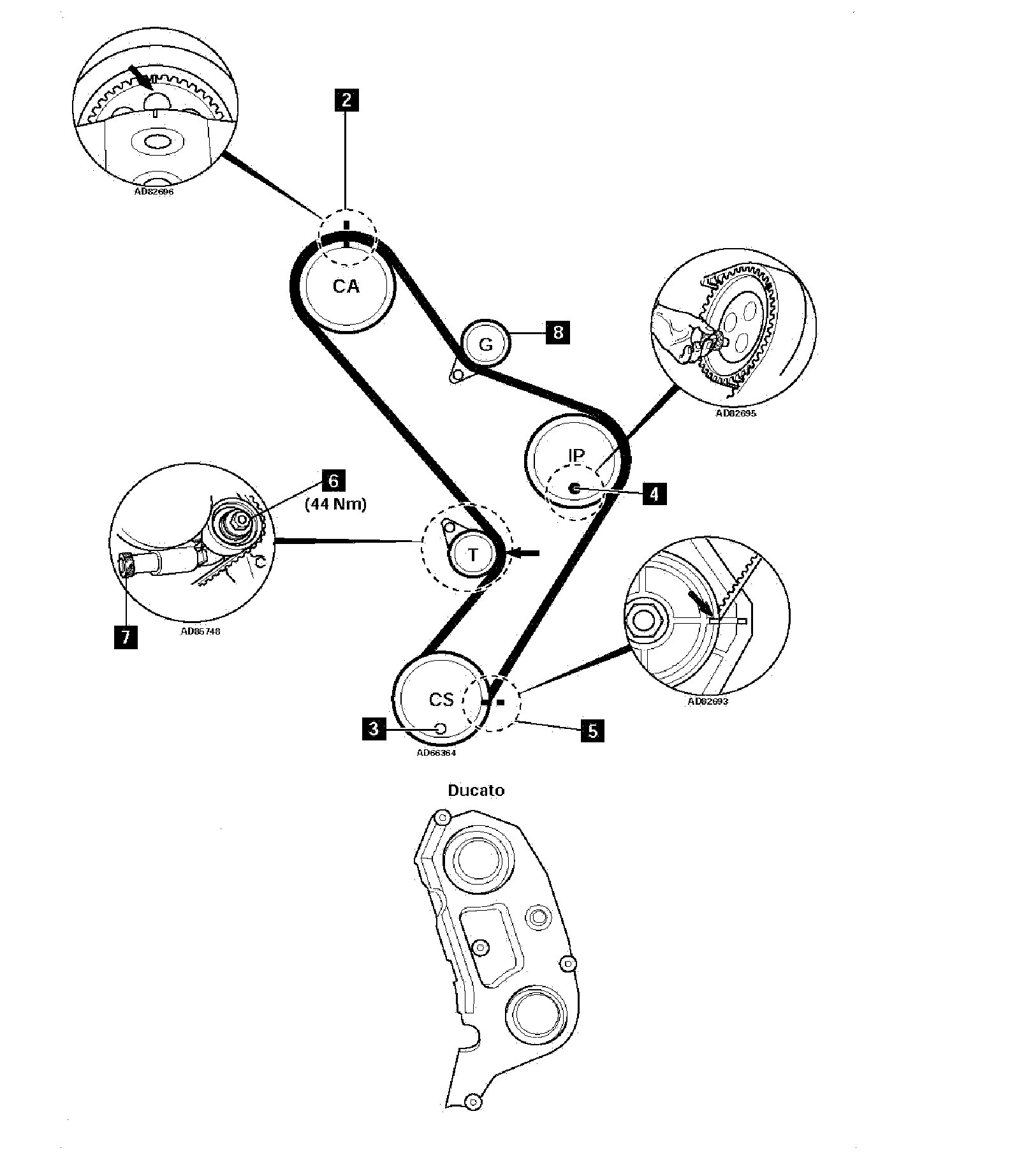

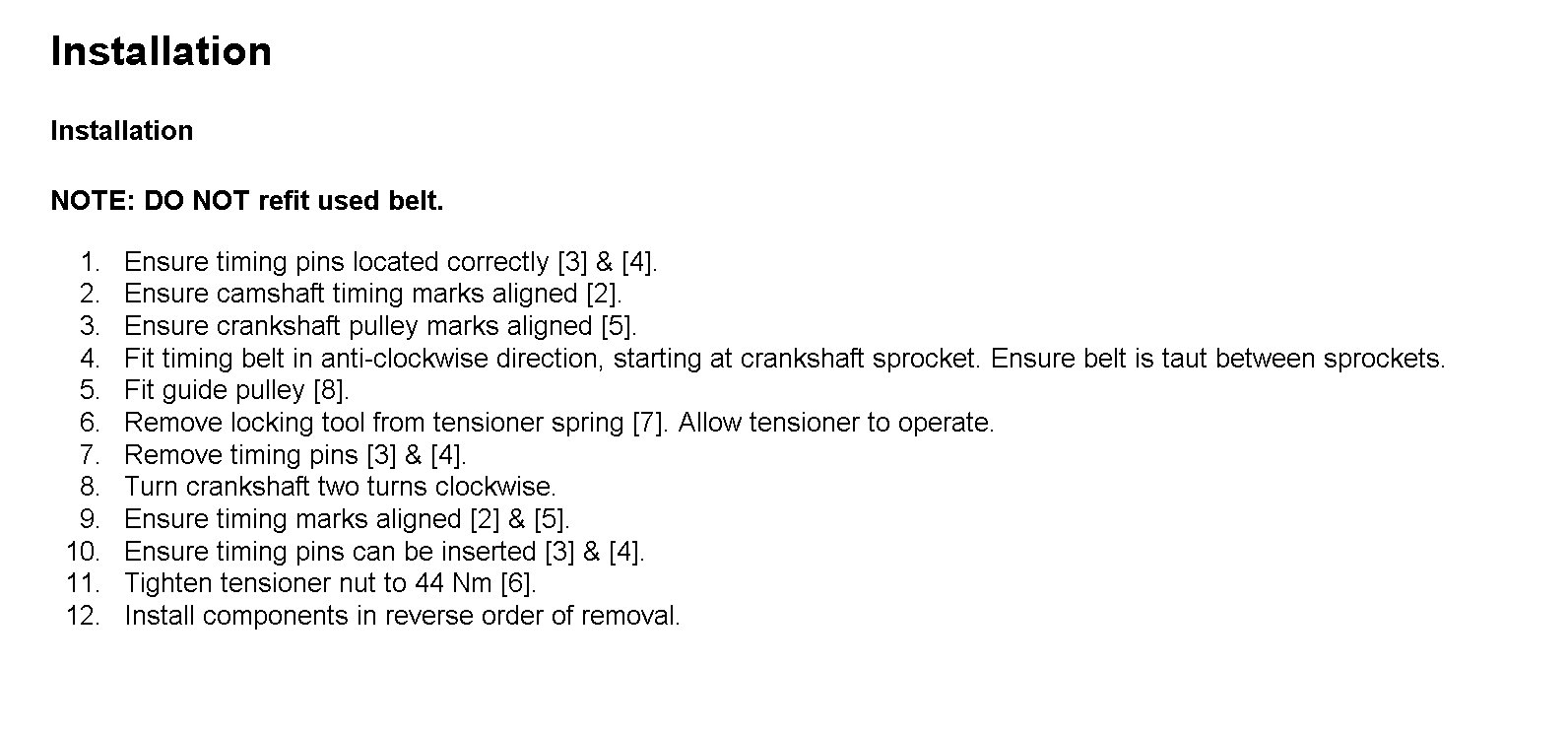

A Andy14 New member Joined May 24, 2009 Messages 1 Points 1 May 24, 2009 #1 Hello, Please can you help me with a photo or picture of the timing belt i need the timing specifications. Thank you
F FreeSpirit Established member Written 5 guides Uploaded 5 resources/downloads Joined Nov 18, 2006 Messages 700 Points 232 Location Sunshine Coast Qld, Aust May 25, 2009 #2 Andy14 said: Hello, Please can you help me with a photo or picture of the timing belt i need the timing specifications. Thank you Click to expand... Hope this helps Ducato 2.5D Turbo 91-94 Engine code 8140.27 Cheers Attachments Install.jpg 125.9 KB · Views: 160 2.5Timing.jpg 226.8 KB · Views: 423
