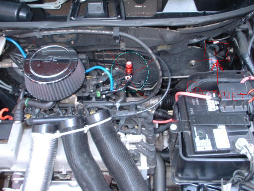

Im going to be fitting my amp in the next few days, where can i put the wires from the battery into the car i have had aquick look and cant see anywhere to feed them through, and also does anyonw know how to get the headunit out without the keys to remove it, i dont really want to buy some just to use once. Thanx to anyone who can help

When amping my HGT was unable to find battery access so drilled and gromouted the floor on the passenger side will get photos if wanted.
Steve
photos would be good! As i cant seem to find any one who knows where to the power cord on a mk2 punto sporting!!? Really want to get started but i cant seem to find any way of getting the cord thorugh the gromit seems far to tight...
here is a pic of someones engine bay .. with the grommet to put the red amp cable trough .. just make a hole with something pointy in the rubber and then you can push the cable into the car..
