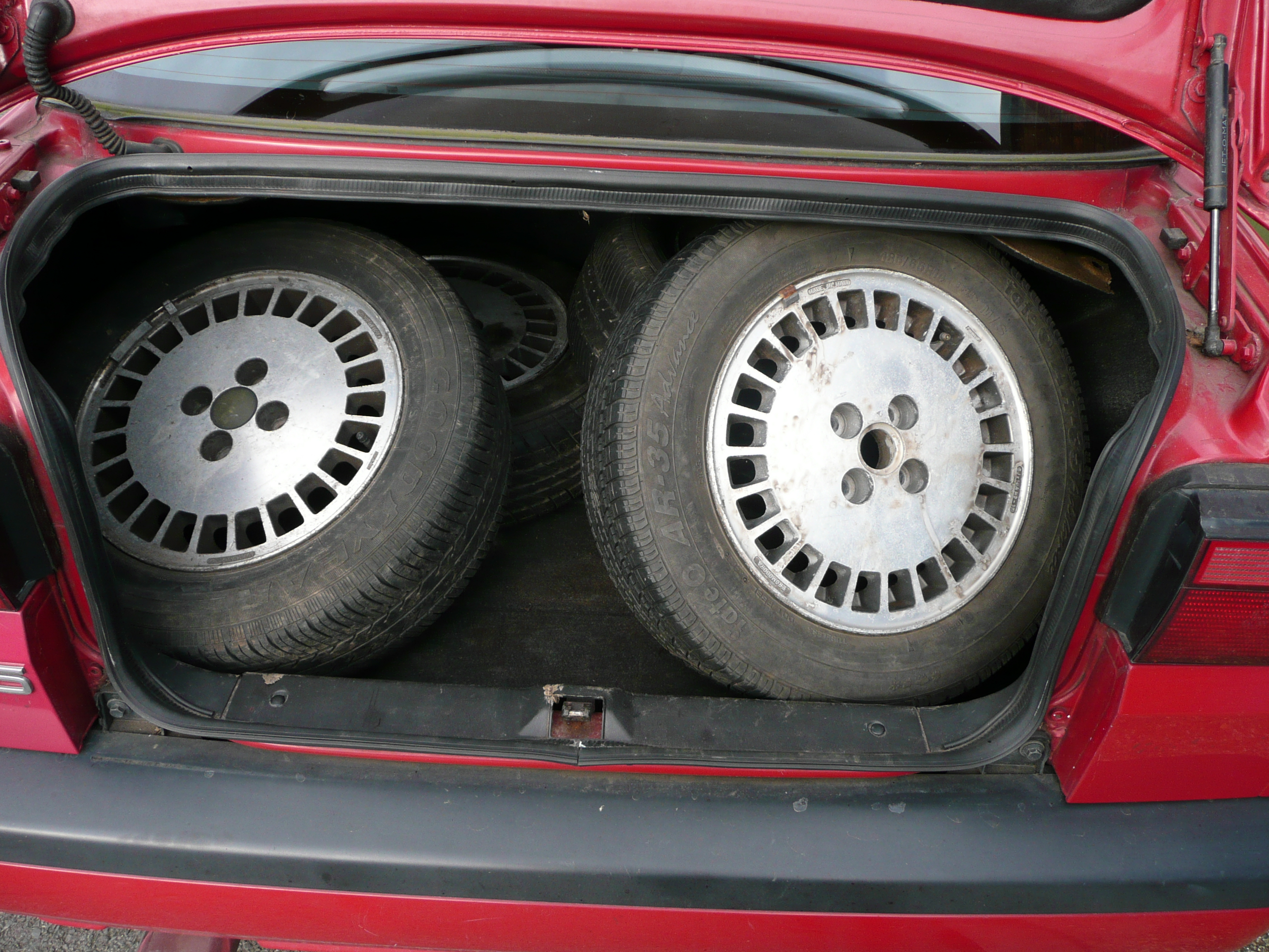

see, a long time ago, i pointed out that the 13" uno turbo alloy was all very well, but a 15 would be nice. chas pointed out that the mk1 croma occasionally came with an identically styled 14" rim, a good halfway house, and so began many years, i fruitlessly searched....till my old mate ebay came along......
a big booted alfa helps:

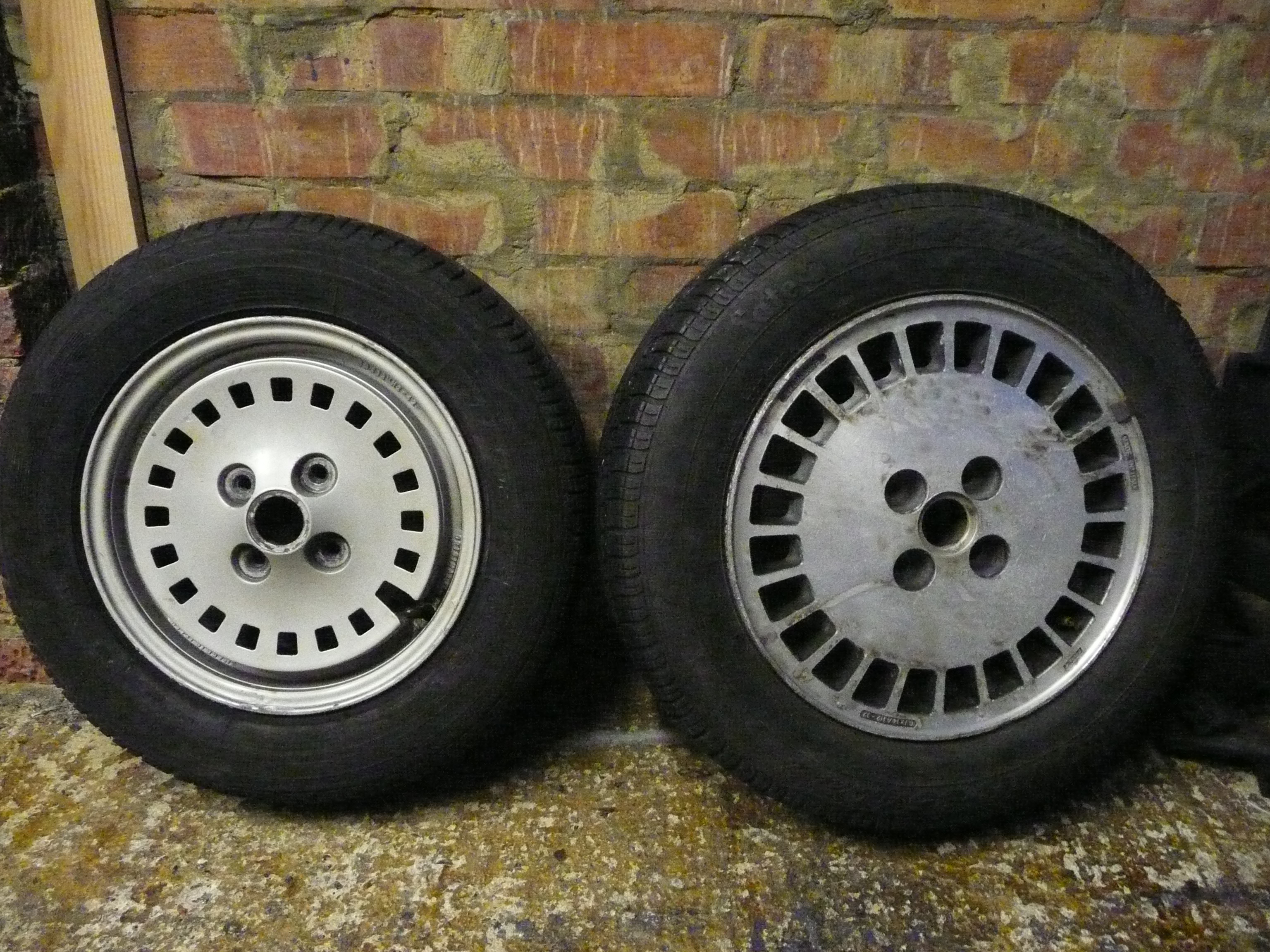

the difference is clear:

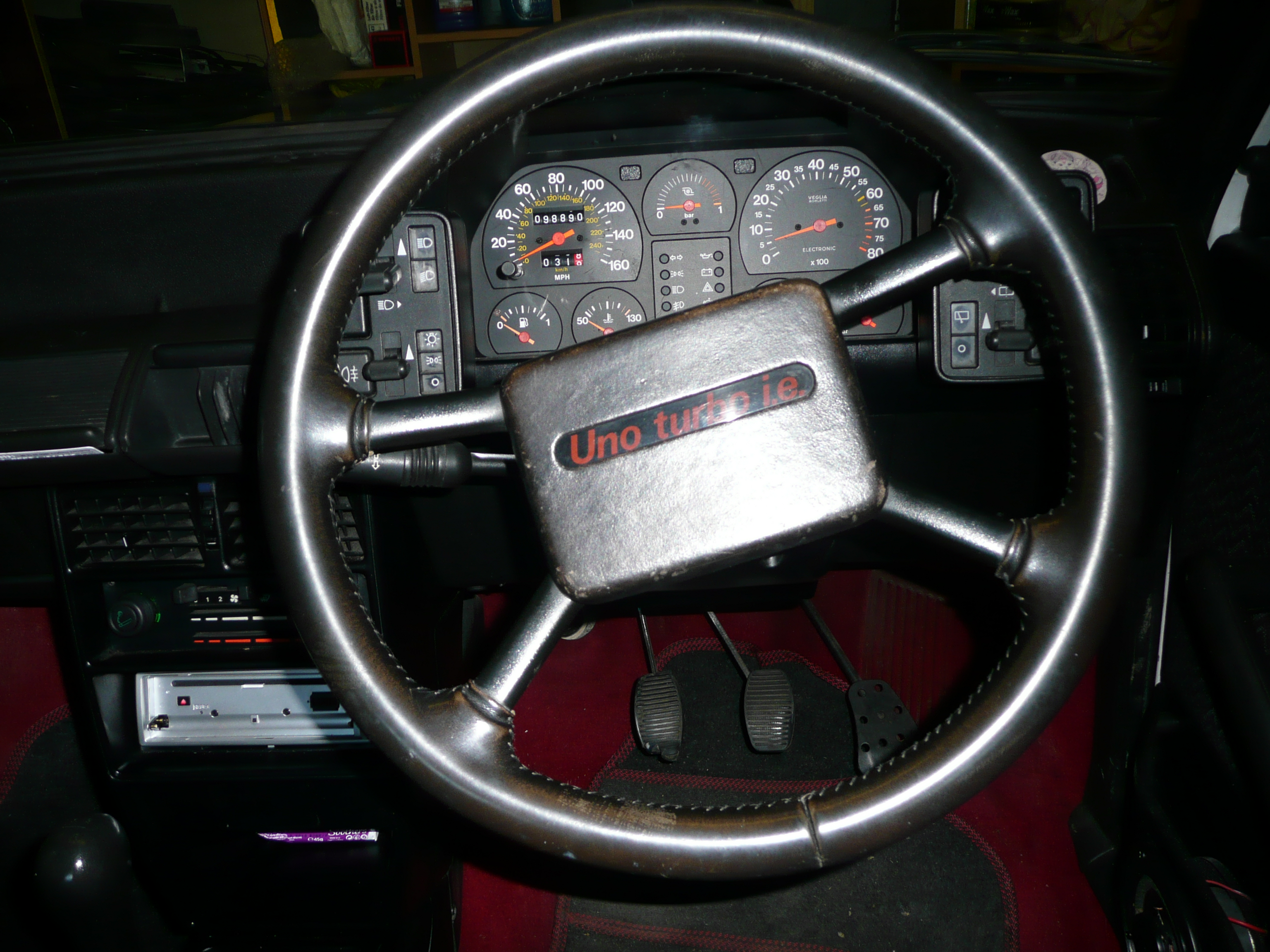

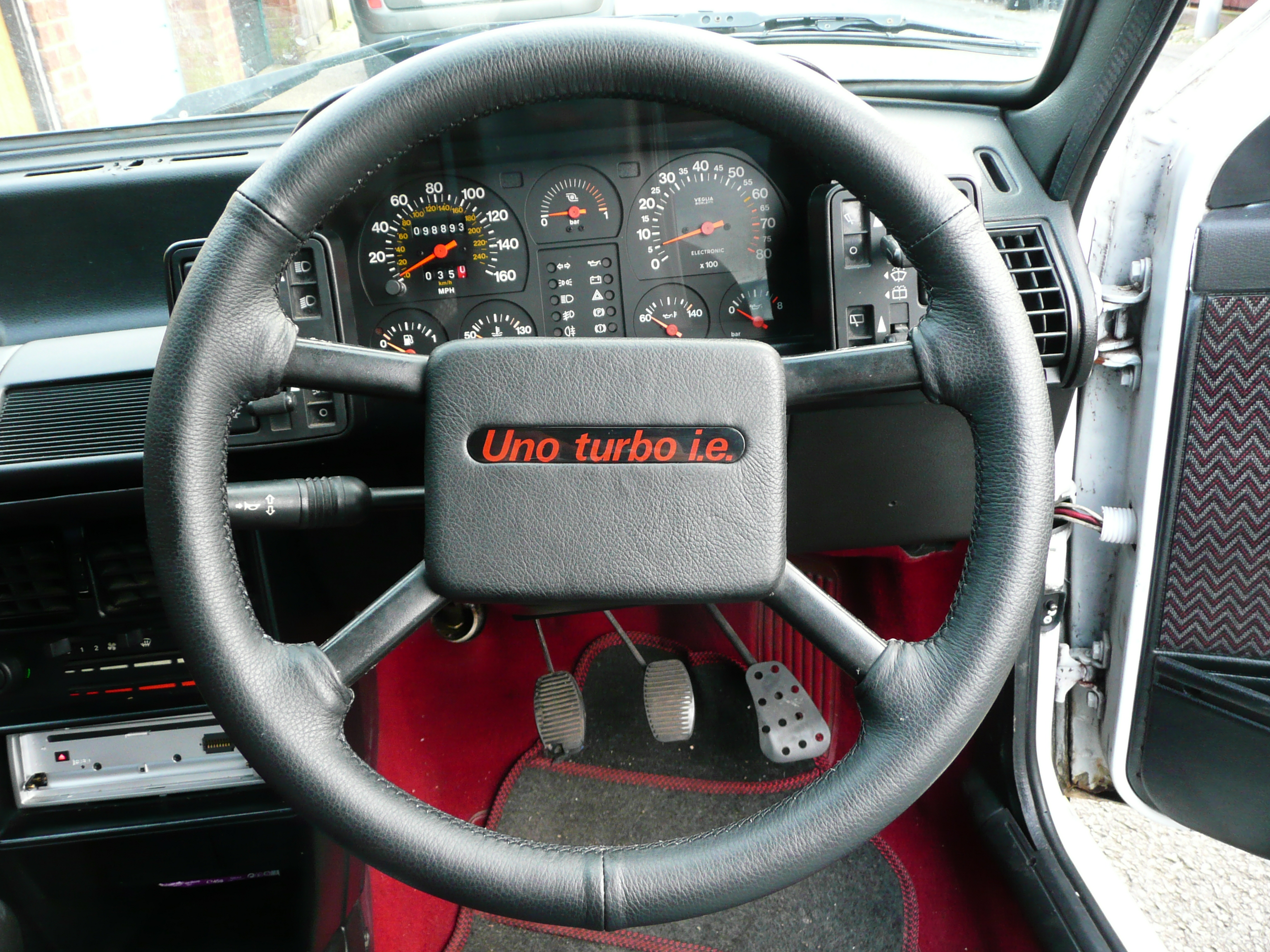

and for good measure, as the mrs was coming back from hong kong via mumbai, i gave her a spare wheel to be refurbed:
£21 for the alloys, £30 for the steering wheel, a good week i feel!
only downer, i did ask for the spokes to be done in white for tippex, apparantly the man said words to the effect "that's a **** idea, no! i have a reputation"...........

Steering wheel looks good! You should show what it looked like before it was refurbed as the difference is quite dramatic.

Now get to work with the paint stripper and the aluminium polish!
We need to see some low-profile tyres on there. I wonder what the correct size is... <five minutes later> http://www.carbibles.com/tyre_bible_pg2.html - 185/50 14 is very close in outside diamter to 175/60 13 (the original size)...

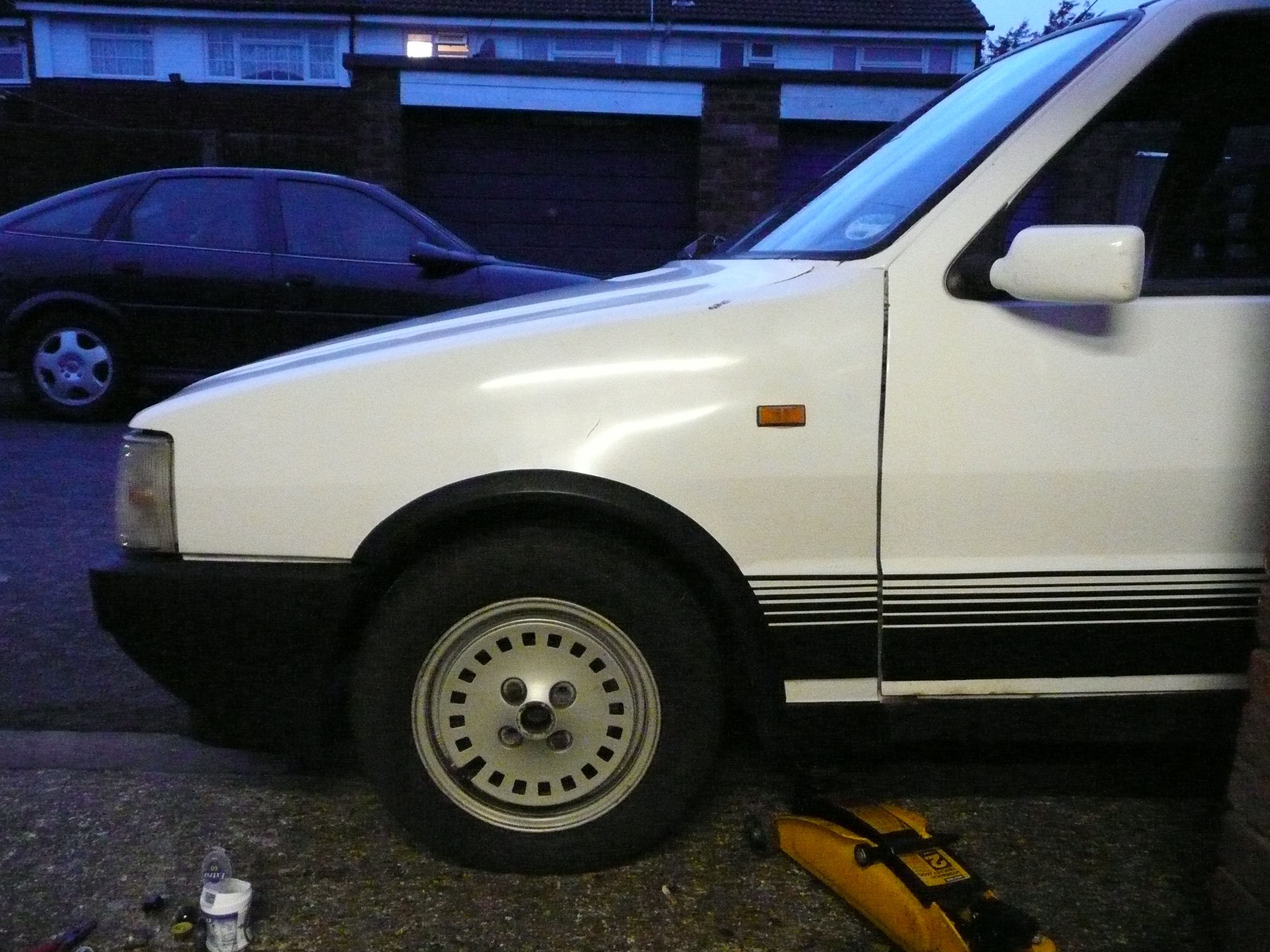

so, i tried on the new additions, just a front corner, but you get the idea:
the lancia wheel has: 175/65/13 on a 13x5
the fiat one: 185/65/14 on a 14 x 6
i think the lancia rim would look good in a painted silver
and the 14" uno/croma/strada rim with black inserts, polished face
i'm very much leaning to that one, looks standard, but subtly diff....
as for the steering wheel, slightly thicker rim to grip on to, oooh errr mr clary, yes the patina has gone, but it's just so much nicer now:)
Those Lancia alloys have been bugging me. I know I've seen them before, so a quick search for Lancia alloy wheels on the 'net and...
...they're from an early lower spec Delta! Or according to the advert, a Saab 600 (WTF?!!!!) Saab did have a joint development with Lancia, Alfa and Fiat with the Saab 9000 being part of the same family as the Lancia Thema, Alfa 164 and Fiat Croma, but I had no idea there was a Saab 600 based on the Delta!
Anyhow, now we know where those wheels came from ;)

Agreed - the Croma wheels get my vote - get 'em polished or machine-turned... consider not having them lacquered - I find that the lacquer takes off some of the polished-aluminium shine, plus it seems to attract/hold brake dust more.
I know you have corrosive elements around but honestly I think that polished alloy washed fairly often will stand up better than lacquered alloy, especially when the salt water etc. seeps through the lacquer and is held against the alloy.
