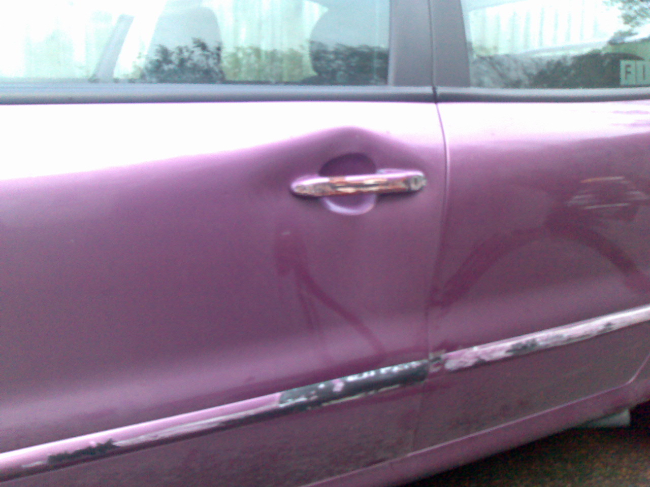

I think my car sensed the vibes that I was looking to buy another, so today when I went to pick something up down a narrow bumpy lane and was paying attention to not hitting other cars, not bottoming out and avoiding random bollards, I managed to hit a big post and dented a door, broke a door handle, scraped another door, broke a bump strip and generally scratched half the car :cry:
It's booked into a bodyshop in Wigton on Monday with the best rep in the area but I know it won't be cheap. So that's christmas cancelled and half the deposit saved for the new car scrapped then :bang:

thats crap luck. bless ya. its at times like this you wish you had a standard colour. will you be able to get paint the exact same colour ok?
It is a standard colour - Lamborghini mauve and easily available *phew* :). Thank goodness I didn't go for a fancy colour. I just feel so dumb :bang:

It doesn't look ridiculously expensive, providing there is no damage to the A or B posts its just panels, 350 pounds should see it repaired including materials. That's assuming its a straight metallic paint, the fact its off another car makes no difference.
If the door is badly stetched get a used one, obviously because of the special colour it will need painting inside and out, which adds to the cost. As a rough guide a single panel should be no more than 150 pounds to paint in a standard metallic, including material.
They should be able to lose the damage to the rear arch without painting the whole wing. Generally what you do is paint part of an adjoining panel anyway, and gradually fade out the colour so any minute differences are lost to the eye.

Thanks for the advice (y) The damage to the door is just where the handle got pushed in and I'm hoping it will just pull back out. The only slight problem being the door mechanism seems to have broken and it doesn't open :bang:
