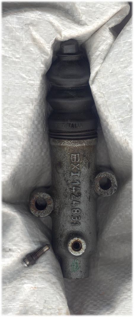

:rolleyes: I have had a slow leak on my clutch slave cylinder for some time now. I have acquired a second hand slave cylinder. I am cleaning it up, and I’m about to soak it in clean brake fluid over night, ready to fit tomorrow.
Will it be OK to soak the rubber boot too, or should it be removed first :confused:
Also, I’m wondering if DOT5 brake and clutch fluid will be better than the recommended DOT3 :confused:
:eek: Funny there is no recommended service interval for replacing all the clutch fluid. I guess I may as well; surely it degrades over time. I presume this will extend the life of the Clutch Master Cylinder, or could I be opening another can of worms?
As you can see I was successful with the 7MM Bleed screw ;)

I haven't heard of soaking the cylinder in brake fluid before fitting, although the fluid won't affect the rubber boot. I would probably have taken it apart and greased the seals with rubber grease - also check that the bore hasn't rusted during storage? Anyway, it would probably be fine if you just bolted it on.
Good to see you got that bleed nipple out - obviously it has suffered from some salt spray! Might be a good idea to fit a new one, rather than risk it seizing in the future. Depends how long you'll keep the car!

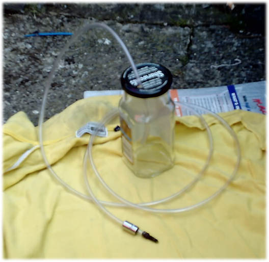

Air should always find its way to the highest point in the system - so when I bleed my brakes, I just attach a tube with the end lifted above the level of the master cylinder. Keep putting fluid in at the reservoir, and you should see the bubbles work their way through the bleed tube, up and out - without getting sucked back in. I think it's important not to slacken the bleed nipple too far, in case air gets in around the threads.
I do the bleeding single-handed in this way. I use DOT4 brake fluid - it is cheap compared with the risks of ineffective brakes - so I'm careful to pump through plenty of fluid to convince myself that it's changed and air bled out. Brake fluid is also water-soluble, so I think it dissolves harmlessly if poured in the garden. I hope!

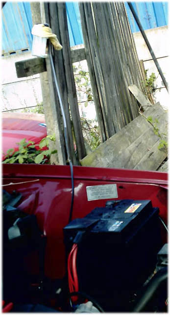

:) I will try the up hill bleeding technique – Pet shop is next door to motor factors – so a couple of meters of fish tank air line added to my list.

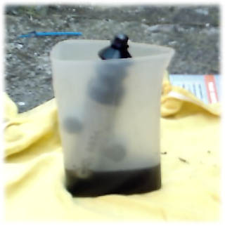

All this dirt from 1 cylinder?

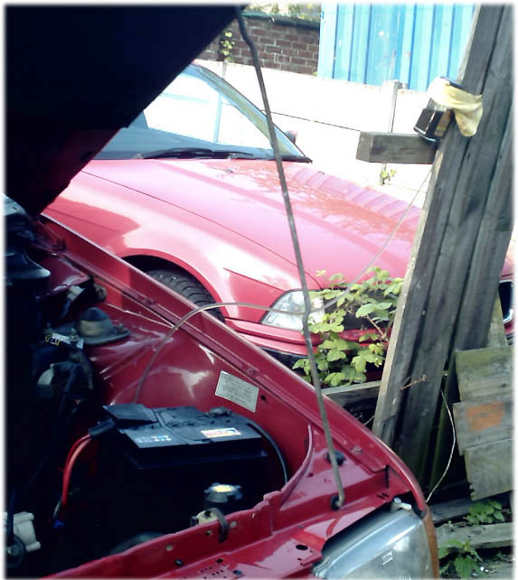

I decided to bleed all the mess through before changing the cylinder.
Alex the up hill thing works fine (Rep awarded :))
LOL I wonder if FIAT fitted black fluid as standard – I reckon this is the original stuff.

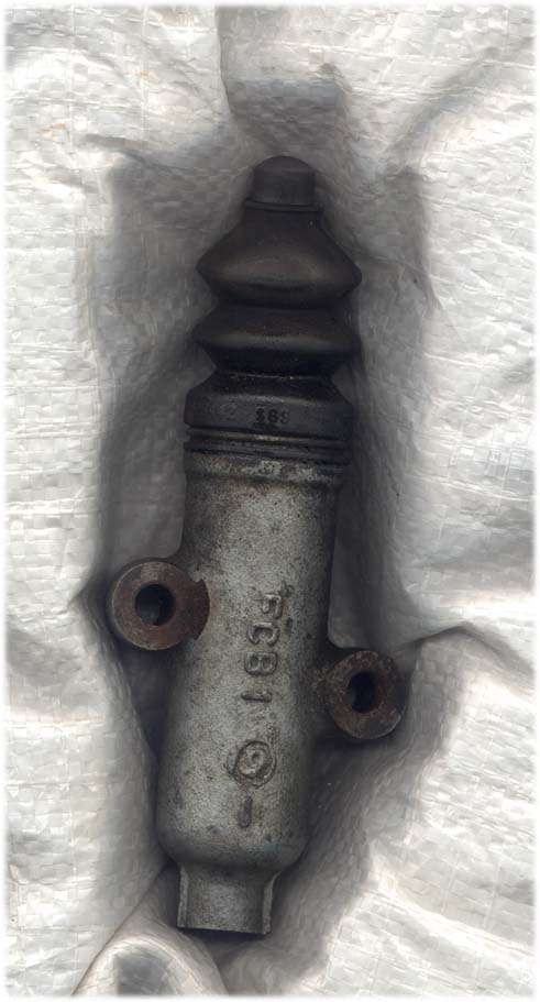

How dirty?

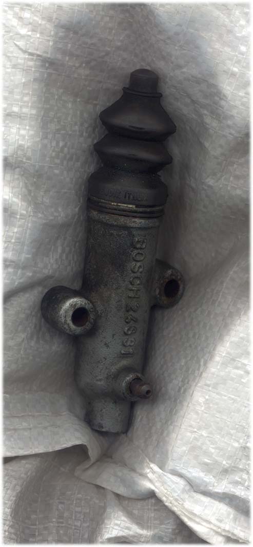

I found the slave cylinder fitted with half-inch bolts – :rolleyes: not 13MM.
I believe the Bosch cylinder I fitted is an aftermarket version. This is the old one.
:cool: Regards All,

I think it's normal for the master cylinder (in a hydraulic system) not to have a bleed screw. I like the method shown for holding down the clutch pedal. I use a jack handle with the seat brought forward. Did you find there was a continuous flow of fluid with the pedal held down?

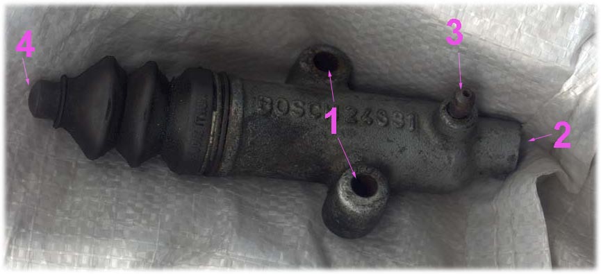

If it’s the same as mine, to remove the slave cylinder:-
Soak bolts 1 and 3 with penetrating fluid of WD40
Undo the two bolts holding it to the gearbox (number 1 on attached diagram).
Have a cloth ready to mop up spills, as clutch/brake fluid will ruin paint.
There is a bolt holding the rigid pipe onto the cylinder (at point 2 on diagram). Grip this with a spanner, and twist the cylinder till it’s free of the pipe. Mop up any fluid that flows out.
Fix the new slave cylinder to the pipe (again holding pipe still).
Introduce cylinder ‘tip’ (4) to clutch arm, align cylinder and bolt (1) back on to gearbox.
Bleed clutch.
Fit a fish tank airline (or similar) to the bleed nipple (4), feed the other end up hill to a jam jar.
Top up clutch reservoir with fresh unshaken Brake/clutch fluid and replace cap.
Unscrew the bleed nipple about 1 turn.
Press clutch and jam down (or have an assistant hold down).
Re tighten bleed nipple.
Un jam clutch peddle (or assistant to release).
Repeat above 4 steps, topping up reservoir after 4 reps, until you see clean bubble free fluid in the pipe. Be careful the pipe stays in place, and the jam jar doesn’t over fill.
End with a tight bleed nipple and reservoir topped to max line(with cap on). Kink the pipe and remove it. Mop up any spills.
