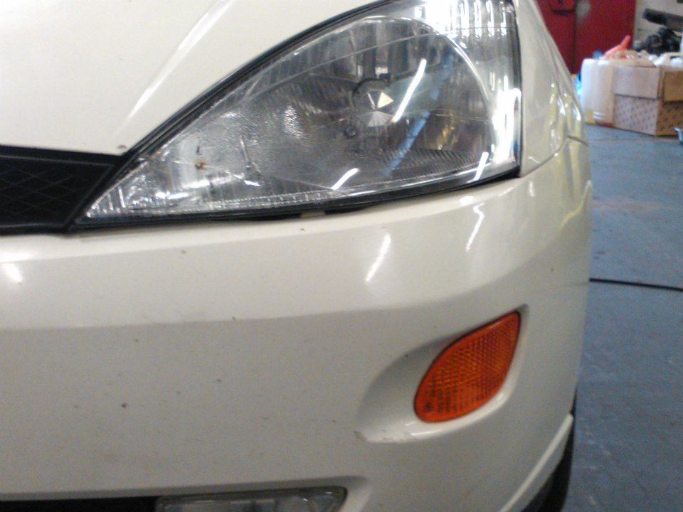

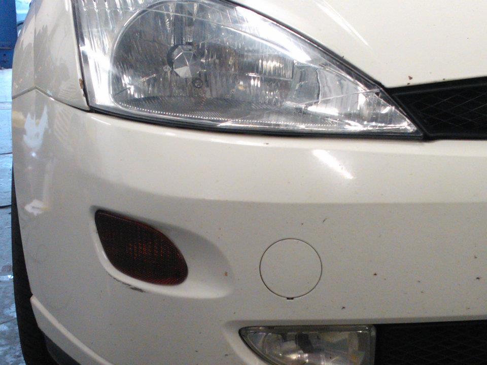

But then again if you do want to do it there is tinting films available that you can do yourself (with youtube clips for techniques and help) or myself i flatted the lense with 1200 wet n dry and added a small amount of black bascoat to lacquer and sprayed them
attachment.php
not the greatest pic but you can see what i mean

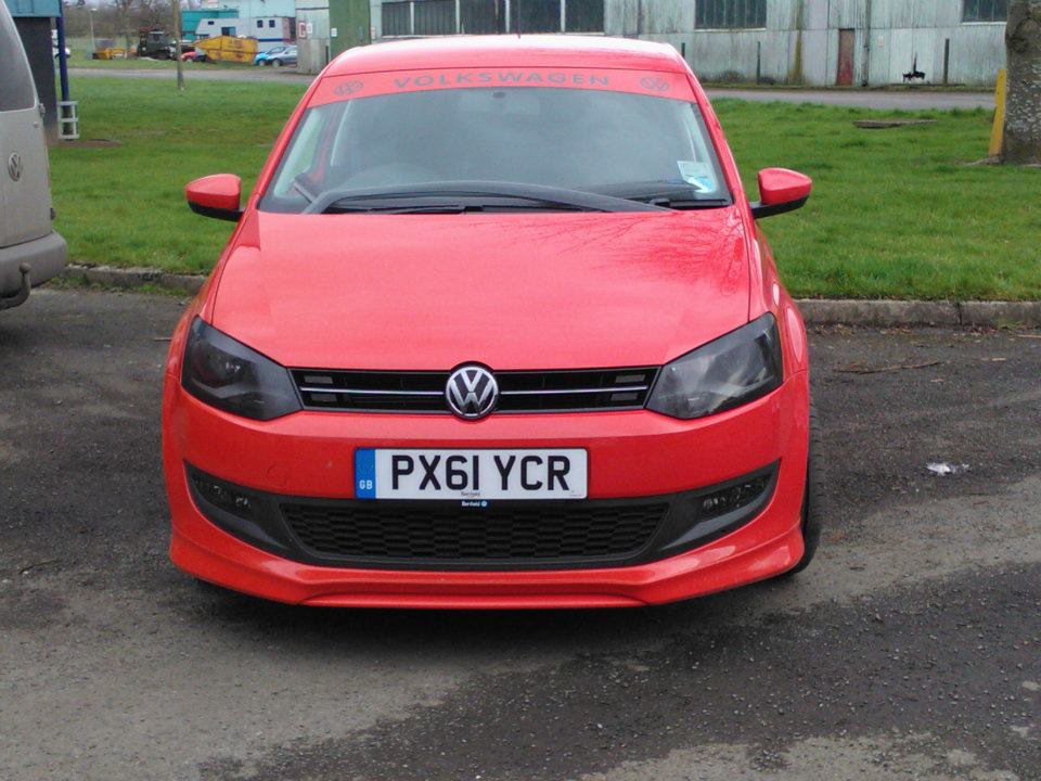

what about this then does not reduce the light that gets through but does darken the lens best of both i have some pics of rear lights tinted too but not on this pc :D btw this is fli eye and i can supply it too(y)
