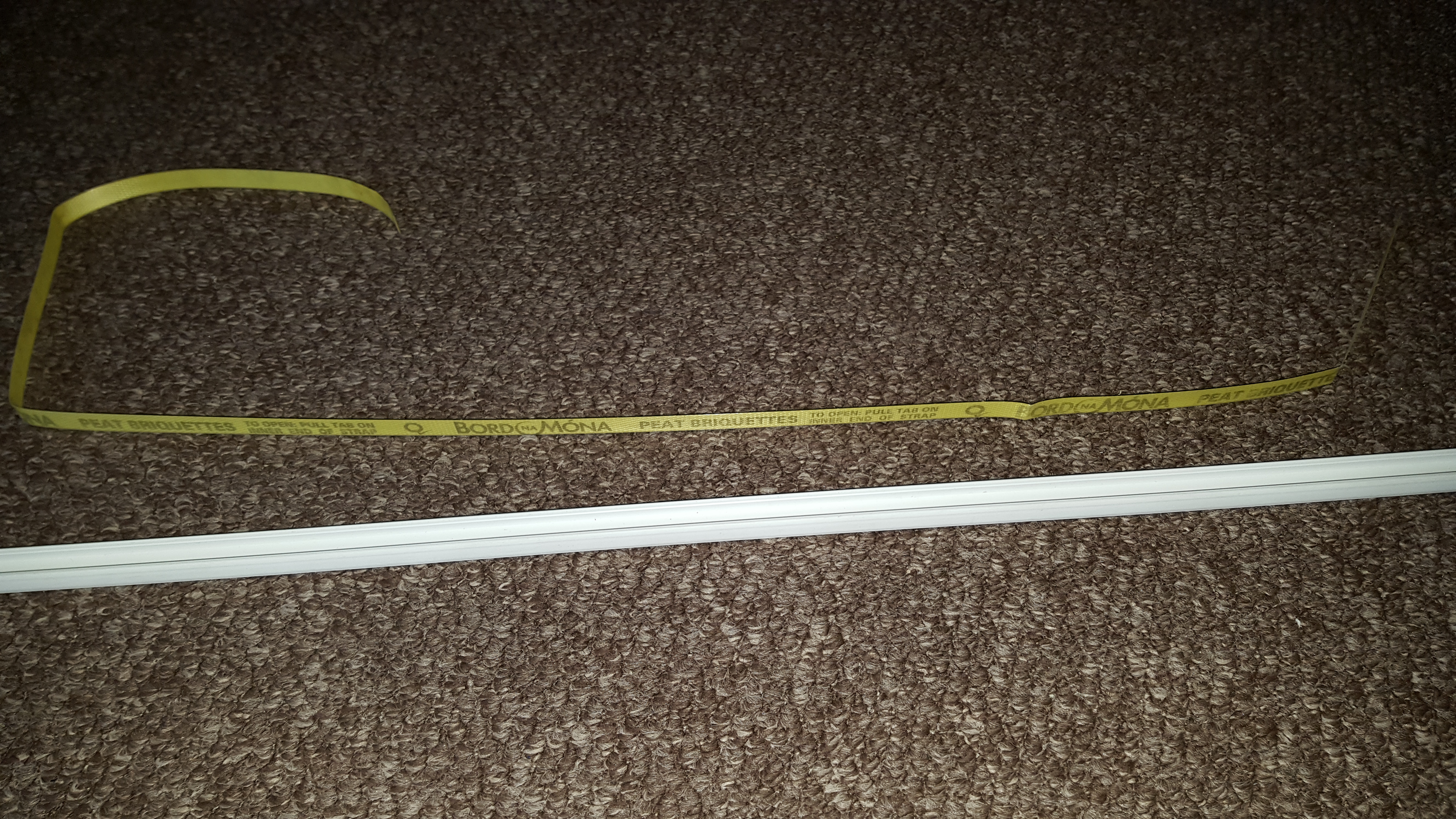

You need to obtain a length of that plastic strapping tape that's used for bundling large packages together and also a piece of rigid PVC that can be cut to make a short 'blade' I'm using a piece of 10 x 16mm mini-trunking.

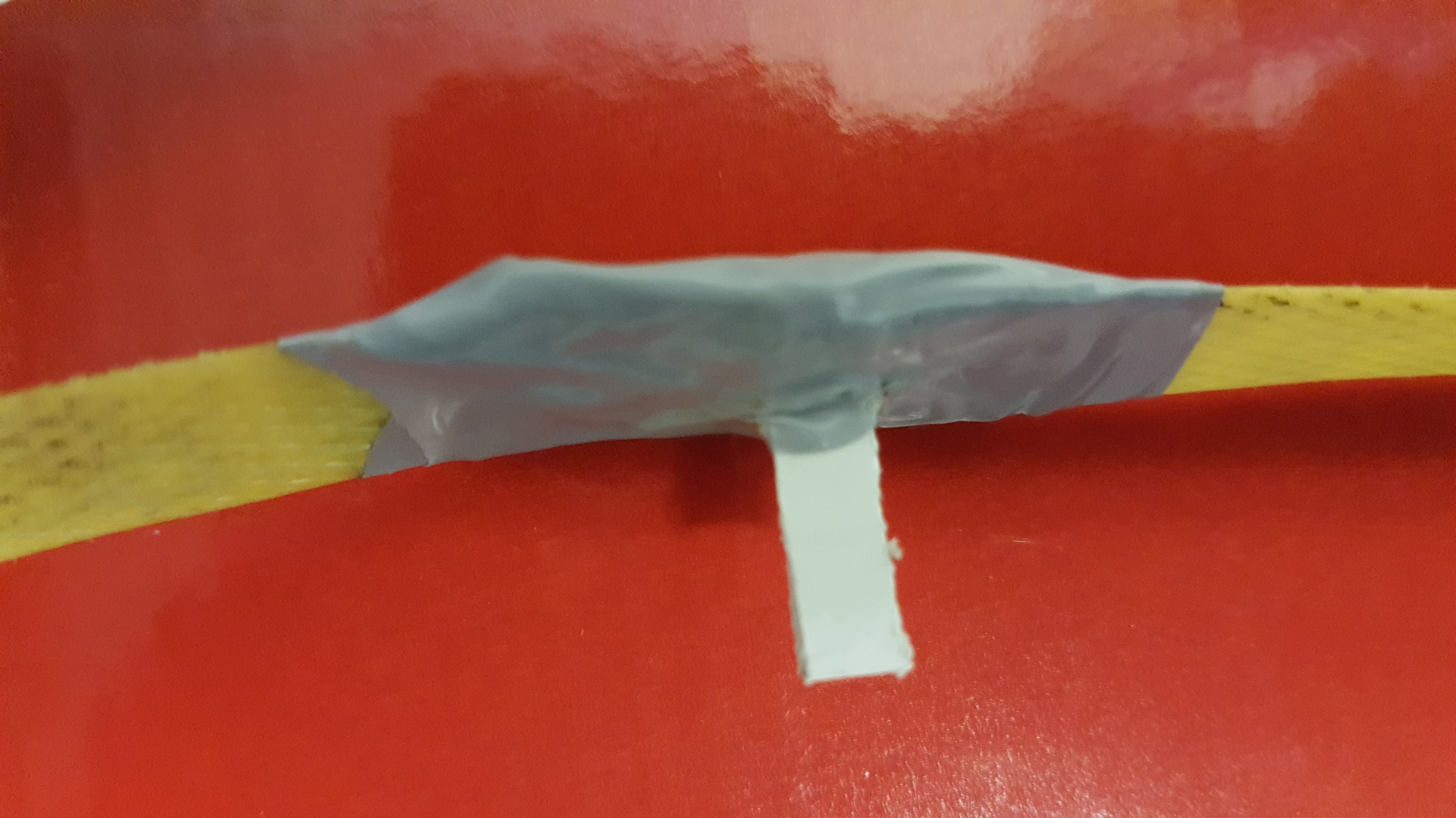

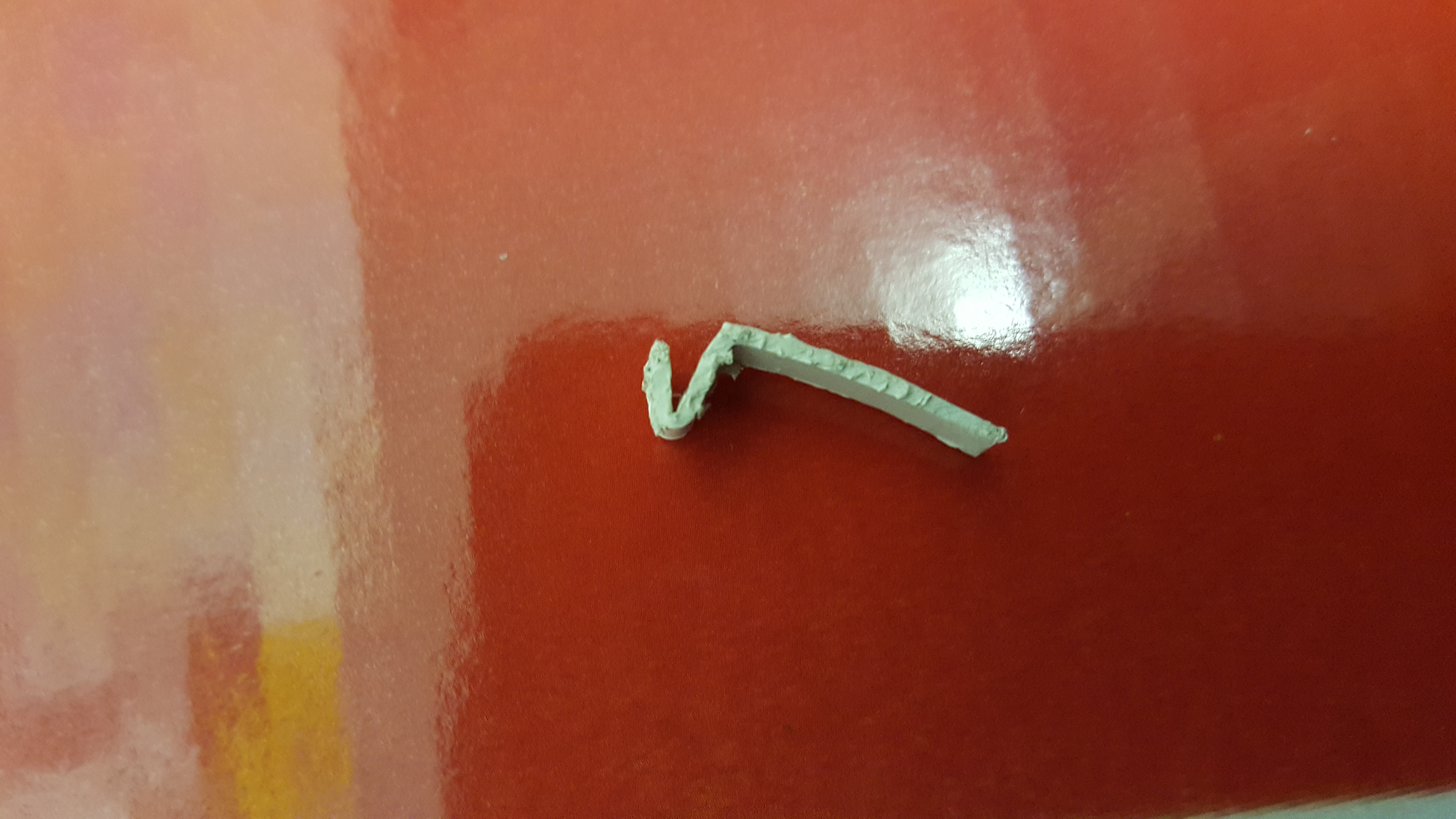

Take a small 'L' shaped cutting (4mm wide) of the mini-trunking and bend the shorter side over on itself, place this about half way along the strapping tape's length and then bind the two together using insulating tape. When applying the insulating tape, stretch it whilst binding it around the strapping to be sure that the plastic 'blade' that's now been formed is well held into position, the 'blade' should be in the centre of the strapping tape so that when it's being pulled against the barrel release catch it doesn't slide off to one side and lose its full effect. I tried superglue as well as the insulating tape but the glue didn't have any benefit. The blade should be 4mm wide and about 12mm long, this worked for me; you're trying to replicate the blade of a screwdriver that would normally be used for this task.

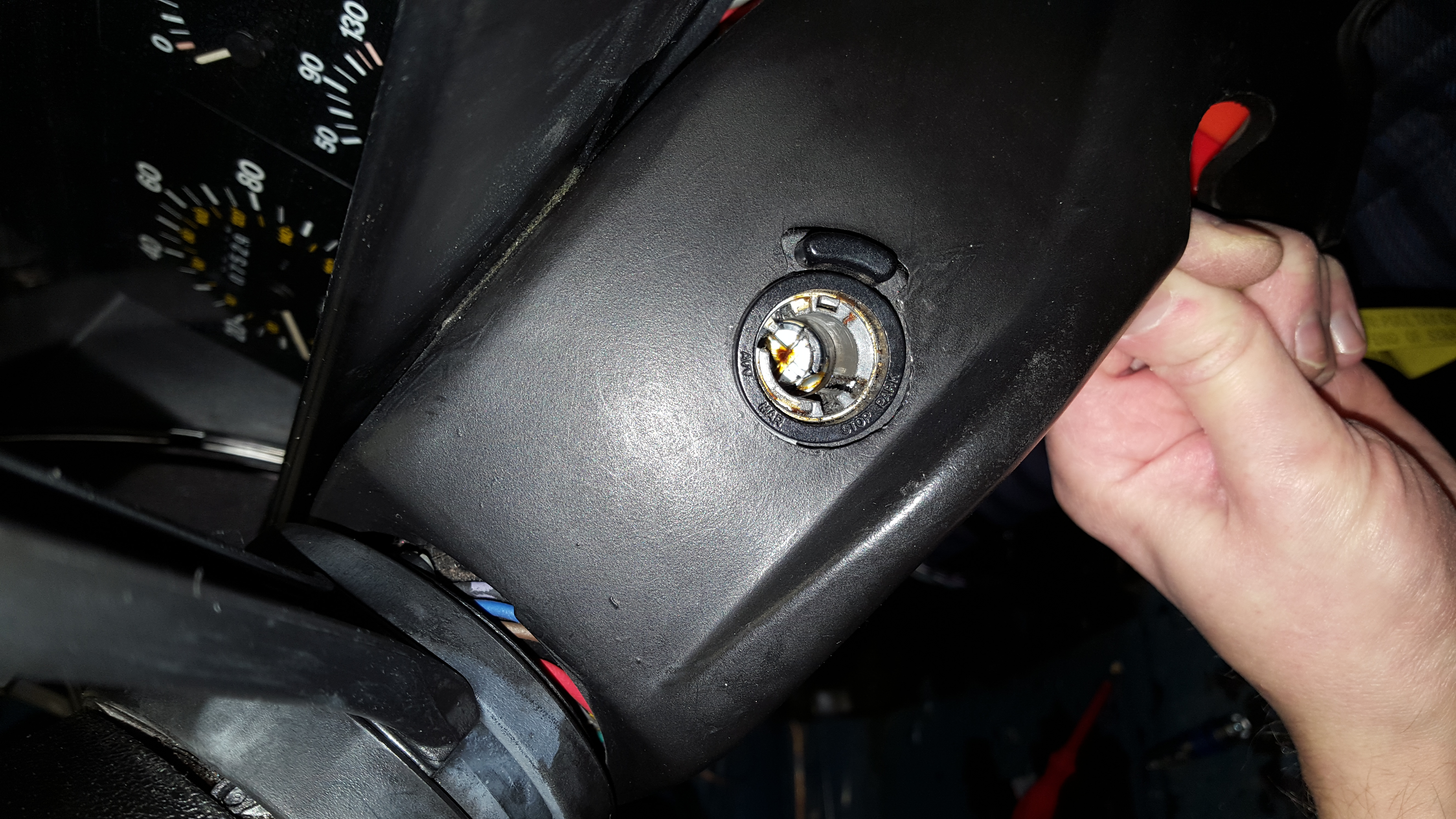

Insert the key into the ignition and turn to 'Mar'. Whilst viewing the barrel housing from below the cowling insert the strapping around the barrel housing and gently manipulate it until the PVC 'blade' is felt to go into the slot containing the release catch, once you feel it go in pull firmly on both ends of the strapping whilst rotating and pulling the ignition key to release the barrel; insert the new barrel with key whilst you still have the tension on the strapping keeping the release catch open. Be careful to ensure that the new barrel is aligned the same as the old one when inserting it so that the two lugs on its end are aligned with mechanism within the housing.
