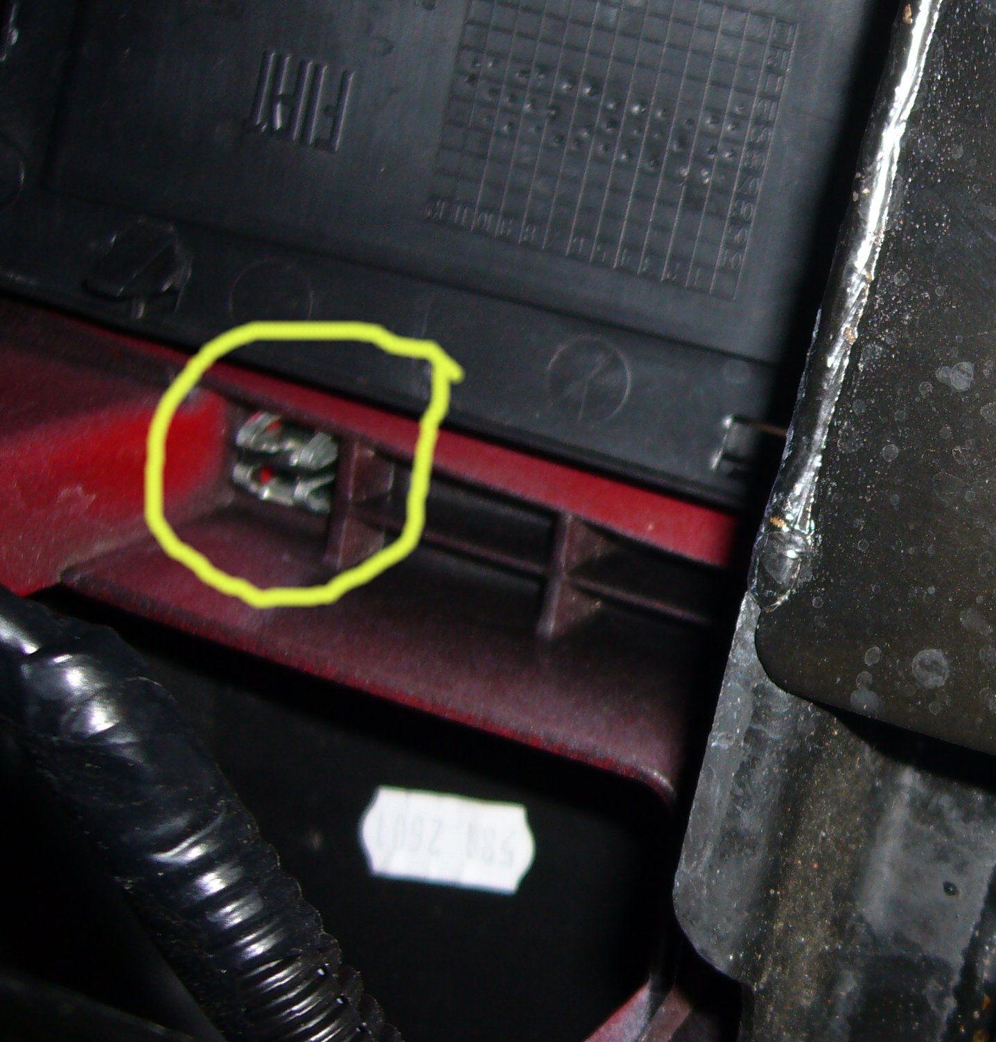

I can feel something similar where the front chrome inserts are attached. I've poked a camera where the sun doesn't shine & attached a picture.
Personally I'd say it's a bumper off job if you want to remove these without breaking anything. Looks straightforward but I guess it needs 2 people if you don't want to risk scratching it.
Breaking it getting it off doesn't bother me too much as it's dented already.
I was thinking more about cracking the bumper. If you look closely at the rear, some of the tabs attaching the insert have been heat 'welded' & don't look like they'd give up without a fight.
Had to do this the other day. Pop a flat bladed screwdriver wrapped with some insulating tape or something of that ilk (or use a trim removal tool) behind it on the vertical part nearest the numberplate. Lever and voila, it comes away.
There is a small bit of sticky something in one part, but as far as I can tell isn't necessary and doesn't provide any real resistance to removal.
