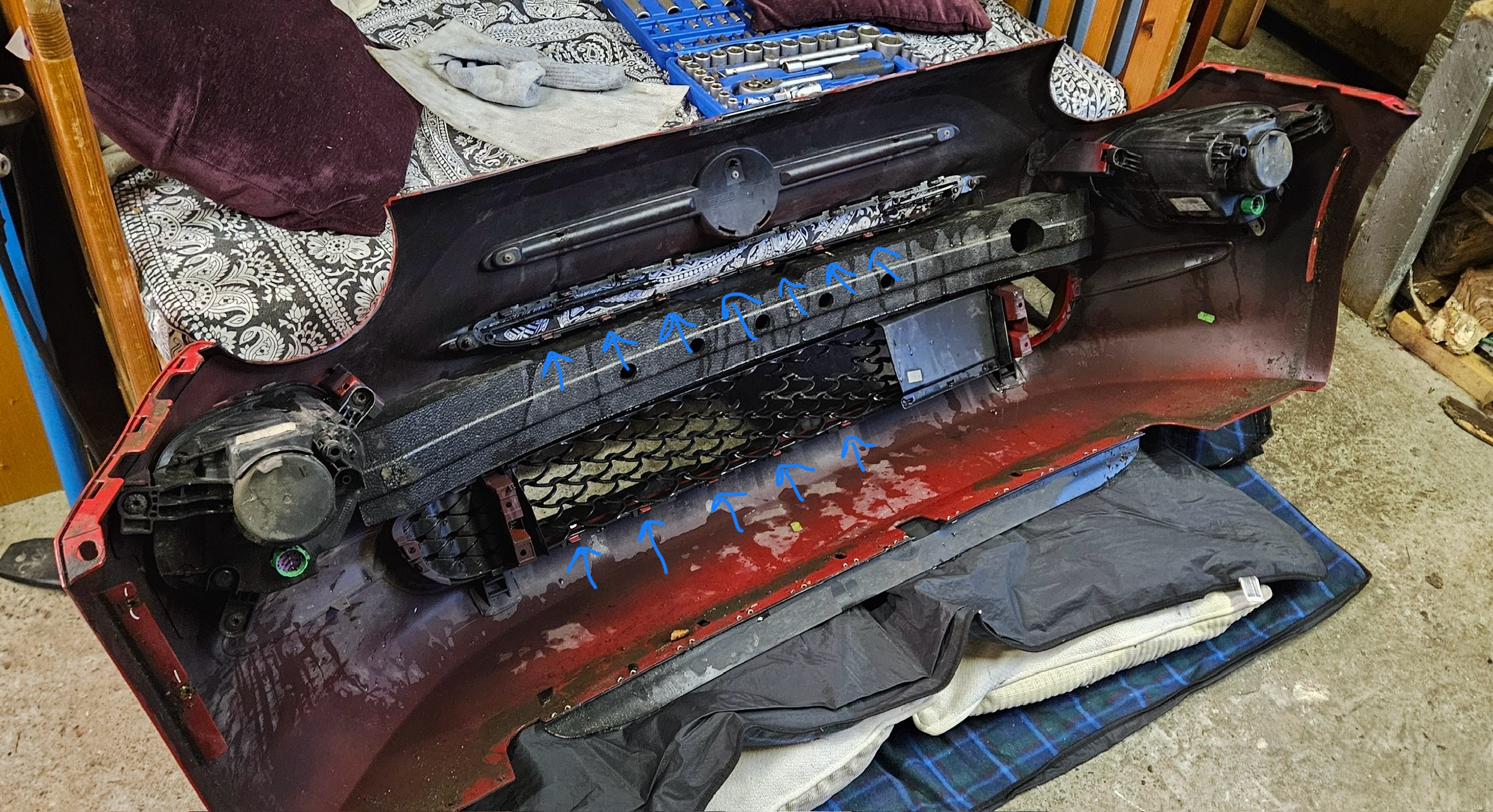

Hey everyone,
Does anyone have any tips or tricks for removing the trim from the front bumper?
Specifically the parts in yellow - seems like they have teeth from both the bumper and the trim and I'm struggling to get them out.
Also the bumper lights - T30 screw similar to the bumper too right?
Thanks

Sorry I should have been more clear, the bumper is off, the trim is just being tricky.
I used a plastic trim removal tool and pushed it into the clip openings to separate the parts while pulling the broken trim off.
