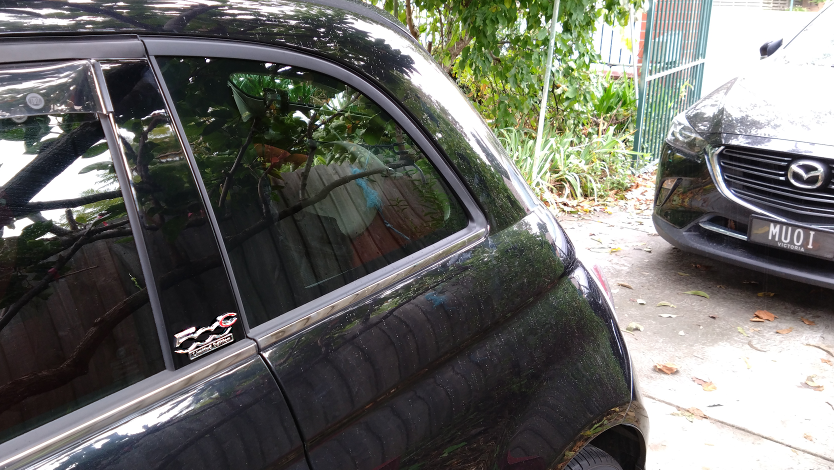

Just to return to this briefly; after a two month wait the new window finally arrived and was fitted yesterday;
Tomorrow I have to take it to have the new glass tinted to match the rest, then it's job done!🙃
As a side note; reading the part description it appears the window, rubber and chrome strip are all one 'part'. With the likely cost of that I'm relieved it was an insurance job!

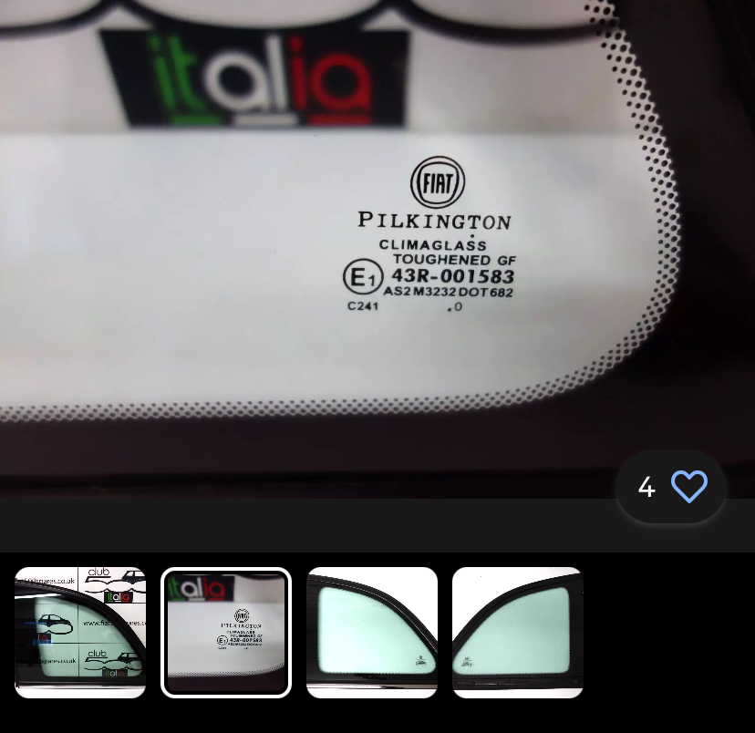

I suspect the difference in part number on the 500 is due to the trim along the edge of the glass rather than any change in the glass itself Chrome as in the pictures above or non chrome on cheaper/older models.

I had the car tinted shortly after buying it, with the door windows as dark as is legal and the rear ones as dark as the installer had to hand.. With the UV levels here it was important to protect the upholstery, not to mention the occupant! It's possible Oz-bound cars have a higher level of tint but in every other respect they're basically identical to UK cars so I doubt it. So far as I can see the only window choices were Lounge, with chrome strip, and Pop without.
The etched markings in the bottom corner are identical to the old glass on the off-side except for the last number at the bottom; ".2" on the old and "3..." on the new.

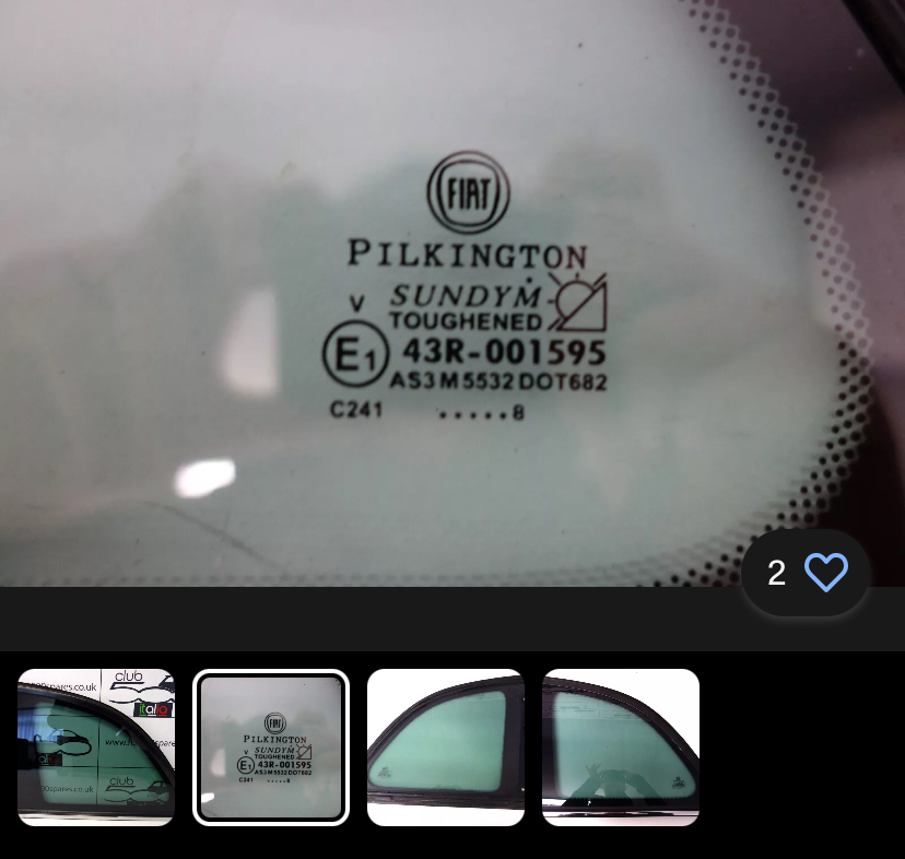

This number appears on both the left and right quarter lights with (as shown below) and without the aerial so has nothing to do with being any specific part number for the window
i believe the 8 with the dots (from memory) is year and month of manufacture.

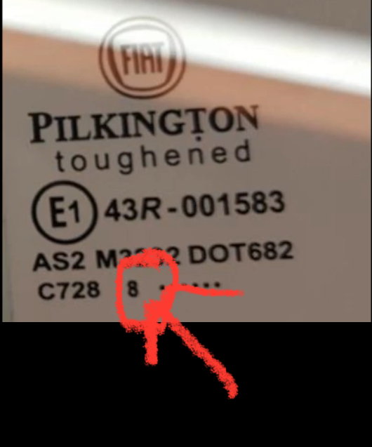

what i couldn't find out - despite mailing pilkington and ringing i think, was the difference between c241 and c728 - i suspect that is a tint code
No the 8 is the tint code that comes from a fiat 500 specialist on eBay, easy to track down just search eBay for fiat 500 rear quarter glass, you could even message them to see what they say, there are multiple levels of tint not just two
Tint code 0 and tint code 8 the C241 remains the same

I concur. Here's my full set;
My car was built 10/2012 and all these, bar one (lower left - the new glass), have a '2' or '12' in the last number leading me to believe it is a date code. My car does not have the DAB antenna of course.🙃
