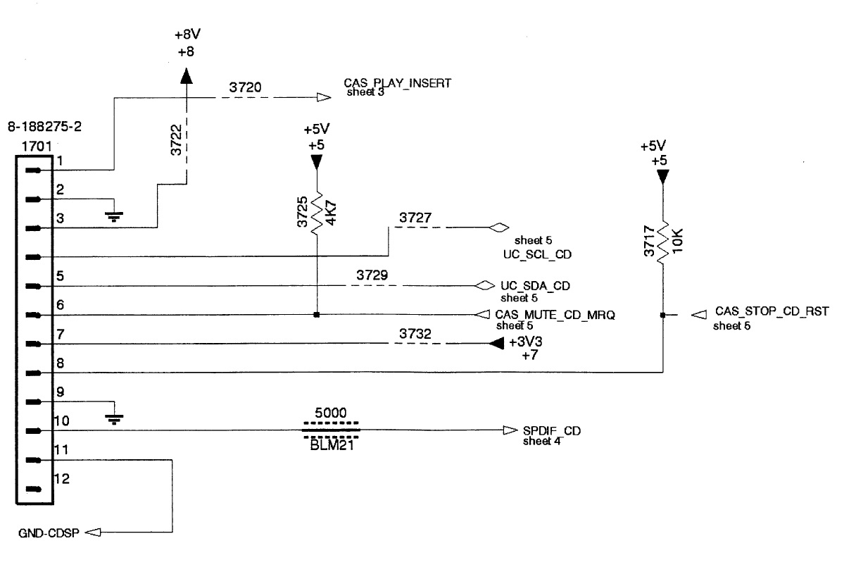

I think i may have found something, it is a datasheet from a megane 1 HU that uses the same Philips CDM, so here are the CDM-M3 4.4 pinouts.
I've connected pin 4 - 5 and GND, the only thing it did, was that the HU stopped working, no sound coming from the speakers...i didnt use a silent cd...
Maybe it has something to do with pin 10... I have no idea, maybe someone can help us out ...
  • renault-22dc279-62.pdf
This kind of explains why it didn't work with the sda scl ...
Is it just possible that CDC line to HU is SPDIF?
I am no expert, but the 12 pin connector connects the CD player to the mainboard.. dont know if the CDC line passes through the CD player? but this could be the solution...
Let's see if i can find a RCA-SPDIF convertor in my ghost town....
The audio signal from the CD unit to master unit goes through SPDIF protocol.
For external mp3 player you will need analog to SPDIF converter.

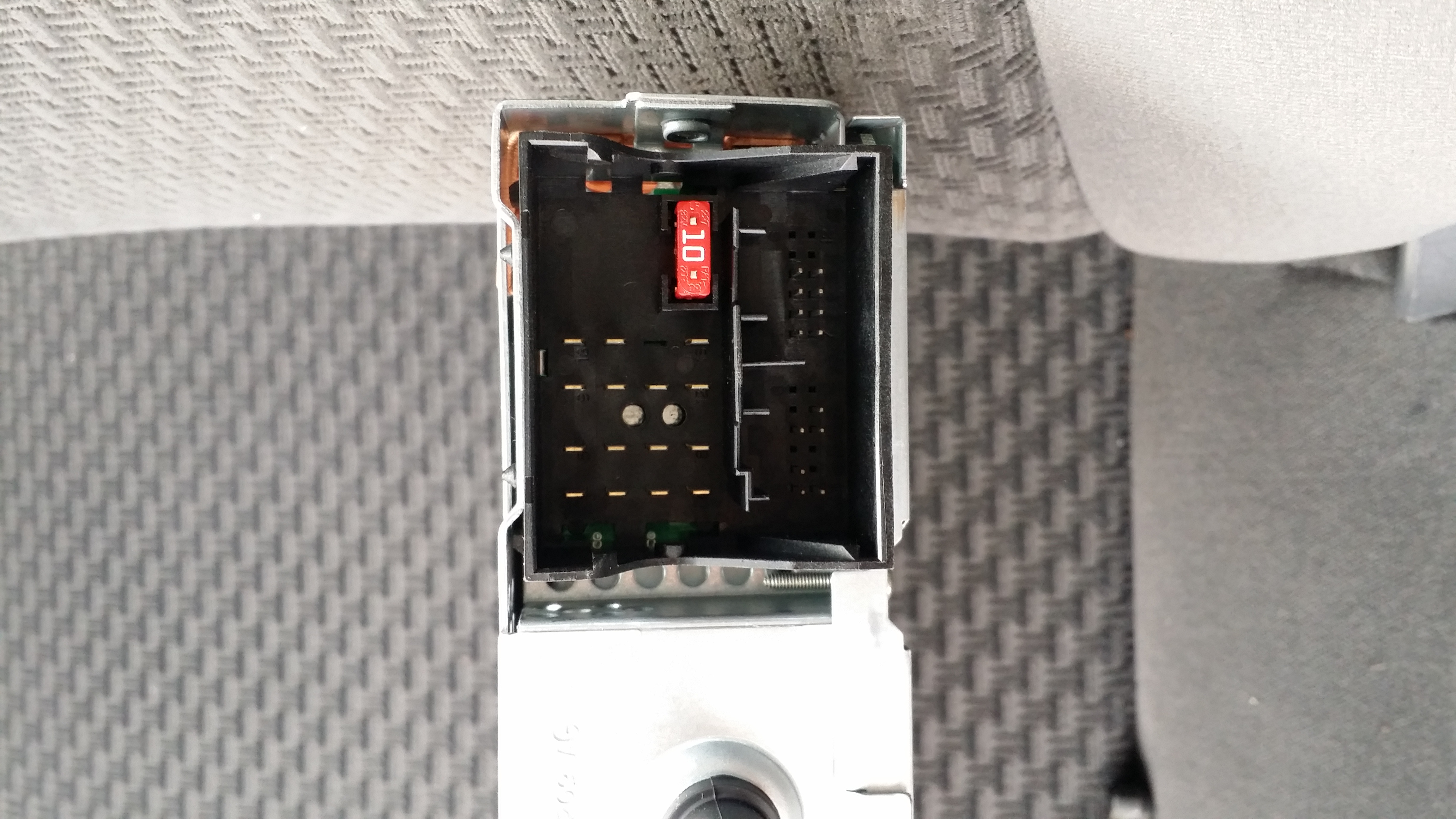

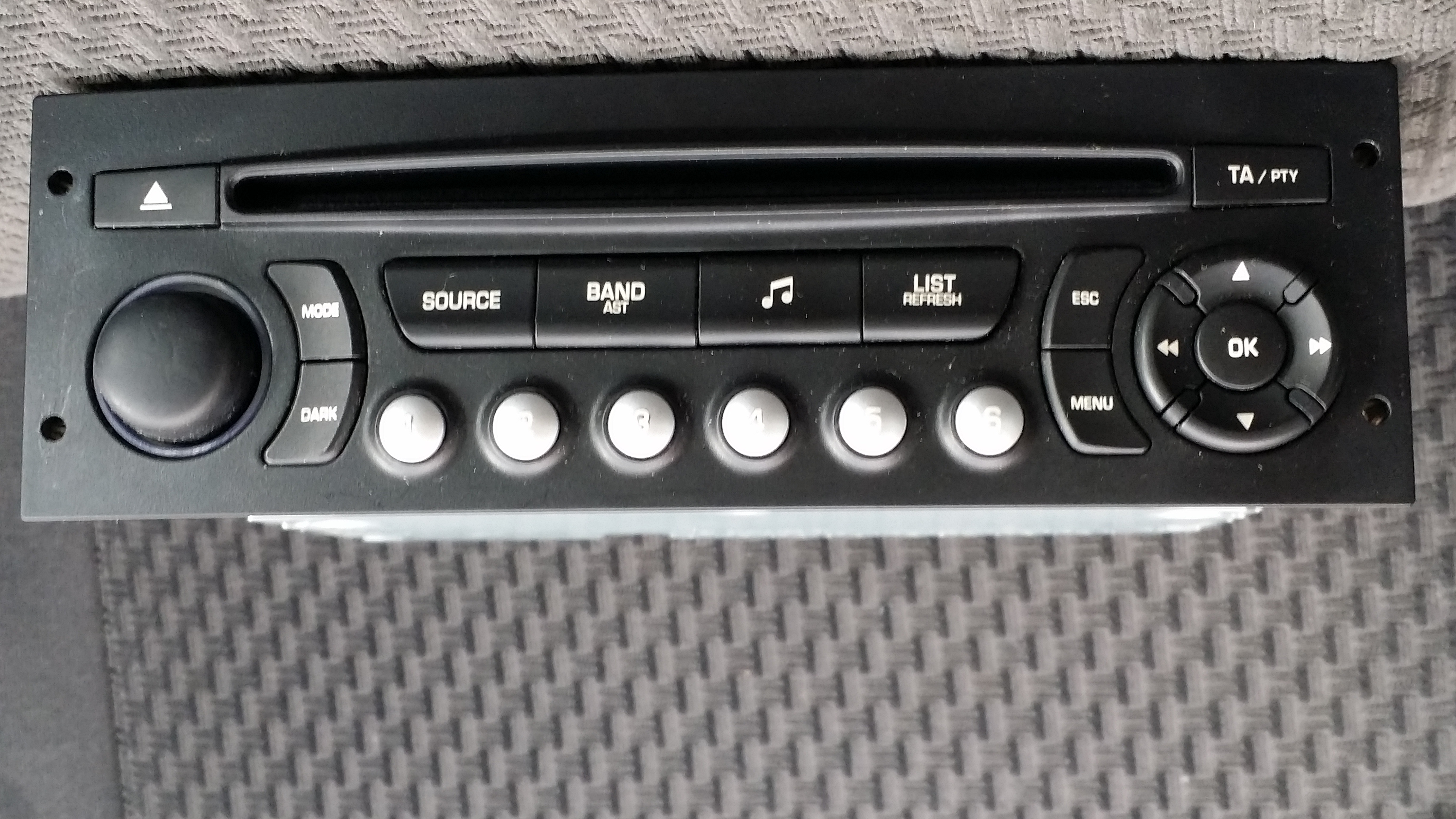

how do i mount a aux into this unit? Fiat scudo 2008
