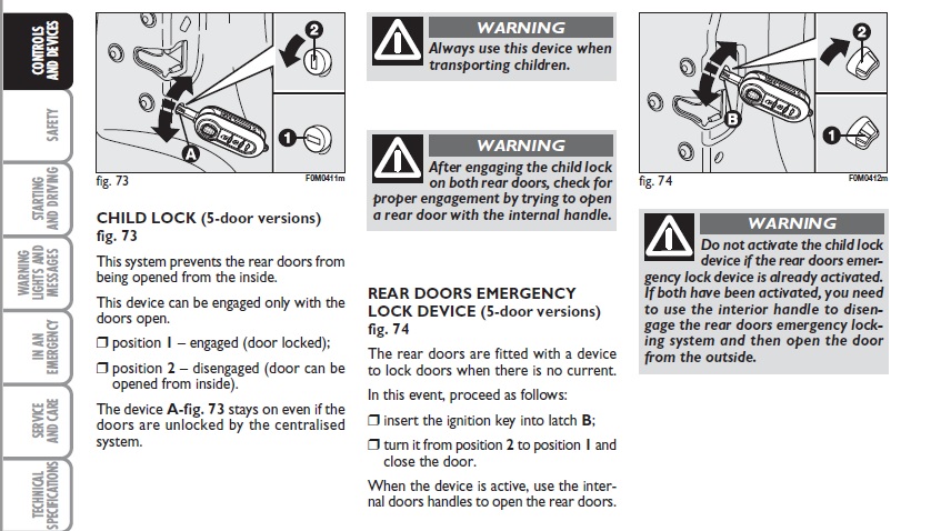

I’ve got a dead battery on an ‘09 Grande Punto 1.4. Whilst the key unlocks/locks the front driver door perfectly fine, I cannot find out how to lock one of the rear doors so the car is unsecured. I’ve searched but can’t find anything.

I'm not familiar with the Grande, but most Fiats move the inner handle inwards as it locks. This can be done manually on any door when shut. Lean through from the front, push the handle inwards. Repeat for all doors as necessary, then lock the driver's door with the key. Handbook should show this.
At least with a dead battery, it won't get stolen.
Edit: Found this page. If you don't have a handbook, download one here: https://www.fiatforum.com/downloads/grande-punto-handbook-07-10.336/
How on earth did I miss that in the manual....... I just looked again and it's there staring straight back at me, arrgghhh! Thank you very much, that worked perfectly!
