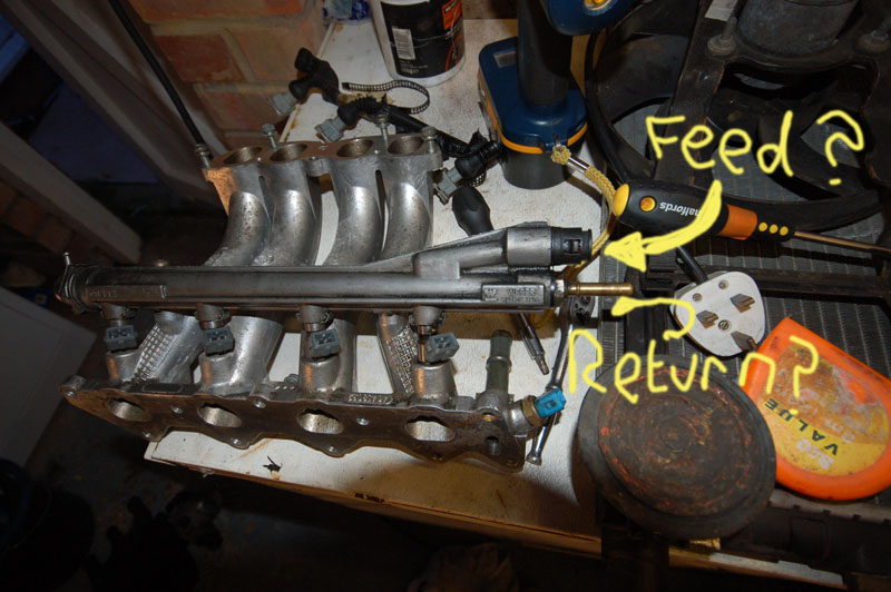

anybody knows which fuel pipe is for incoming fuel (IN) and which one is outcoming (OUT)
in 1242 16V Punto engine (MKI)
Thank you!!
