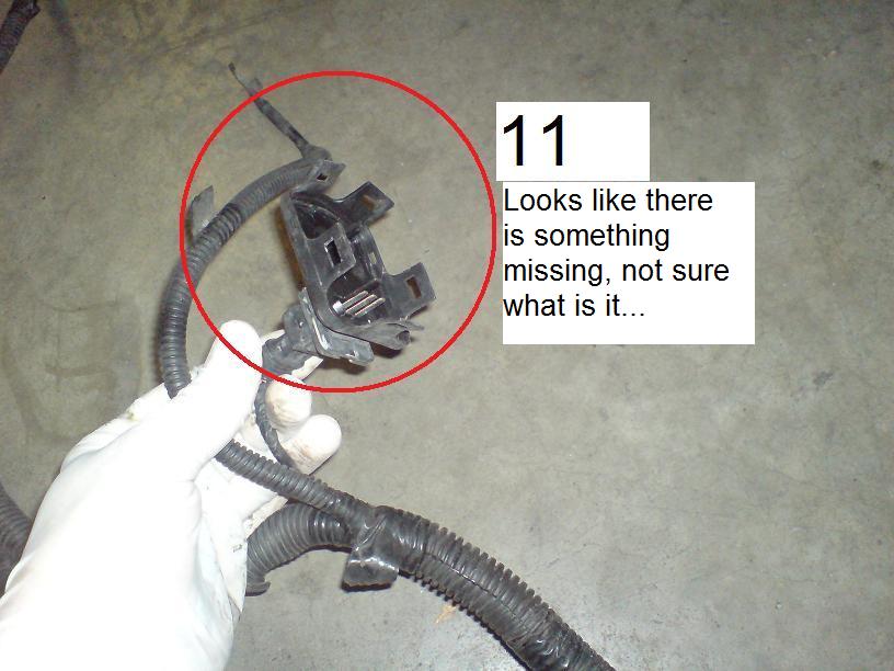

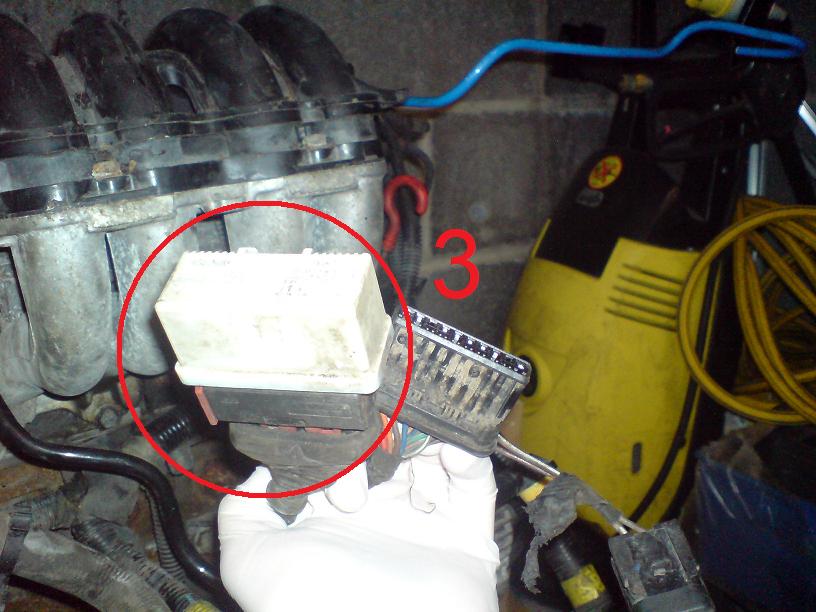

Yes, There is all loom in the engine, but I've got some more wires and I'm not sure about them...

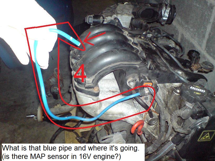

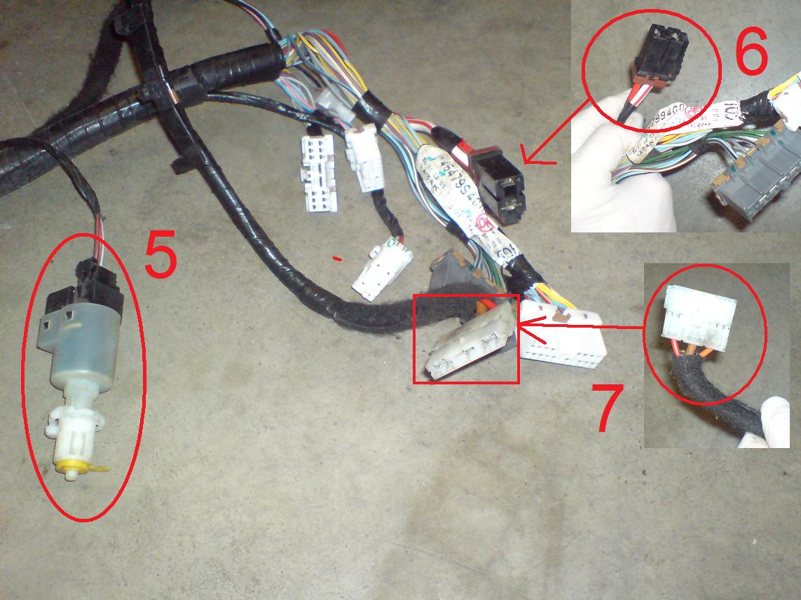

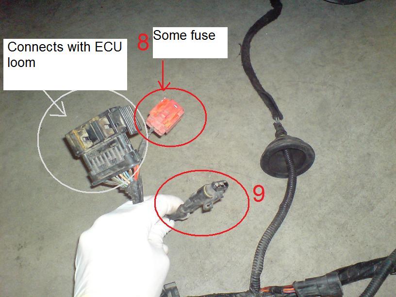

Can you recognize anything on pictures(with numbers)?
Jakub

Thanks....I'm going just to fit all wires for engine, I'm not going to fit Puntos clocks, but I've got all wires even from inside car and I was thinking if it's something important:)...There is also two connectors from inside car (the same picture no 6&7) which look like ignition connectors. I though that it could be easy way to connect 12V+ somewhere there...(they are red(big)white(big) brown, red and orange)

item 3 is a relay block and you should keep that.
item 4 goes to the charcole canister via a relay (mounted next to your pandas map sensor I believe)
The punto engine has its map sensor built into the throttle body.
items 5,6 and 7 are all dash connctors.
The connector in picture 6 is the one that I have mentioned in the 1st post in the list of wires to connect to the panda. I removed all the binding from that part of the loom and cut out the wires I did not need.
Out of number 7, the 3 bank (red red and orange) the center red will be constant 12V +ve, and the other red will be the starter motor, and the Orange will be ignition feed (sparks ECU). It also looks like it will fit straight into the Panda's igniton barrel (y)
The other ignition cable will be for things like headlight, wipers, and all key controled electrics (y)

Had another look. Number 9 looks like crank shaft sensor, and 8/the fuses are probably for...Was going to say lambda pre-heater, but should be a relay also. Wait a min, will just check in punto section, cos read about them the other day I think :p
EDIT: Here's link to what fuses may be; https://www.fiatforum.com/punto-technical/161609-punto-fuses.html

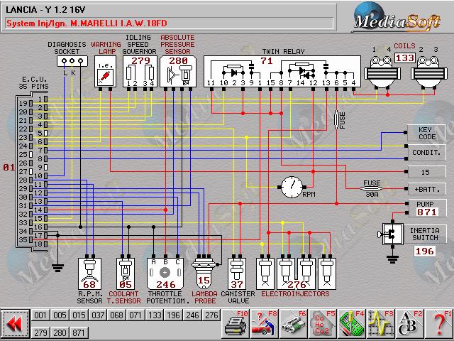

I've just found some ECU scheme (looks like 1.2 16V but from Lancia Y10...on Punto forum said that it's also Punto)
That's the one, the 18FD(y) (for historical note the lancia Y is based on the punto and is not related to the Y10 which is panda based)
