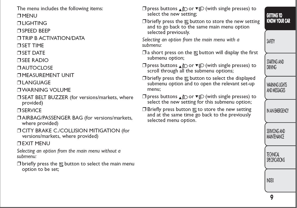

If it's the doors locking when the car is in motion, there's a description of how to enable/disable it on pages 12 & 13 of the handbook (download from here if you need it).
The function you need is AUTOCLOSE. It's described in pages 8 to 10 and 12 to 13 of the handbook.
