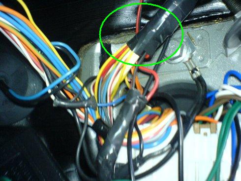

here are some pictures of fuse box.
any idea where i need to connect two cables from central locking to my security alarm?

this is a bit old an old one huh., if you find the little led warning light thats inside the car to tell you that the alarm is on, trace the wire from it back and it will lead to the alarm.,
the alarm system might have a central locking function so if it does it will have 2 wires that give a negative signal, one when the button is pressed for open and the other for when the button is presses for closing., you have to wire them into the CL wires in the footplate that you posted the pic of., i cant give you wire colours because it looks like you have an aftermarket CL kit installed so i wouldnt know., you'll have to test it to find out., do this by getting a piece of wire and connecting one end of it to the chassis of the car so that its getting a negative signal and with the other end, touch it on the wires that are going to the CL kit one at a time and when you get the right wire the locks will go either up or down., dont hold the wire on the wrong ones too long incase it blows any fuses, just touch it quicky to see if the locks move.,(y) .,

thank you very much i'll find alarm over this weekend, (was busy in buying home) and take some snaps and post here, and wires colour from centeral locing one is white and other is brown.

most alarms will work the central locking directly using 2 wires. some alarms can not work central locking at all. some alarms require a seperate add-on to control the central locking. we dont know what alarm you have so we cant be sure which case is true for you.
if you can tell me the make and model number of your alarm, i can try to find a wiring diagram for it to see if it can operate the central locking, and if it can, which wires need to be used.
the most likely option is that there will be 2 wires on the alarm controller that need to be connected to your white and brown wires on your central locking controller.
