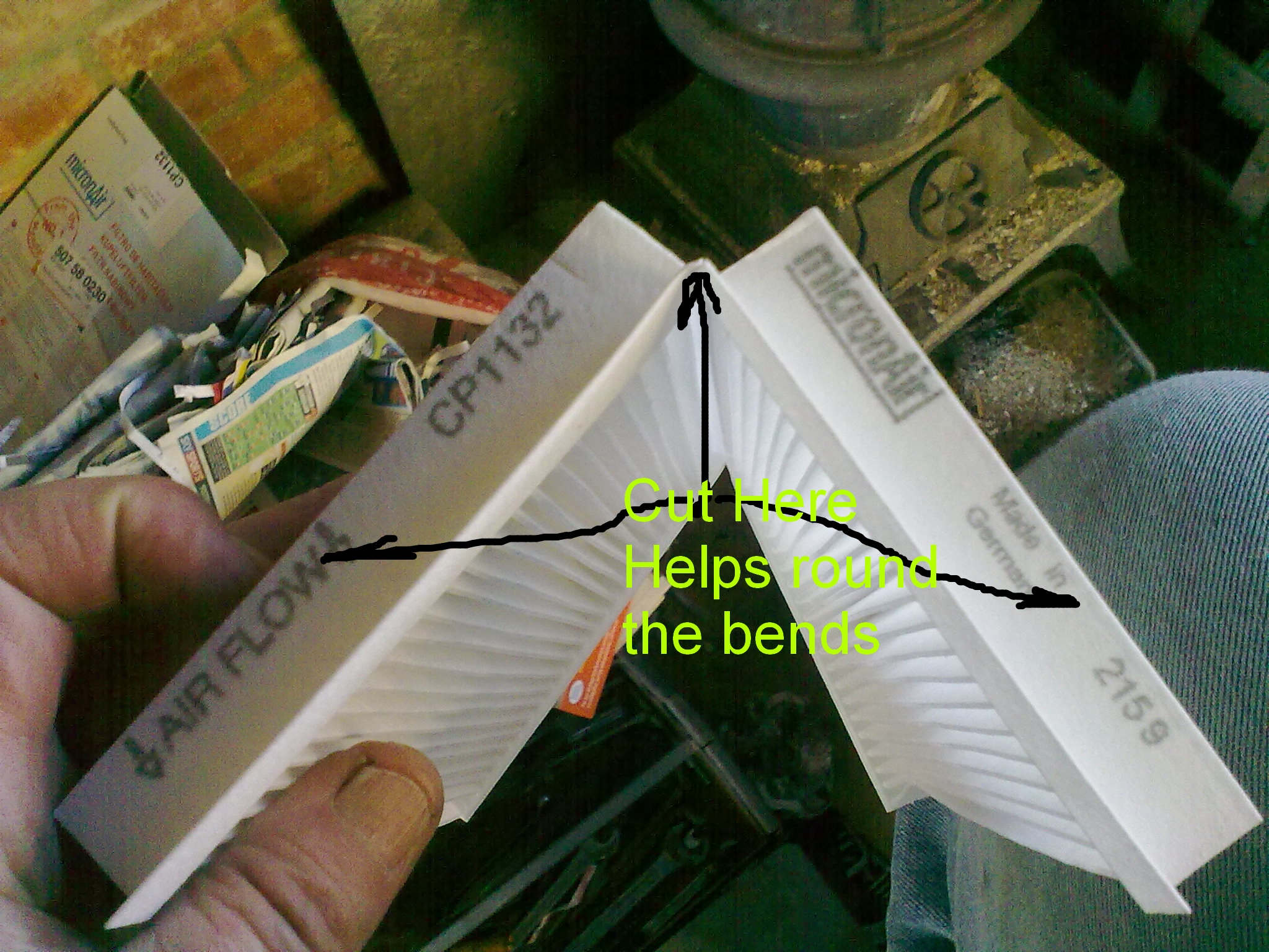

With a left side steering it's much more easy to reach this hidden filter... :D
It helps if you put a few cuts in the filter like the pic so it will make a curve.
