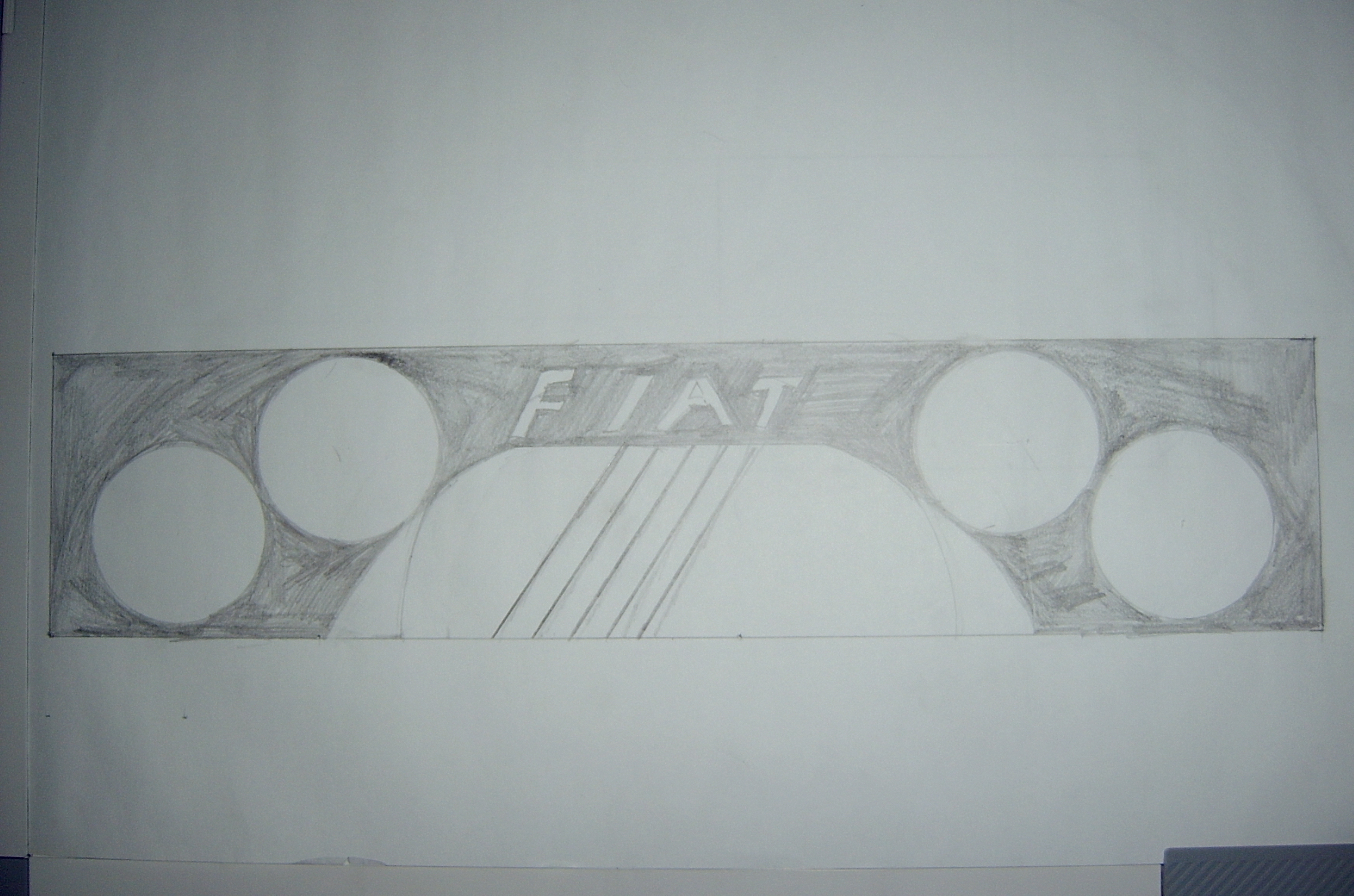

Got my fav idea on paper now... looks different to how i imagined it to be though.. looks like a big mouth and creepy eyes.
It's drawn to half scale... but it was a kinda guess with the circle diameters(2inch). Nor drawn to the exact mm each side be theres always time for improvements
The shaded bit will be were i have fibreglass. Though the F I A T logo at the top looks cool and the 5 chrome stips too.
Will have a go at making one on the computer later tonight. just not sure on colour.... black or green colour coded.... Black will be considerably easier. Had to take a pic on camera as it's to long to fit on out A4 scanner

I'm going to proto type using cardboard first jon just to be sure i like the style.
It's reminding me a an evo 10/focus rs front with the angled outward edges a abit. Like it's ready to eat up the road.... i wish!!

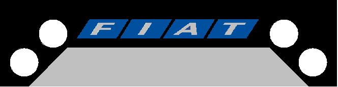

EDIT: quick mock up on paint of all things and it looks very flat lol. wi'll have a go at a full size cardboard one tomorrow evening. Need to find some 4 inch spot lamps now... any ideas?
Pic below
