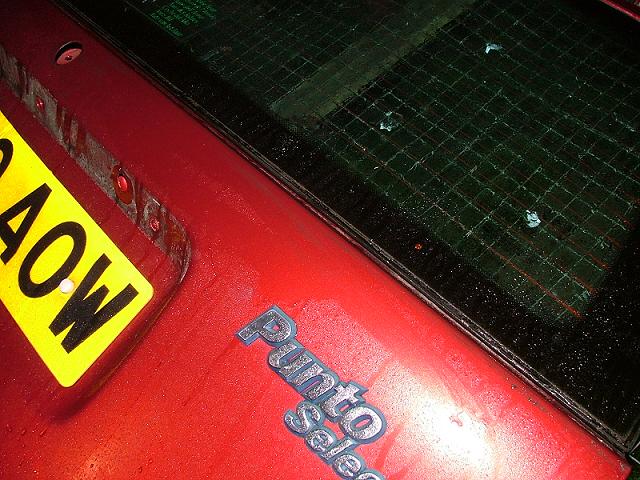

you cant use knife it just gets stuck, i went to borrow ;) some cheese wire from auto glass but there were no fitters there and its all kept on there vans :( will get some monday. how ever you might get away with just removing the trim because once removed there is quite a big gap, but i am not to sure how easy it will be to put trim back, if you do remove it pull off all for corners first, some picks below to show the gap,

thanks for the replies guys, not sure if i want to remove the trim tho then not be able to get it back on, dont want to leave the rust either........dilema :(
