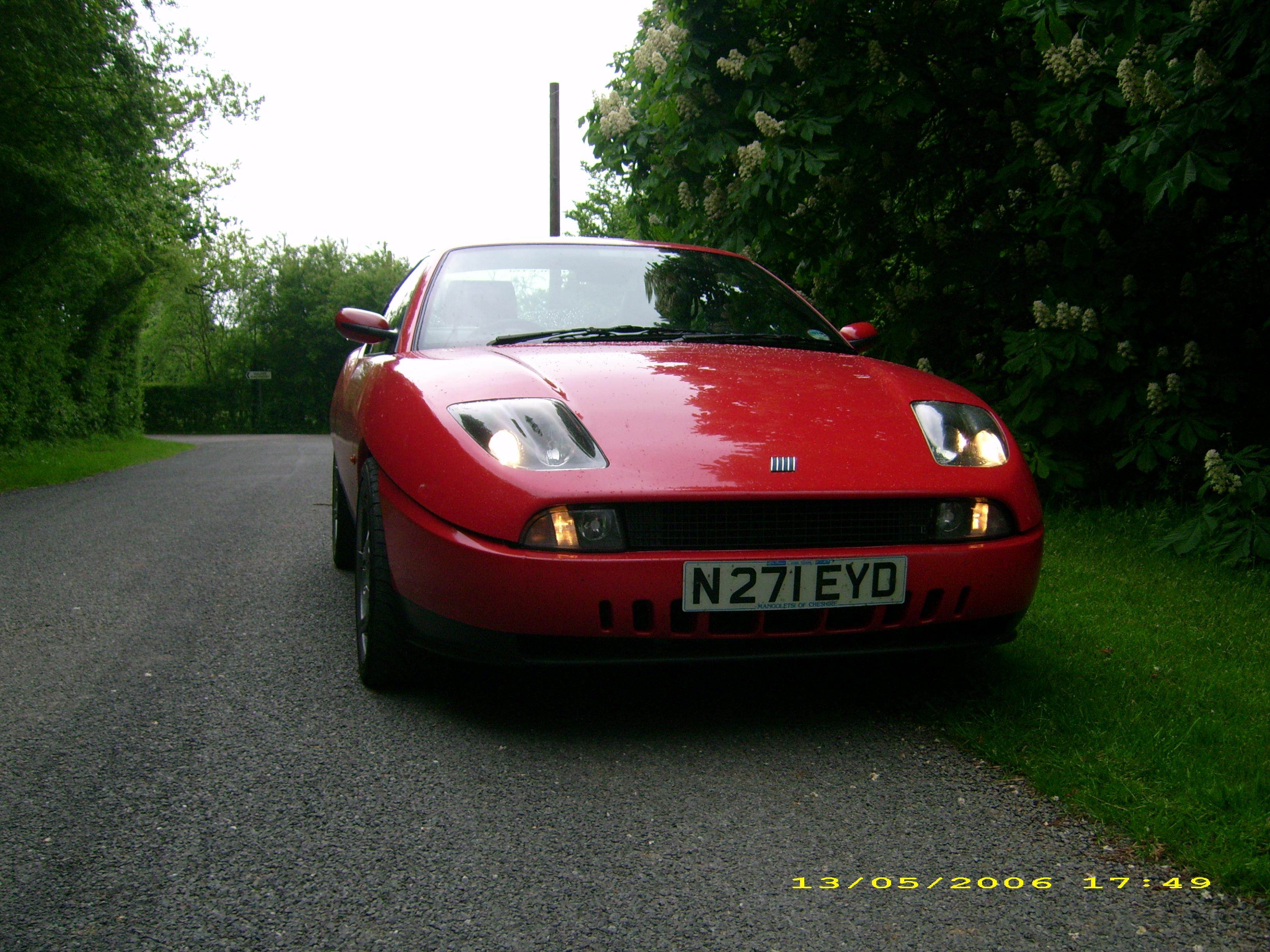

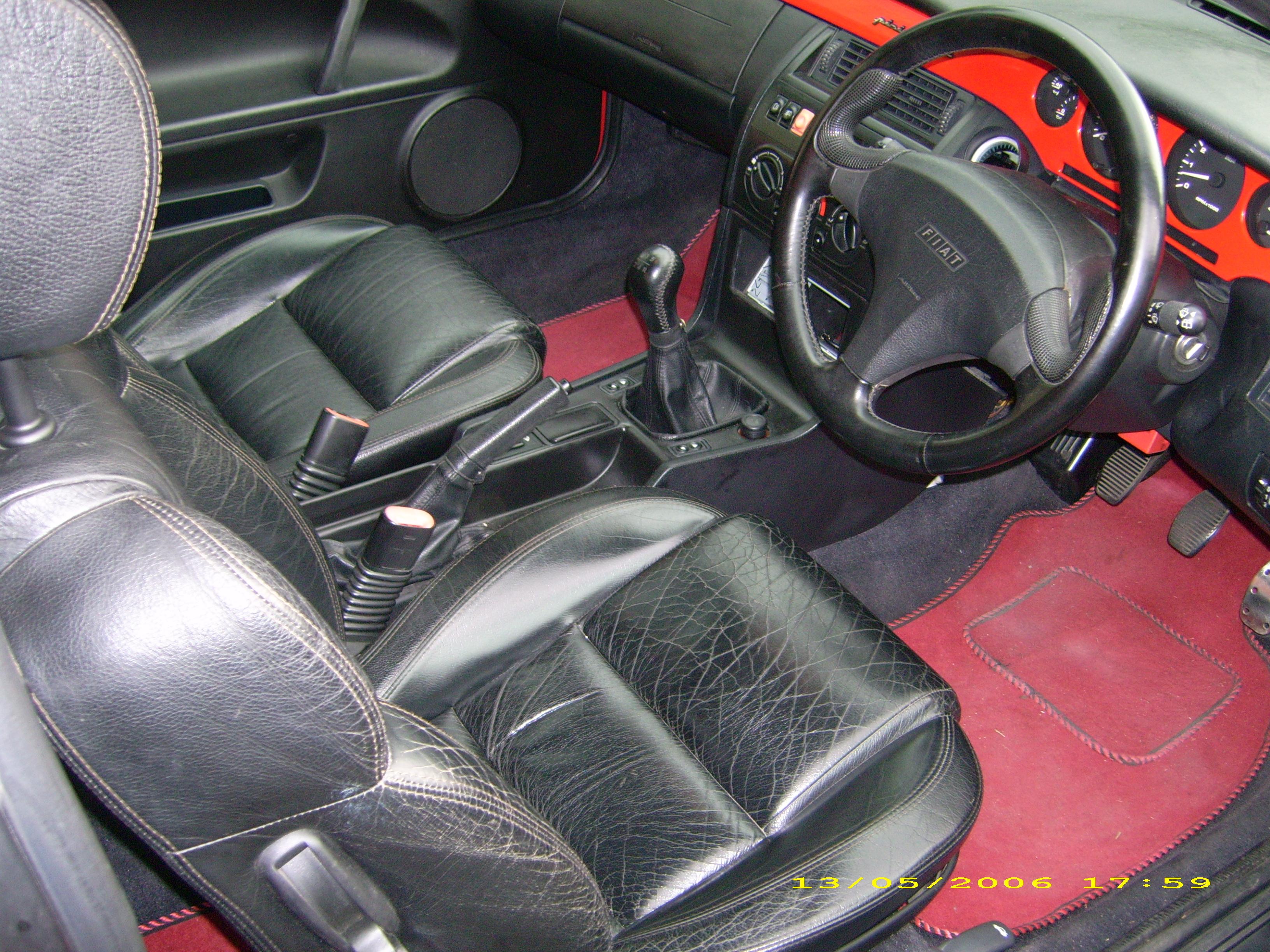

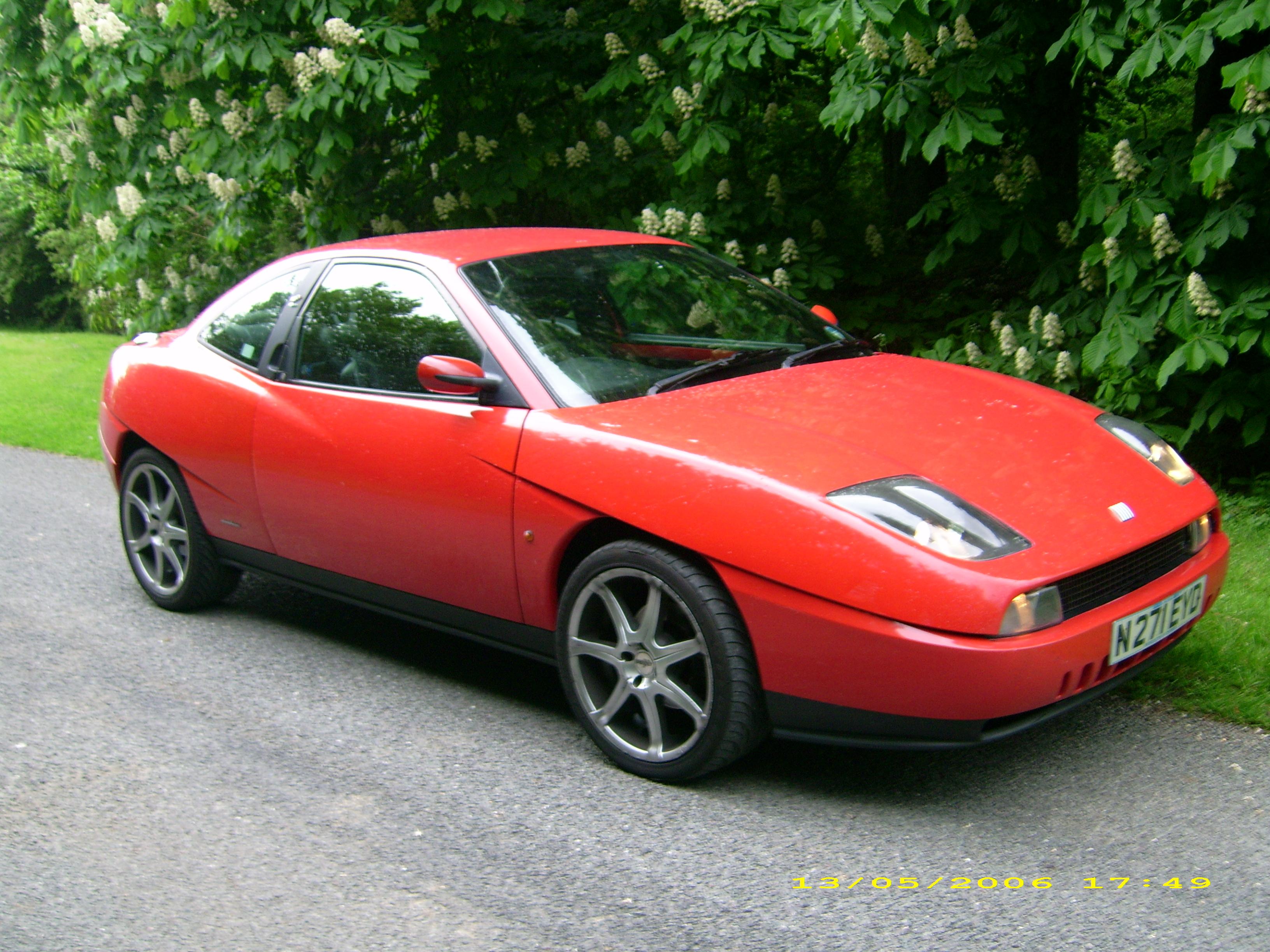

Here are some pics I took earlier. I have found some other info on Fccuk, and I need 215/35 18 tyres, and without spacers I should be ok... I am really pleased with the car, the radiator is hardly leaking, it is quite new but there is a white stain on the matrix.. maybe it was not a very good quality one. The leather looks better for real than in the pics, it seems the flash has shown up all the cracks..
