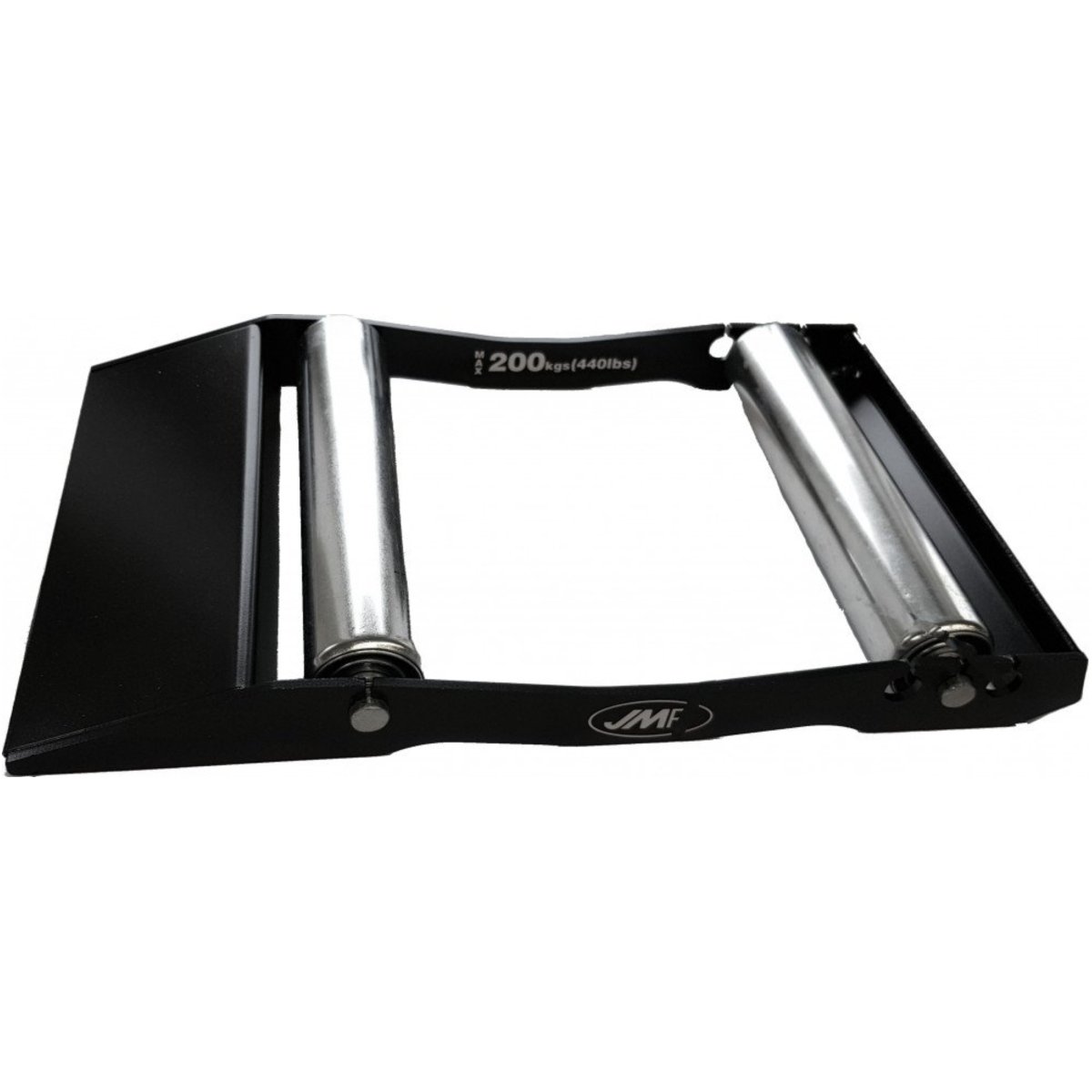

a couple of ‘wheel spinners’ (one under each front wheel) at £55 the pair would be able to test that the 4x4 does actually work, but I can only find one company selling these (for large+heavy motorcycles) and they are individually rated at 200kg max weight (would 400kg be enough for the front of a Panda 4x4?)
That's a fun thought. If the front wheels spin, the rear wheel should automatically join the party, catapulting the car off the spinners. Best not be facing a wall, or cliff, or swimming pool, etc.
Followed by, "Used wheel spinners for sale. Great condition, used only once."
in the absence of a nice patch of snow/ice, or a handy muddy field, two “wheel spinners” are the only way to prove the 4x4 system (and also the ELD) actually work
