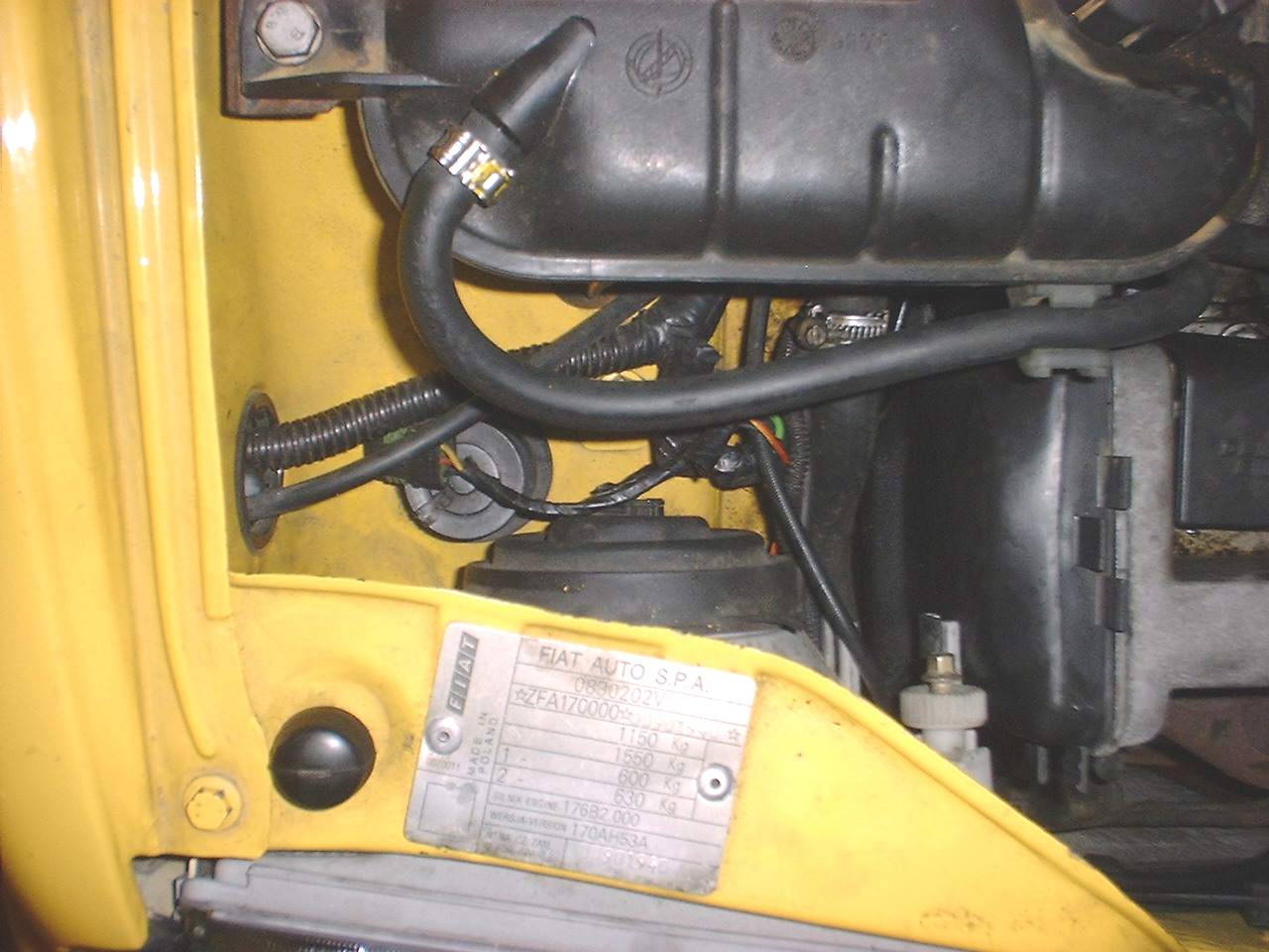

the only hole I can see behind the headlight is in the inner wing, the window squirter hose and electrics goes through it
only other hoses from my header tank, is the one at the bottom which goes direct to lower hose on rad from the water rail end. and the smaller tube that goes from top of header tank to under the air filter housing / spi area
couple of pics
Looks like the end's been stuffed uder the expansion bottle
I had the bottle out to do my water pump, there was definatly no other pipes there
the pipe you can see with jubilee clip did have its original fiat clip, before I removed it, suggestign that no work has ever been doen in that area before [or tank removal, at least]

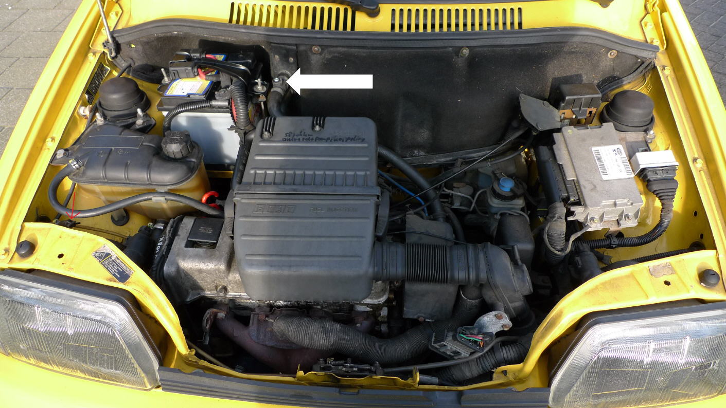

Is this one of the bleed screws? ( I placed an red arrow)
Should it be opend while the engine is running or while the engine is stopped?
