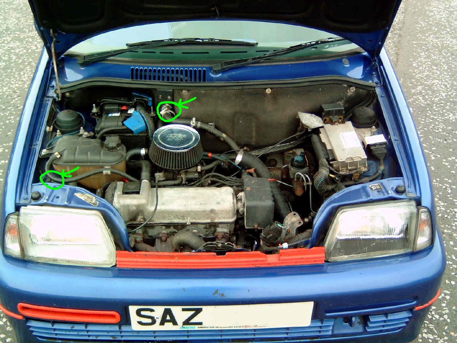

Here is the points, behind the headlight there is a hole in the wing, there should be a pipe there with a plastic screw which you can unscrew. It may have been tampered with previously and is now lying behind the bumper out of sight.
Liam
This might be a Cinq/Sei difference. On mine there's a length of small bore rubber hose coming out from behind the sound proofing, the same as you see behind the headlight. The problem is the top of this hose looks to be significantly higher than the Cinq bleed screw shown in Liam's picture.
