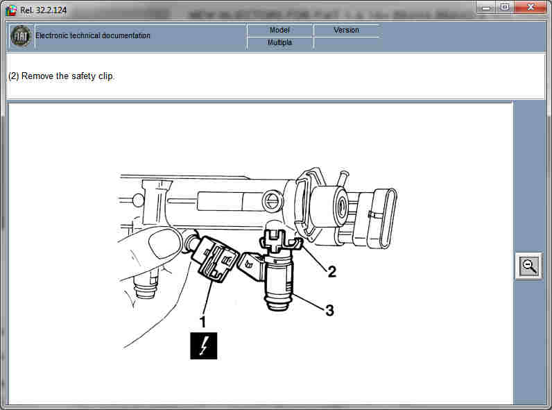

ii cant find any thing on the forum to help me with this the tittle says it all ive tryed yanking them tryed a flat head with no joy any ideas welcome this car is a 1.6 sx 100hp
Attached pic from the service CD.
It's a long time since I did it, but there looks to be a latch to remove before the injector will come out.

tryed diagram took clips off and so on but it still wont budge and i dont really wanna have to smash it off where did u get a service disc ill purchese one and if its not to much bother could u tell me if it tells u another way or if it gets stuck or something my neibour rekons it could be a o ring thats inside
Ebay is the source for the CD, eg item number 380351195219.
The CD does not tell you what to do if the injector is stuck.

cheers momme i ended up buying injectors off a scrap car with the manifold so just swaped them over so now have 3 spare working injectors incase it happens again and a spare manifold thans for all ur help PIG and MOMME(y)
