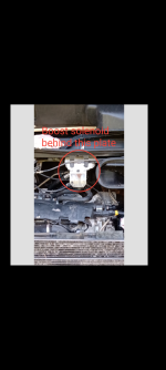

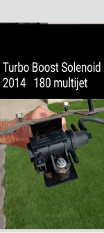

I think you may have an "apple".... And I have a "pear"?
It must have been moved due to the water ingress problem that affects these Ducato's.
It won't be to far away. It has a wiring connector & 2 hoses connected.
Photo of a 2014 but it is the same on 2008.

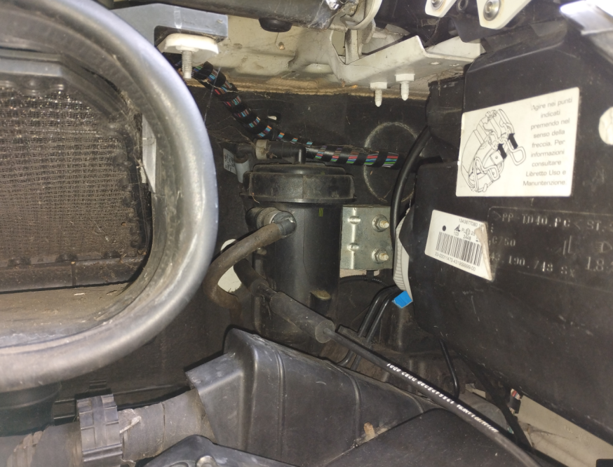

I think I've found it? Back right, against the bulkhead. Not so easy to get to...

As stated by @Kahcorp, the black cylinder is the fuel filter. My 2.8jtd has a similar/idetnical filter, but it is reffered to as a "green" filter. Requires special tool to hold it when changing filter elements.
If you can reach the connector on the filter and disconnect it, you should raise an alarm as the ECU will not be able to read fuel temperature.
However I suggest that you follow @Kahcorp 's advice and familiarise your self with the various components. Little use in diagnosing a fault, if you do not know appearance and location of faulty component.
