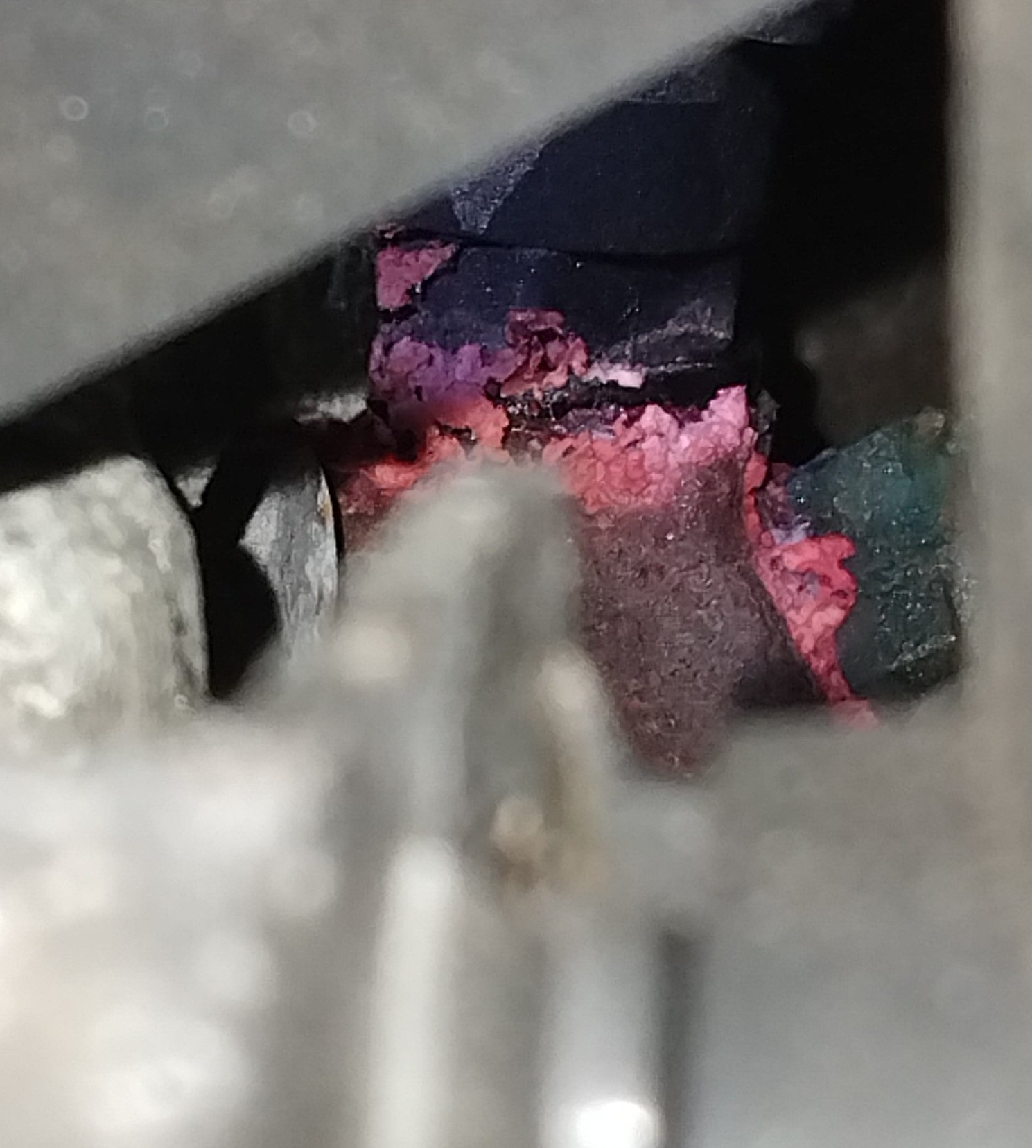

Hi, new here, I have a fiat lounge, recently while driving with the window wide open, I've felt wafts of heat, I thought it was the brakes as I knew they needed changing, got them changed, still I could feel heat, so looked under the bonnet, no warning lights came on the dash to say overheating, I noticed some pink staining on the engine. I have had to top the coolant up a couple of times recently, but thought it could be due to hot weather. Should I be concerned?
I noticed some pink staining on the engine. I have had to top the coolant up a couple of times recently.
Well you've almost certainly got a leak then , haven't you ;)
Got a photo?.... or what area were the stains?
How much did you have to top up ?
recently while driving with the window wide open, I've felt wafts of heat, still I could feel heat
Is it more you could smell coolant and steam perhaps ?

Can quite work out which part this is, but there's a big split/crack in it surely?
How much have you been topping up?
I've not been topping up much, say 2 litres in 2 months, but I'm scared to drive it now, so am trying to contact a fiat garage. They're not answering the phone yet. The photos are the best I could do as it's not at the top of the engine

That's a typical picture of a coolant leak. The water evaporates leaving the crystalline antifreeze deposits you see there. It looks like a leak where the hose joins the engine and, if so, is the sort of thing almost any competent workshop will be able to repair especially if your engine is the 1.2 litre 4 cylinder FIRE engine. Probably best to get it sorted soon though as, although very robust and long lived if maintained well, they are prone to blowing head gaskets if they overheat - which will happen if coolant level is allowed to drop too much. Topping up, as you are wisely doing, will avoid this as long as the leak doesn't get more serious. So it needs sorted quickly.
If the leak involves the water pump you are better to get a Fiat specialist to do it as it will involve disturbing the timing belt - again I'm talking about the 4 cylinder engine here, not the 2 cylinder twin air which is an engine I'm not familiar with. If it needs the water pump done you're as well to get them to do a new cambelt at the same time as most of the labour involved is the same for both tasks.
You dont say what engine you have and how old the car is so assuming its a 1.2 engine do the following check.
Find the outlet pipe from the thermostat to the heater matrix -hold the hose at the thermostat end and wiggle /push pull on it!.
On the original fitment unit the pipe is PLASTIC and heat cycling and age causes it to fracture! can be a hairline crack but eventually it fails catastrophically if yours breaks off in your hand then think yourself lucky it didn't fail whilst you were driving ! replace it with an aftermarket one with a METAL pipe its a permanent fix! bleed the system carefully, and all should be well.
If you find the pipe and fixing to be sound then i would recommend having the system pressure tested to trace the source of the leak!.
