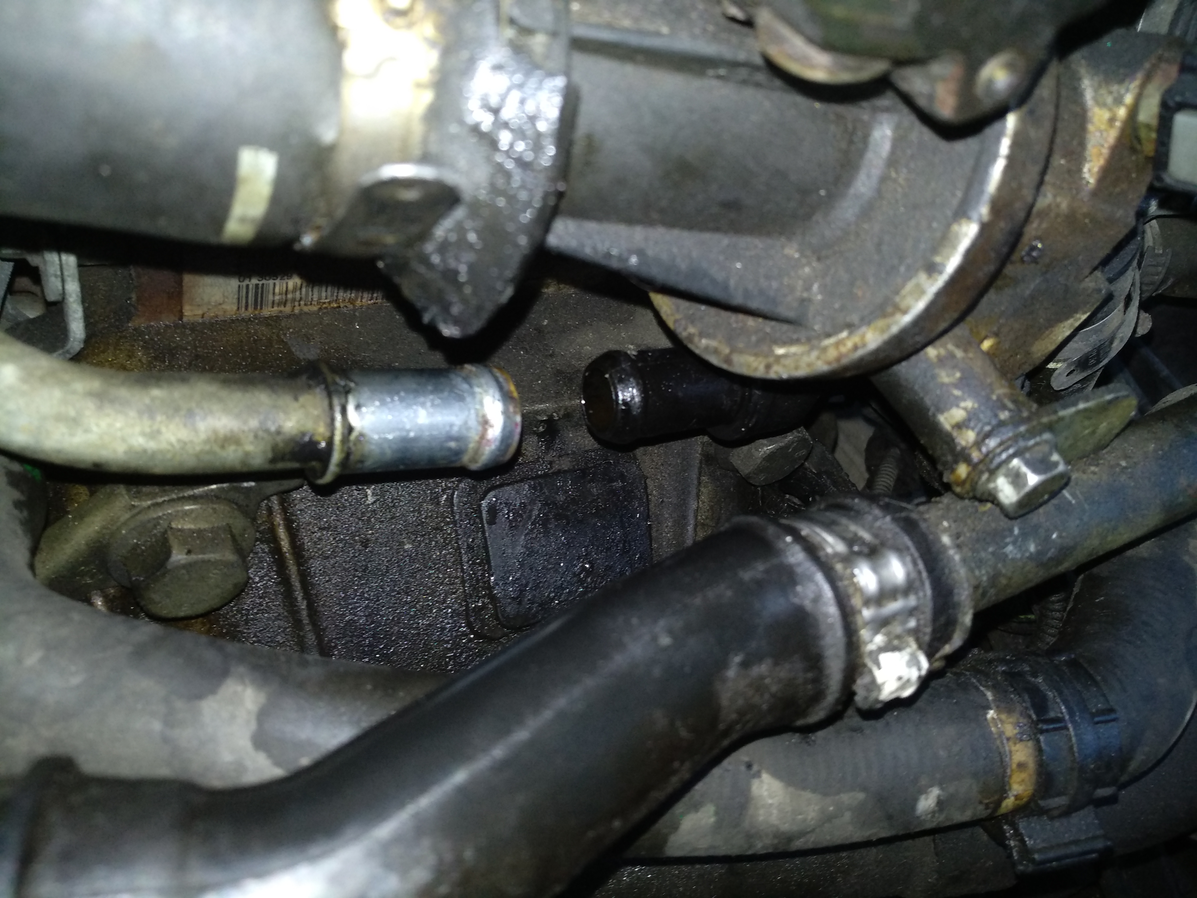

Good evening everyone,
Mk2b 1.3 MJD owner here;

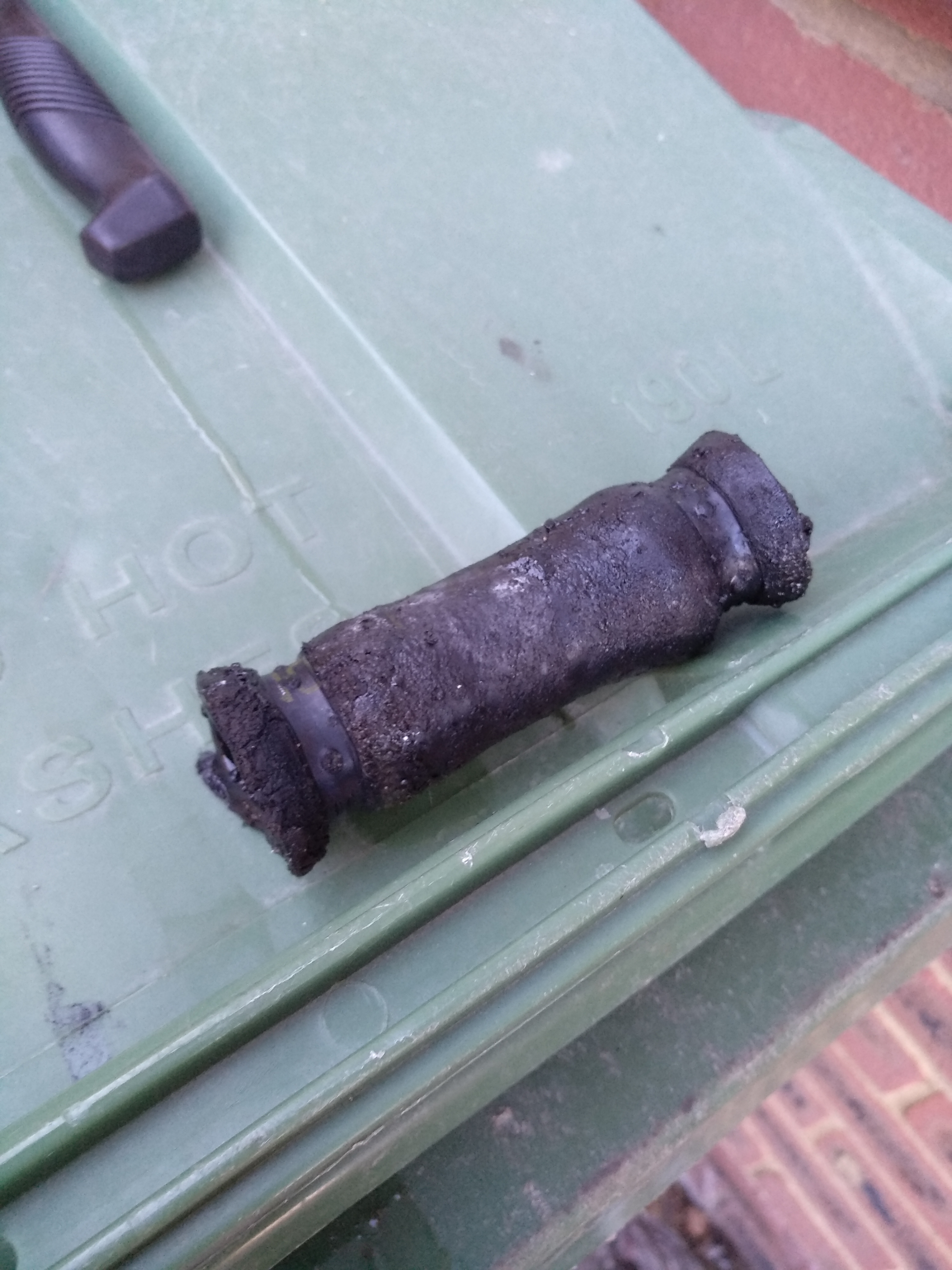

I have noticed dripping from under the engine bay and when followed to its source I have identified it to be the rubber hose that connects the metal coolant piping to the plastic thermostat input(or output idk)(Please see attached images for what I am talking about). The hose is perished/cracked and is leaking coolant.
I have ordered this replacement hose: https://www.ebay.co.uk/itm/FIAT-PUNTO-188-1-3D-Radiator-Hose-03-to-12-188A9-000-Coolant-Gates-55209535-New/333602708205?fits=Car+Make%3AFiat%7CModel%3APunto%7CPlat_Gen%3A188_&epid=21030228614&hash=item4dac455aed:g:1vYAAOSw6iJew8uX#vi-ilComp

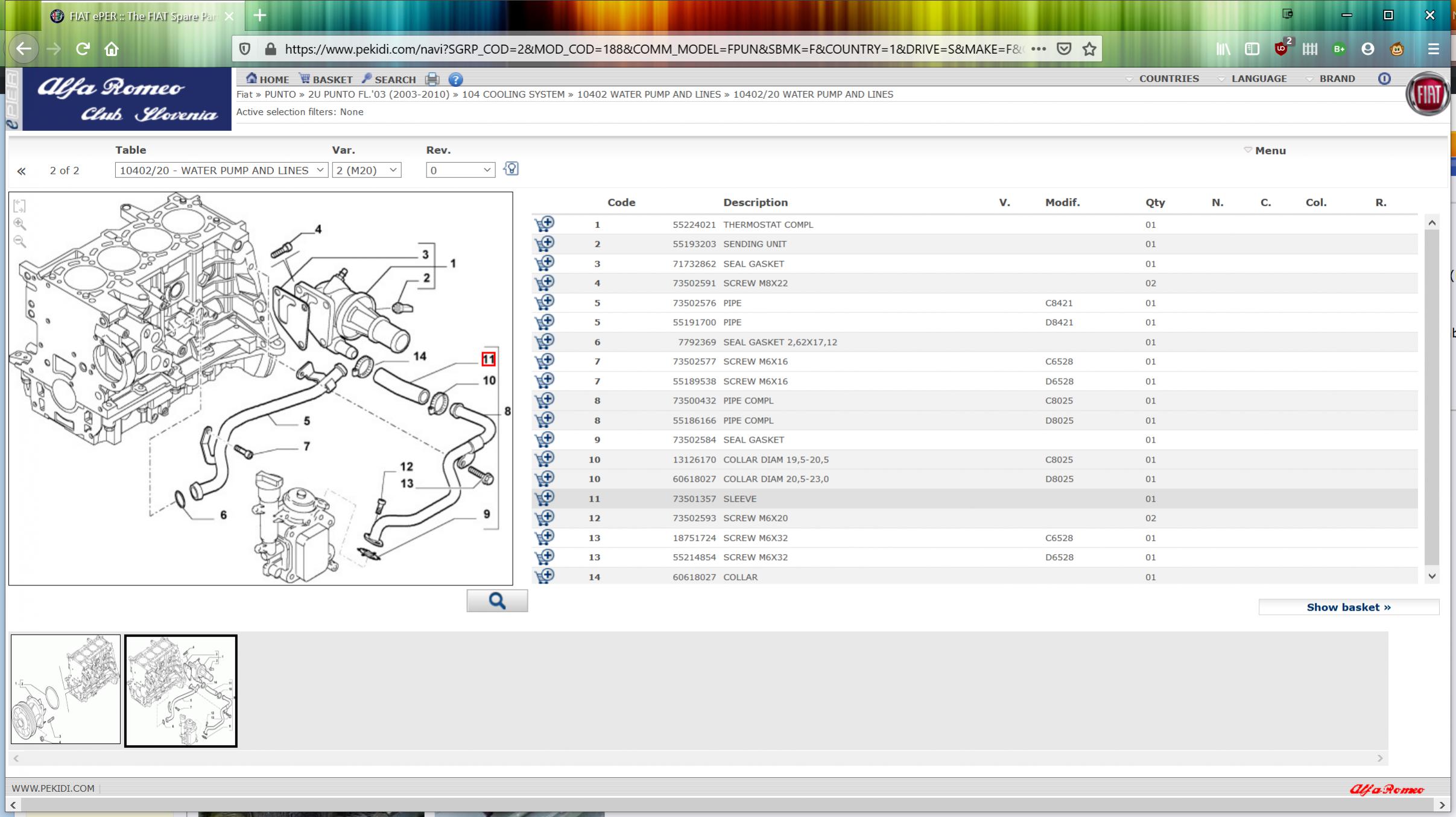

Could any of the guru's on this forum help me understand if I've purchased the correct replacement part? I can't locate the part number for my vehicle model, the website below shows a diagram and part number for the Grande Punto but none for the classic Punto's https://www.99rpm.com/fiat/hoses-thermostat-water-pump-1-3-mjd-punto.html.
Any tips/experience surrounding this issue(as well as re-filling the coolant once the hose is fixed) would also be much appreciated :)

Here is a link to the part you need
https://www.ebay.co.uk/itm/FIAT-PUN...9-000-Coolant-Gates-55209535-New/333602708205
This part on this link is a genuine GATES branded item. It has the required 15 mm bore and 75 mm length. To fit WD40 both ends of where it fits on for lubrication. Bend the new hose in the middle and then slide onto the plastic thermostat tube first. Then force the front onto the metal pipe and slowly ease it on. Dont forget to slide two jubilee clips onto the metal pipe first before fitting it. Then just gently nip them up to prevent leaks.
I changed the coolant on my 1.3 classic punto and no bleeding was needed, actually I don’t remember their being any bleed screws and it has ap era different pipe work, radiator and coolant reservoir to other petrol models of punto so it is a bit different.

Today, 28th November 2024 on 130,000 miles it was discovered that the replacement hose from JUNE 2020 had a pin prick hole in it, when engine was hot or revved it would push all coolant out. Ordered another GATES OEM hose but needed car urgently today so went to HALFRAUDS and purchased a 1 metre length of 16mm radiator hose , cut it to correct length of use with my DREMMEL and replaced again. All good again.
