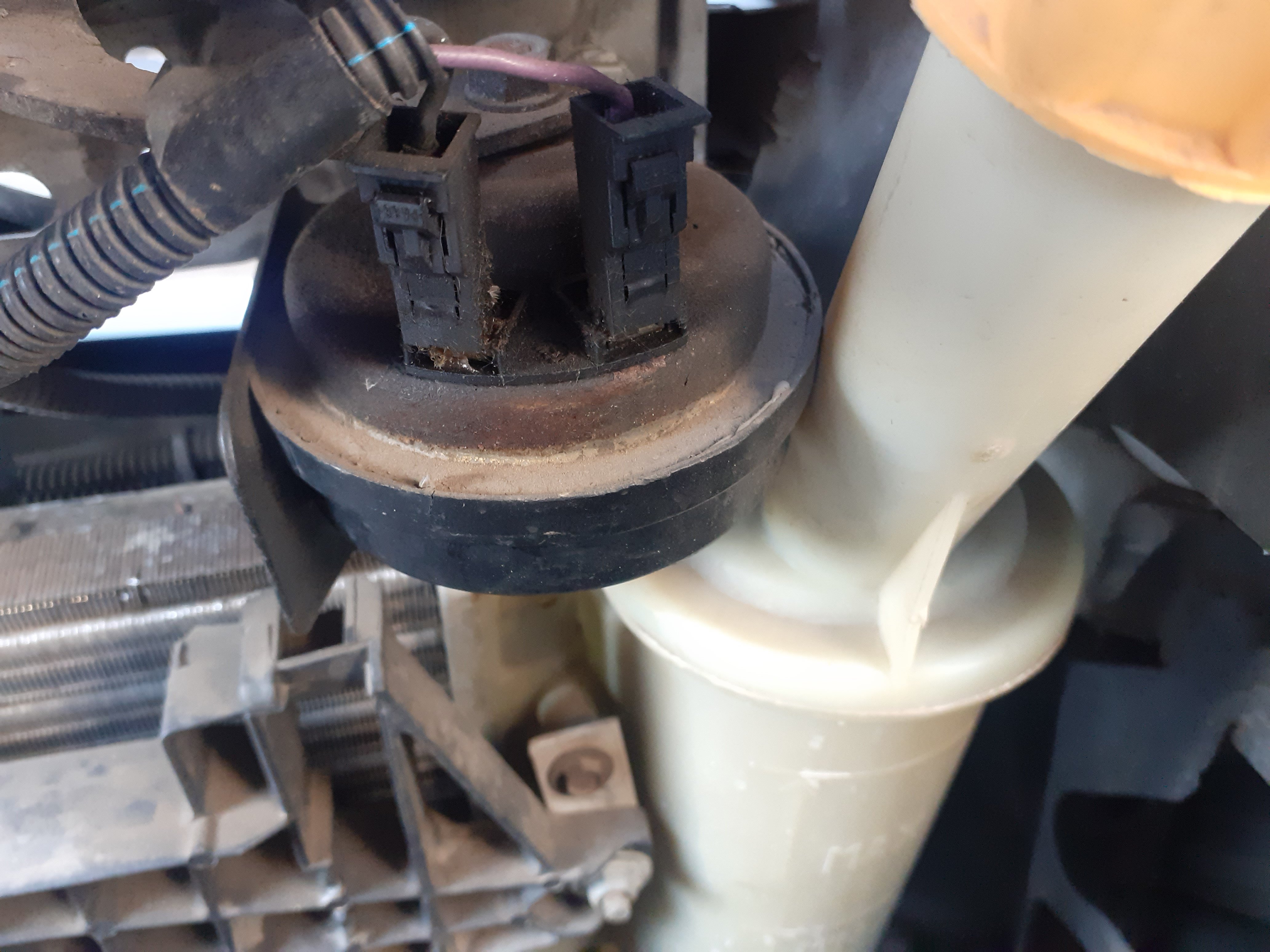

It could be just a coincidence that horn doesn't work after working on steering column. I had a problem with my horn and it was due to oxidized contacts of the horn and cables that connects to it. Cleaned those and the problem came back in a short time. Cleaned those again, problem back again shortly. Then, after cleaning them again I've put grease onto them, just regular, not special eletronical grease and it works fine since. It's more than 2 years ago.
For your problem take the cables out of the horn and connect a multimeter to them, see if there is voltage when someone pushes the horn. You can measure without taking the cables out, but, doing that myself, I can tell you that I got a really good scare, so I don't recommend, because I was looking very intrested at the multimeter screen and by pushing onto horn's contacts, made them connect and it worked.
