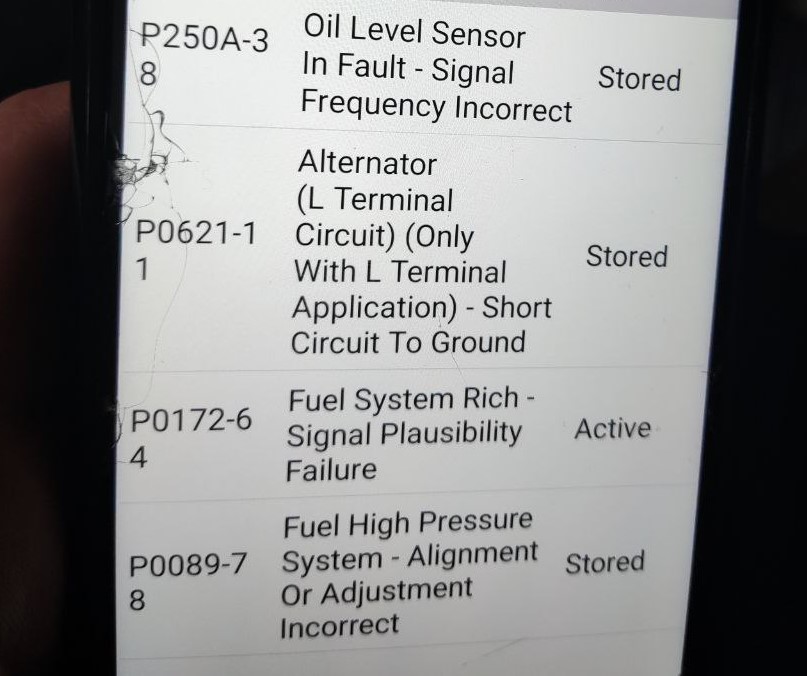

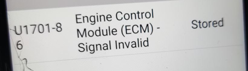

Today I have done another diagnostic (get another "jumps" and another "ESP check" in my trip today). This fault code named "Stored", I clean it, and next engine start runs perfect. Now I have not any faults on display or in OBD Scanner.
Tomorrow, or next week, when I will go for distance 50+ km, I will got again this lights and problem. But after I turn off the engine and turn on, faults will disappear.

With that variety of error codes it may be an idea to check all ECU earthing points and other connections are in good order as a starting point.
