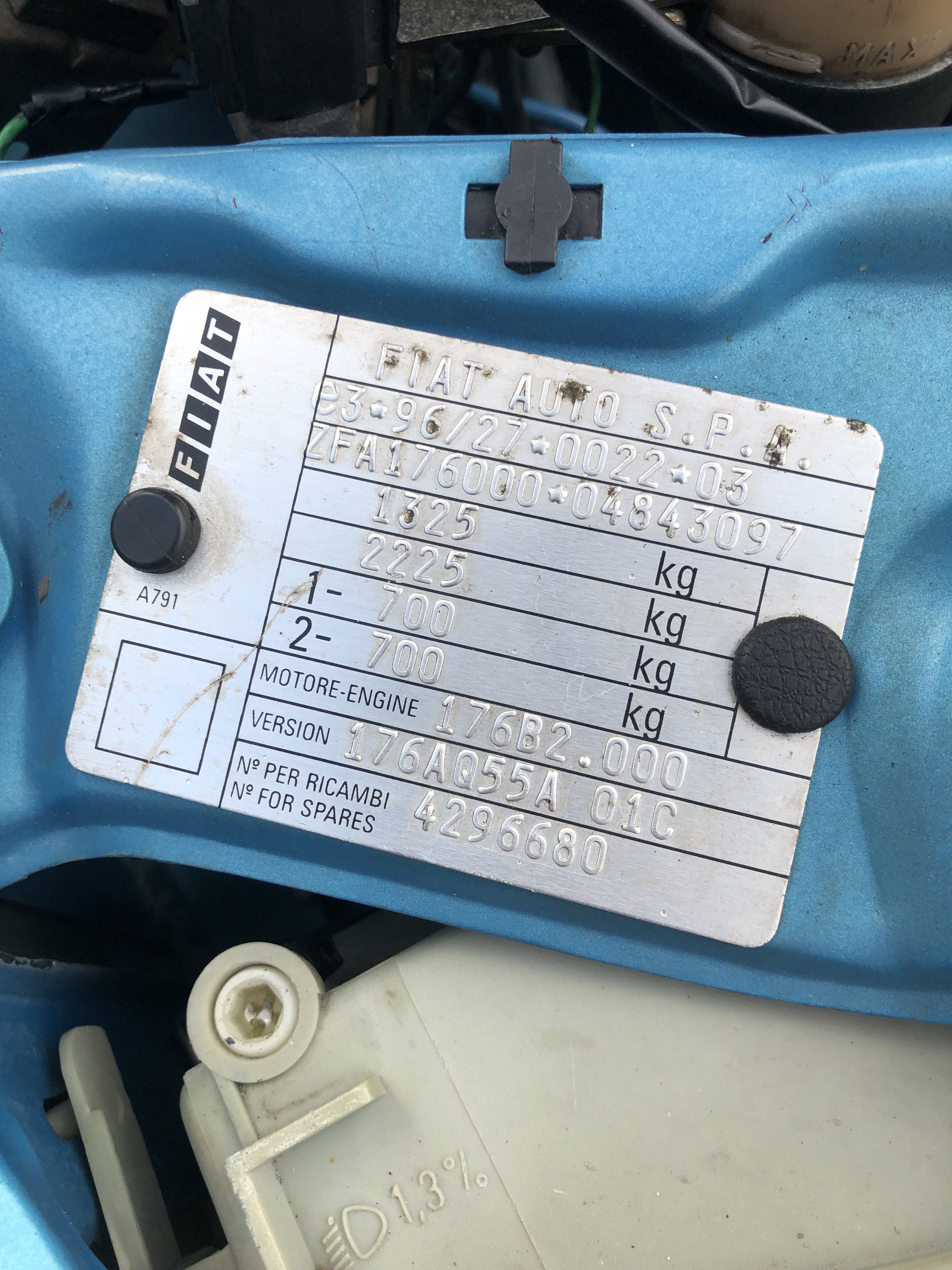

Have you got an engine code to see if my Auto Data has a listing.
No Sorry :(. My book doesn't go back that far. The 1108 cc as you can see is a different engine code altogether and the nearest is the 178B2.000 is the 1.4 engine.
