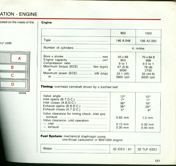

I would only add two questions:
- I seem to recall that the FIRE engine has negative valve overlap, which would mean there is a period of time when both the inlet and exhaust valves are closed. This is very different to other FIAT engines and particularly FIAT engines from the 70's. Therefore I wonder whether the comment about 'too much scavenging' still applies.
- Japanese horsepower is not directly comparable to European horsepower because they measure it in a 'gross' rather than 'net' fashion (i.e. without water pump, alternator, and even without the exhaust fitted). So I'm not convinced that a Suzuki Swift engine really has more power. And, you need to consider the torque as well.
As for economy, the Japanese make a lot of cars that are very thirsty for the performance they achieve. Examples that spring to mind are my 1990 Toyota Celica (the only Japanese car I've owned) and the '90s Subaru Legacy/Impreza with the flat-four engines - heck, even the 3.3L flat-six of the SVX had an amazing thirst, far more than my Alfa's V6.
-Alex
--the FIRE engine has negative valve overlap, which would mean there is a period of time when both the inlet and exhaust valves are closed.--
--Japanese horsepower is not directly comparable to European horsepower because they measure it in a 'gross' rather than 'net' fashion--
--And, you need to consider the torque as well.--
--the Japanese make a lot of cars that are very thirsty for the performance they achieve.--
--1990 Toyota Celica - and the '90s Subaru Legacy/Impreza--
Interesting points Alex.
re- 'the FIRE engine has negative valve overlap''
Umm , don't know where you heard that from.
In the 999 engine the figures 1 degrees BTDC and 9 degrees ATDC add up to 10 degrees worth of overlap.
In the 1108 engine the figures 2 degrees BTDC and 2 degrees ATDC add up to 4 degrees worth of overlap- not much but its still overlap , and definitely not negative overlap.
Negative overlap is actually a misleading term.
You can get less and less overlap but your cant get less than NO overlap.
At the point of NO overlap , there is no more overlap to get less of.
It is possible to have a period of no overlap - but the term negative overlap isn't technically correct for this cam timing event.
So far all that I have seen of this is some research done by Jaguar and Yamaha in 2006.
It can only feasibly be applied to variable cam timing engines that are also MP-EFI and have full engine management.
It is something that I believe is still in early devolopement stages and not found in any production cars.
However it is possible for variable cam timing cars to reduce the cam timing so dramatically that overlap is essentially zero.
This is in an effort control emissions , and not increase power.
I have two possibilities of what you may have thought as being negative duration when applied to FIRE engine.
One possibility is the way that cam durations are sometimes written.
Take the 999 example again.. It can be written as...
1 BTDC , 19 ATDC , 29 BBDC , 9 ATDC.
or
-1,19,-29,9 - or something like that.
Seeing the negative marks leads people to think of negative duration , but its not.
It is just indicating 'before dead center'.
Another possibility of confusion is cam timing offset.
To occasionally meet emission standards on some gases (might be Nox) on an engine which has no air pump or EGR , manufacturers can retard a camshaft by up to about 6 degrees , and drop these emission test figures.
If you start of with a small cam that the intake opens at 1 degree BTDC then retard the whole cam by 5 or six degrees you will see that the inlet opens well after TDC.
In some peoples explanation this might look like negative overlap duration but it isn't.
The cam still has full overlap duration but the time that it has started at has been delayed more in the cycle.
Thanks, but see the attached pic of the mk1 Uno handbook.
Note that it's not 9 degrees ATDC, but -9 degrees ATDC. I wonder if your specs were wrong - the figure is so absurd that whoever transcribed it made the 'correction' of removing the negative sign? That means an 8 degree period where neither the inlet nor the exhaust valves are open.
OK - sorry, I see what you mean. My feeling was that if there was no overlap for 8 degrees, that was 'negative overlap' of 8 degrees, (i.e. a 'normal' 10 degrees overlap compared with an absurd -8 degrees overlap). I'm sure I'd read that term somewhere but will stand corrected.
