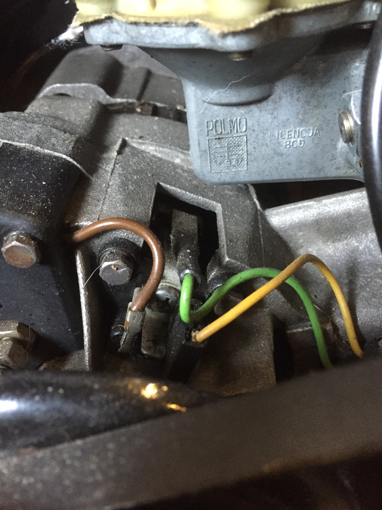

Hi I have just started for the first time in the car and the red charging dash light does
not go out.I have checked and it is charging (13.5 v ) It is a 650cc engine with alternator.I thought I had followed the instructions on this forum ,but obviously must have made a mistake. Any thoughts ?
Measure the voltage either side of the bulb to earth, they should be virtually the same i.e. 13.5v in your case. It suggests that one side is at 0v, if so you know will which side is causing the problem and can trace it back to its origin.
Tony
Has anyone an actual photo of an alternator wiring. (rather than a diagram ) I must have the warning light wire connected to the wrong terminal as it wont go out.When checking voltage at the alternator it is 12v from the dash light and 0v on the alternator an does not change when started.
If you have the same alternator as mine it's the spade connector in the middle below the green wire. Check it first though just to be safe and make sure it has 12v's on it. When converting from a Dynamo the original green wire to the warning light would have been terminated on the voltage regulator. So you need to extend that down to the alternator.
Hi,
I don't have a photo as it is my son who has the 500.Also the description below is generic as I don't know what Alternator/Regulator set up you have.
The ignition Warning Light (IWL) has two functions.
It provides an indication that the battery is not being charged fully by the alternator.
It also energises the field coils when you first turn the ignition on. One side of the field coil is earthed. When you turn on the ignition, battery voltage is fed to one side of the IWL. The other side passes through the field coil (which has a low resistance) to earth so the IWL lights up and the field coil is energised and produces a magnetic field.
When the motor fires up and spins the alternator it starts producing its own output (usually between 13.2 and 14.4 volts) and this then feeds the field coil so it is self energising. Because the alternator output is producing the same voltage as the battery the IWL goes out but at tickover the alternator may only throw out about 11 to 12v so the IWL usually flickers or produces a dim glow.
If the IWL is on all the time then either the other side of the IWL to the ignition switch side is connected to an earth, not the field coils or the output coils or output diodes are faulty so the alternator is not producing an output voltage.
Make sure the non ignition side of the IWL is connected to the IWL terminal on the alternator and not the -ve (earth) , F or B terminals.
Never disconnect the battery when the engine is running as the alternator can produce a high output voltage.
Hope the above is not too confusing
Richard
