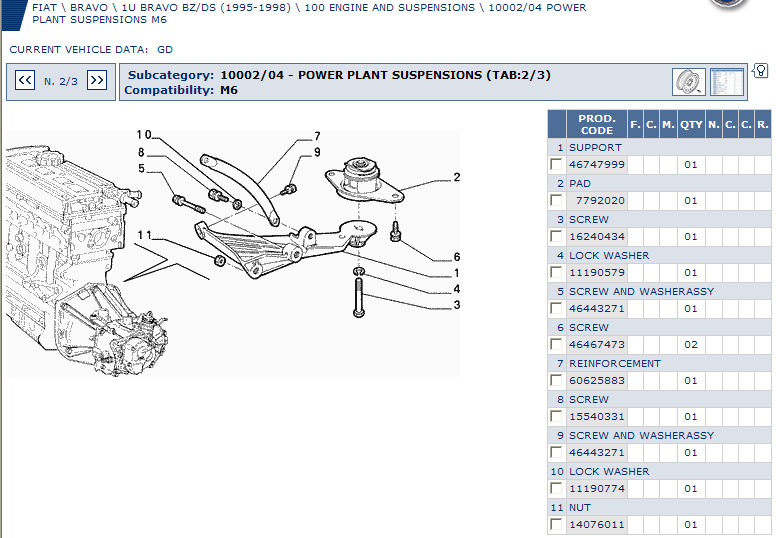

just checked on eper myself and there are what looks like one pad for the rear gearbox engine mount, yet when i proceed to my basket there are a couple of different part numbers and prices, just wondered if anyone knew which one it actually is for my 97 hgt

There is only one part number for every related part, from this diagram what part do you need exactly? I cant imagine fiat not being able to supply the part. If its not in the UK Fiat would be able to get it to the garage in 3days.
Let us know how you get on the part number is there.

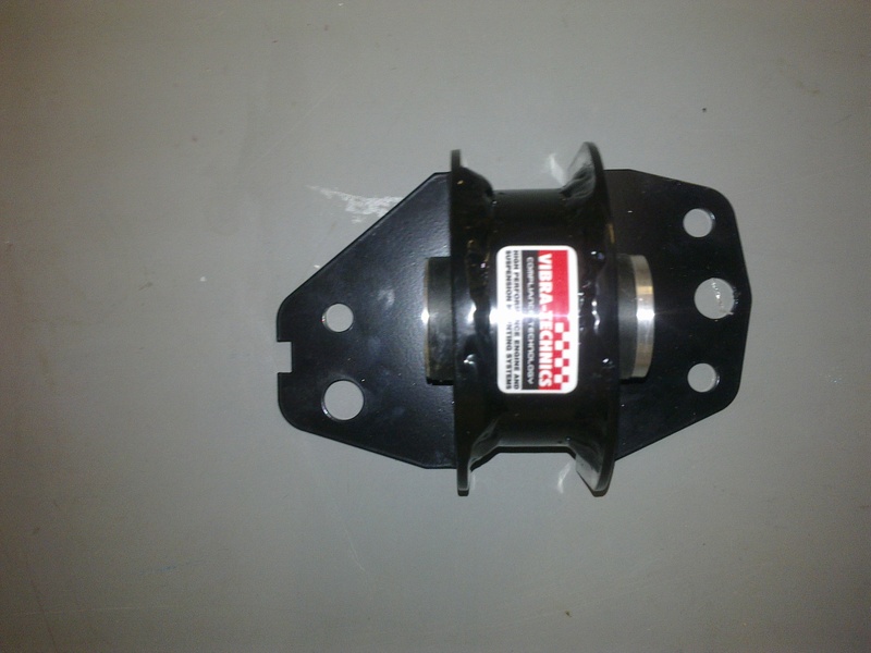

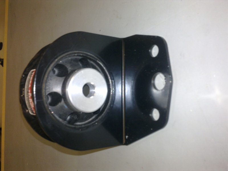

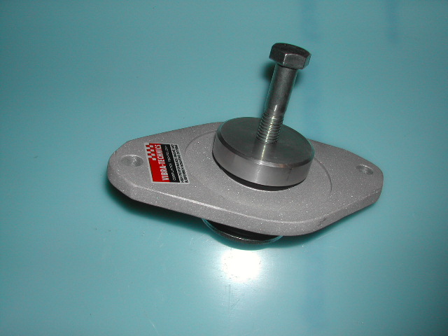

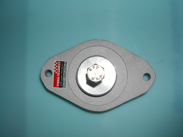

If it is of any interest a lad called turbojay on fccuk the coupe forum has sorted out an uprated mount kit (all 3) group buy. They are VIBRA-TECHNICS engine mount.
